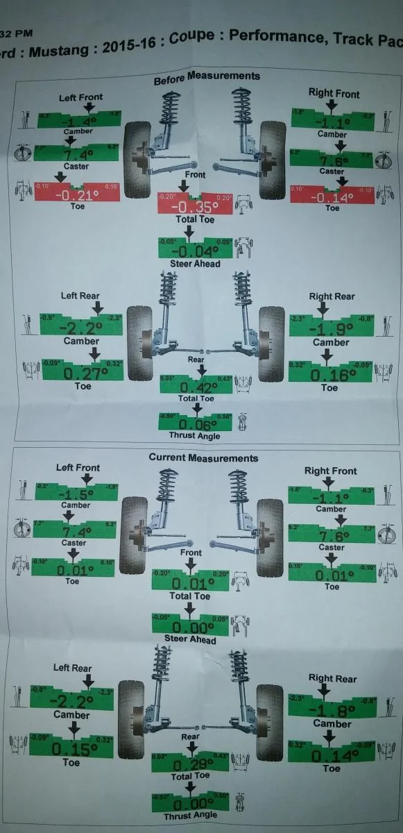

installed my cjpp spring last sat ran a week on them light driving to work and back .
had my buddy just do a alignment as i didnt want it to be to far out and cause problems.
think he used performance setting i dunno if this will fly on the street for spirited driving or not ..
any input would be appreciated

Everything looks good. The rear camper is a little more agressive than the stock setting but nothing wrong with it.

Ur toe needs to be Near O more man especially in rear too. U see my alignment sheet right?

front tow is 0.01 thought that was pretty close to 0 rear can use a bit ..ill have him go over it again if need be
