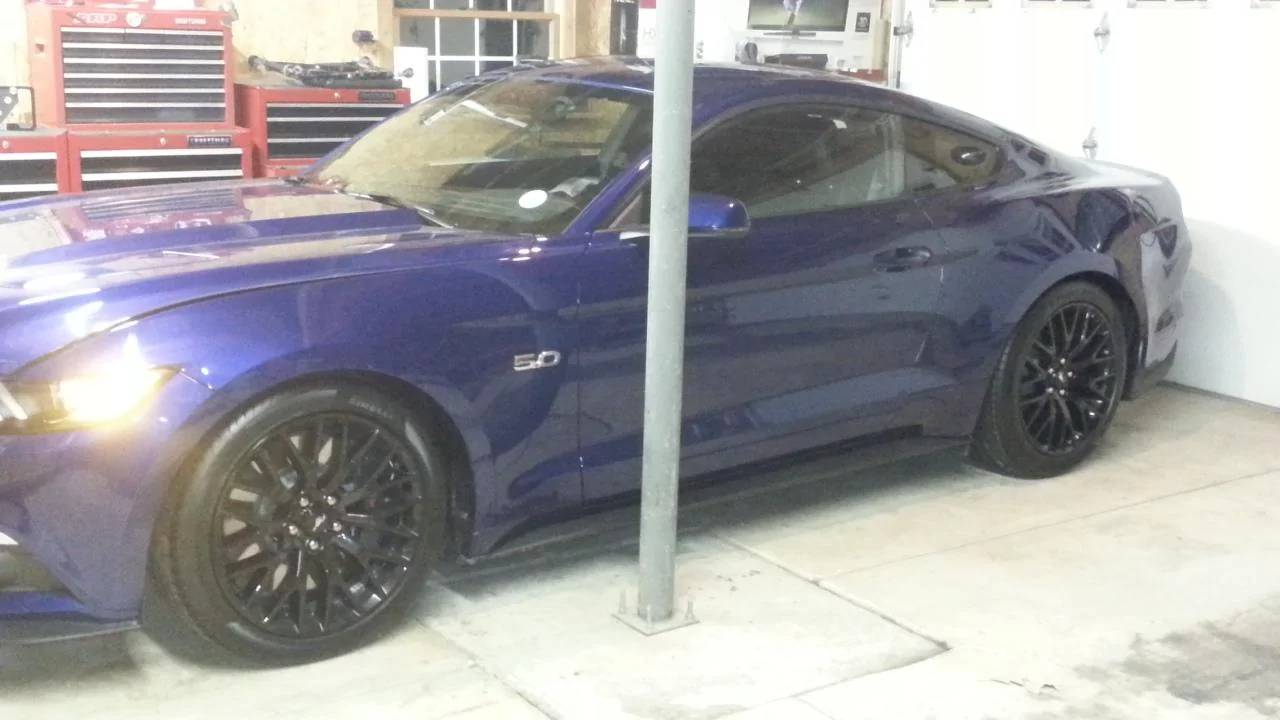

installed my cjpp spring last sat ran a week on them light driving to work and back .
had my buddy just do a alignment as i didnt want it to be to far out and cause problems.
think he used performance setting i dunno if this will fly on the street for spirited driving or not ..
any input would be appreciated
Looks like all he did was reset the toes.
Caster (up front) was fine to begin with.
But I'd like to have seen the left and right camber numbers on each axle brought closer together, and at least getting the right front number up closer to -1.5°. Maybe bring the left rear back closer to -1.8° if you're specifically trying to reduce understeer.
