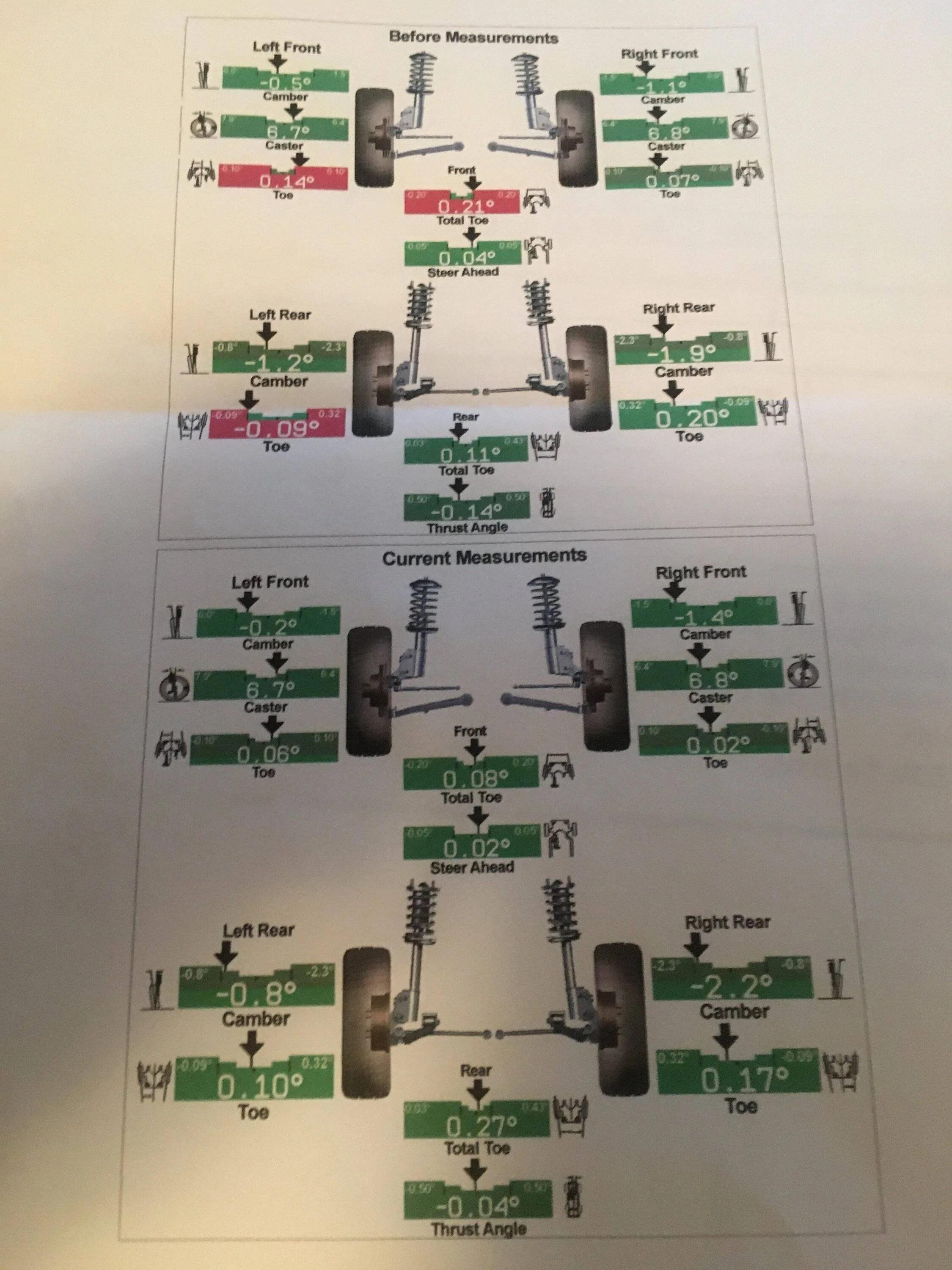

Here are my alignment settings from after I installed the Steeda stop the hop starter kit (bushing, lockouts and subframe braces) in my eco. I have 255/40/19 squared P zeros that came on the car from the factory, not sure if the wheels are 9 or 9.5 inches wide. No wear issues and car track great with no tramlining at all on grooved roads. Very happy with the settings.
Excellent!
Thanks for posting.
Is there a reason the left and right sides are different?
Or is it so miniscule that it doesn't matter?

The reason the camber is different from the right to left sides is a direct indication of how straight the chassis is from the factory in terms of upper strut mounting point locations since the camber is a non-adjustable without adding camber plates or camber bolts to adjust to be more even from side to side. Early MacPherson strut suspension on cars used to have some adjustability for the top mounts but over time the manufactures found it was not really needed to have a well handling/driving car so over time the adjustability was phased out and you get what you get. For a car driven mainly on the street having some more negative camber on the right side versus the left helps counter the crown in most roads to keep the car tracking straight against the crown just as having more positive castor in the right than left aids in tracking against the crowns in roads. I would like to see the right side a bit closer to the left but since I do not track my car and it drive perfectly straight on all roads with no hands on the wheel and all specs are in the green, I see no benefit in spending money on camber plate/adjustable arms to correct the camber on the right side. I will admit that my camber number indicate that my car will turn to the left better than to the right due to the added negative camber on the right versus the left, but will I ever really see that added benefit while driving on the street is highly unlikely without ending up in jail or worse.
If tracking a car then it would be very beneficial to add camber plates up front and adjustable camber arms to the rear to be able to dial in the camber that best suits the tracks you race on just as adjusting the toe in/out will help turn in for corners, but that adds weight and constant adjusting for different track conditions/surfaces. It all is depending on what you want/desire from your car.
Hope that helps explain it more to be understandable that it's just not that critical to be exactly the same from side to side.

@Buldawg76 ...wow, you're a better man than I am. Call it OCD or whatever label you want, no way I could live with nor accept that. Funny part is I don't disagree with your statements and can't aargue you're wrong, but I couldn't do it.
Two rebuttals would be this...you have adjustable camber arms in the rear. There's no reason to leave the camber in the rear like that. I would even argue having that much cross-camber difference in the rear (and most likely in the front as well) is downright visible to the naked eye. That alone would drive me insane and require addressing.
