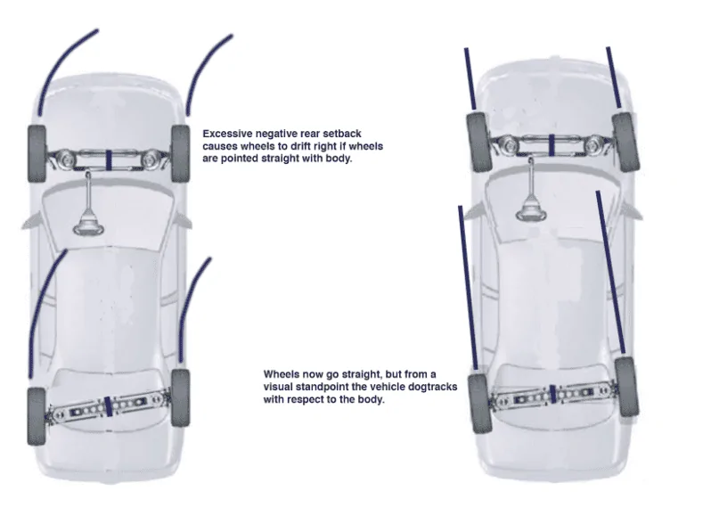

Thank you for this info! I think this is all coming together for me.
Since purchase I've had an issue where the stance never quite looked right, even when alignment was spot on. Also for quite a while it's felt a bit different turning left vs right.
Now I think I know what it is--all my wheels are pointed left with respect to the body. See below for an image of what I mean.

Thats an extreme example of severe thrust angle offset and is why anytime you work on the vehicle wheels/suspension you need to have an alignment check.

I see what you're saying. I've actually gotten 10 alignments since purchase, trying to figure out why the wheels always sat weird in relation to the body. However, when you told me that an alignment rack goes off of where the wheels point when moving (regardless of where they are in the body) it clicked.
Car drives straight enough, but considering my left rear wheel is toe out and my right rear is toe in (in relation to the body) when the wheels are straight (according to the alignment machine), likely means the body itself isn't centered on them. I originally thought this was mostly the front cradle, but the front frame rails flank the edges of the front cradle, offering little play.
The real question is: where to go from here? As said the vehicle drives straight, but the steering feel is awful (it's more difficult to steer right vs left.) Part of me thinks it might not be true setback and all, and maybe it's a ride height/shock/spring issue in disguise.
I could uninstall the steeda kit, ask a body shop to center the rear based off of frame measurements instead, but then what's to stop the rear cradle from moving back to the place it was? On that same token, maybe just getting rid of the steeda sleeves and just driving things stock might be the best course of action.

Keep the Steeda sleeves. They are part of the solution and not part of the problem. Once you get this figured out, they will be your friend anytime you lower the rear cradle because another alignment is not required.
If you are going to a shop with Hunter Hawkeye, then ask the manager to schedule you at a time when his best alignment guy can do your car. Us picky Mustangers are looking for small fractions of a degree - both absolute and error.
Have the car pulled onto the rack very straight. Have him put the lasers on the center of each wheel.
Raise your steering wheel so you can better eyeball the cross spoke is parallel to a reference on the dash.
Have him check your wheel bearings and toe links for excessive slop.
Stuff like that. Time to be obsessive.

Definitely keep the sleeves since they keep the subframe centered better than not having them. As to the subframe shifting during use the top of the inner sleeves in the bushings are serrated so that when the bolts are torqued to 129ft/lbs they bite into the chassis metal and there will not be any movement possible between the subframe and body short of a severe impact to the chassis such as in a wreck. When you go to install the sleeves and look up into the holes you will see the serrations on inner sleeves and marks on the chassis from them.
It could be very possible that your fenders or body panels from the front to the rear are not actually straight with the frames/chassis dimensions thereby giving you the differences in wheel placements in the wheel well openings. It could also be that the chassis mounting threaded holes for the subframe were incorrectly stamped into the floor pan which put every other part that locates off of those points askew and the tolerance stackups is what you see with the wheel placements in the wheel well.
Any quality frame shop can measure your chassis and critical location points and be able to tell you if there is something out of spec and possibly correct it to get the car back do a straight wheel/chassis/body relationship.

that's really bad. an alignment won't fix that, the cradle is not lined up properly. that's a warranty issue. this is one of the main things i'll be checking when i pick up my car. tolerance of +/- 1/16 is fine but more than that and you're gonna see it.
while you can align the car to make it drive straight that doesn't fix the real problem.
i went through this when i installed IRS on my cobra. i had to wallow out a bolt hole to get the subframe to where it would put the wheels in the right spot. that is probably why ford allows adjustment of these things but it seems like some of them aren't getting set up right from the factory.
