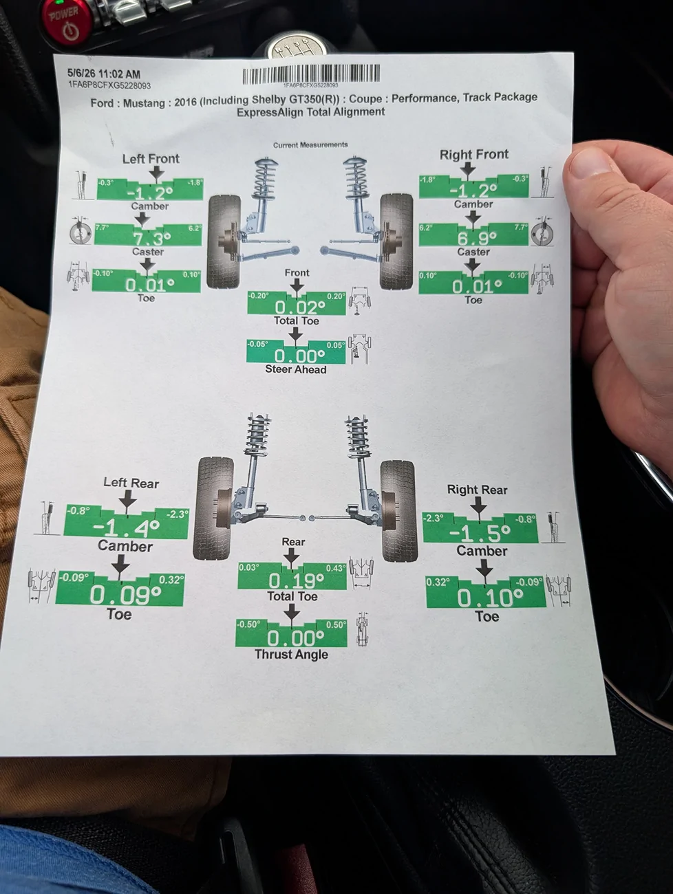

Ok, Charleston Supercar just took a whack at it. This is what they were able to come up with. The owner didn't love that he didn't have a way to adjust front caster to better compensate for road crown. The car drove much better than before.
We happy?

2nd one good. First one, I wouldn't have paid them. That is just pure laziness. Like how did the front camber change with zero adjustability up front?
Second question. What did the shop show for original settings before adjustments?
I have zero idea on the front. I didn't have the camber bolts installed at that point. The second shop kinda confirmed laziness, and said that the rear camber adjustment bolts weren't even tight. I suppose they could have backed off, but doubtful as the car only had about 100 miles on it with the first alignment.
They didn't give me specs for the before today. He did take about two hours to complete the alignment, and said he had a hard time getting things aligned. They're not a Mustang shop, so perhaps there was some unfamiliarity there, but things feel much better.
