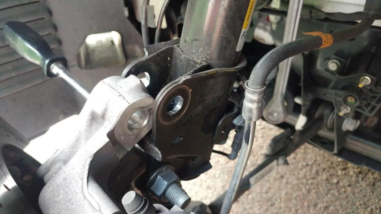

I got the bolts and will be putting them in tonight. Any guidance on the easiest way to slot that hole?

Those strut bolts and nuts are one time use, like most of the bolts are on the front suspension and calipers. I used to use a dremel to grind the slots out but a drill with a bigger grinding bit is faster. CC plates are really the best way but probably not allowed by your rules.

Take the strut and spring out of the car (but you can leave them assembled), I used a standard dremmel grinding bit, cause it fits in the bolt hole pretty well. It was a bit slow, but worked out fine.
Make sure to measure things before you start grinding so you know how much you removed.

If you're really lazy the struts don't even need to come out of the car...

You can reuse them. Mine were not damaged and i used blue lock tight when i put them back in. Plenty of people have reused them. A 3 lb mallet makes easy work getting them out

Is the upper strut bolt splined? I removed the nut, with the hopes of installing an adjustable camber bolt, but couldn't get the bolt out. I just remove the nut and pound the bolt out? How about the lower strut bolt? It needs to be loosened to adjust the camber, any tips there?

They are both splined. Just leave the nut on and pound them out on the nut. Mine came out easy with a 3lb mallet.

Yeah, except for the easy part! Took a 5lbs sledge and maximum effort for mine. Definitely line the nuts up with the end of the bolt so you have the most surface area to hammer without destroying things or mushrooming the end of that bolt, and good to have some replacement bolts/nuts anyway. If you're taking them all the way out, you might as well replace them, since they are 'one time use' by Ford instructions.
