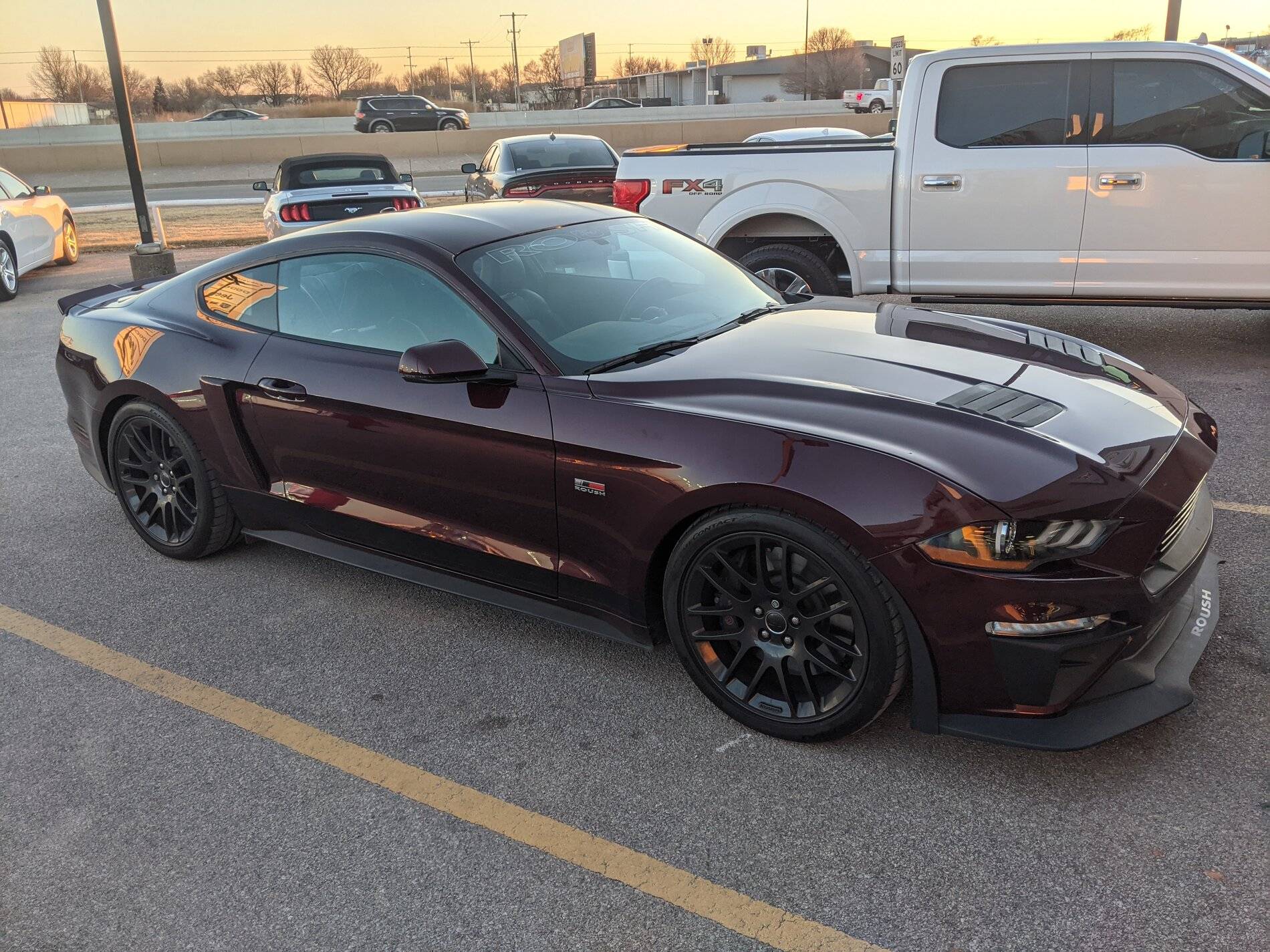

Well, I sorta strayed from an FS legal car. I found a Royal Crimson Roush Stage 2. That in itself would put it in CAM-C, but it's also got a supercharger on it. I'll probably run it as-is this year and get tires for it later. 700hp will probably have a bit of a learning curve. Should be fun, though.
