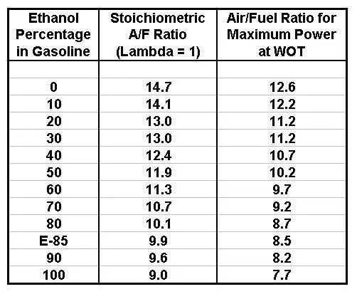

Chart above is gold. But don't get crazy with a/f while cruising. Idle and wot are what you want to look at.

If it is flex fuel running like e54-e70 11-12 would make sense. True e85 would be closer to the 9.8-10 as described.

PCM reads lambda. If lambda commanded is X value, STFT’s keep it at that value whether it’s E0 or E100. Until they go out of range either way from what your calibration allows.
Example: E60-E85 on my particular calibration, is about a 12% fueling swing.

It depends on your tune, the tuner sets a desired target AFR for pure e85 tunes, and uses a blending table for flex applications. The tables are usually based heavily on the F150 flex tables (if they aren't copied directly)
If your flex then it should vary based on the chart above, if you're straight e85 than this question is better directed at whoever wrote the tune you're running.
