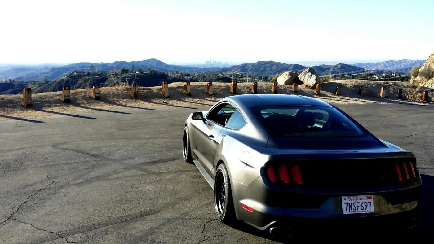

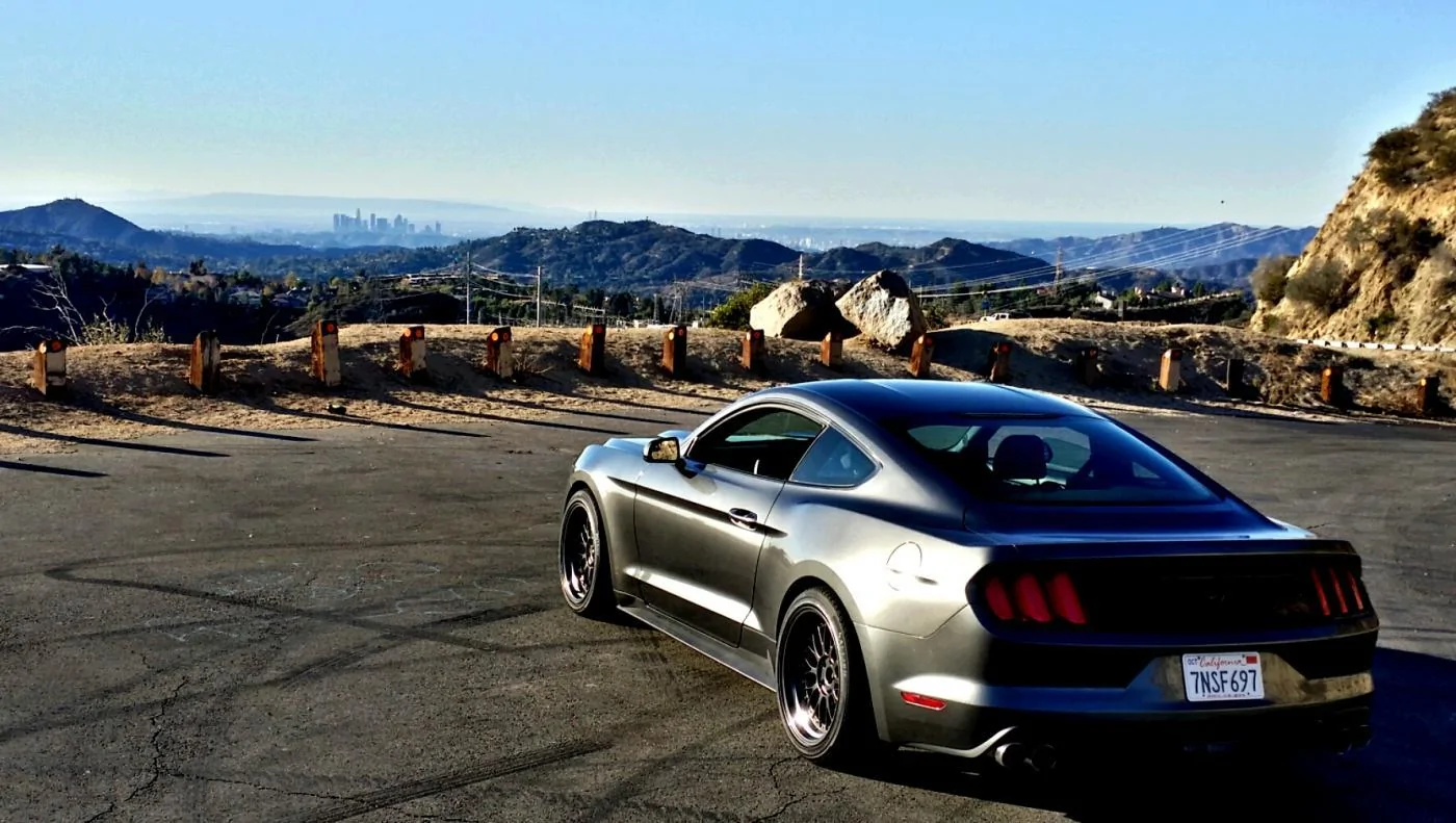

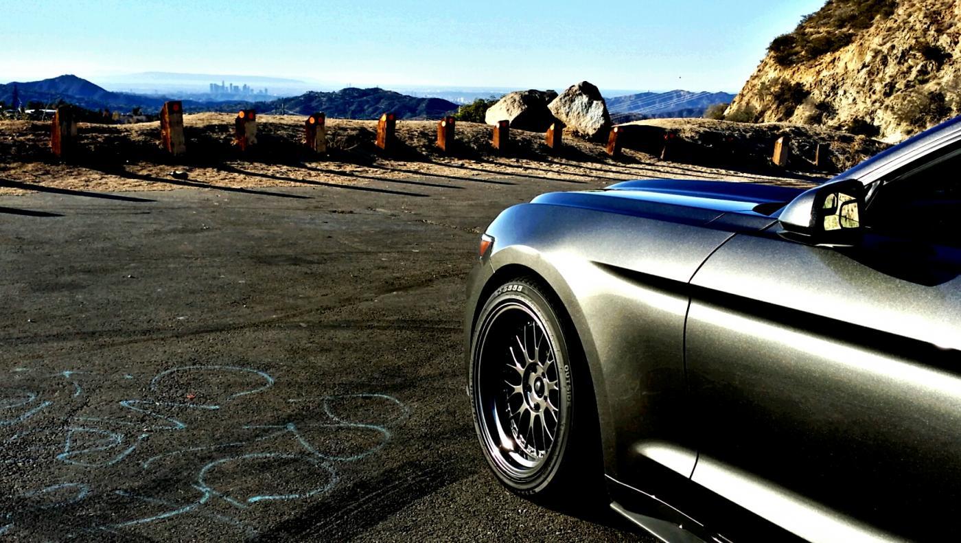

Bathurst 20x9.5 +35 and 20x10 +40.
Michelin pilot super sports 275/35 and 295/35.
Lowered with Eibach pro kit.
I hope some negative camber tucks these in enough as I am getting rubbing on the rear tires on bother sides. Any other thoughts or suggestions? I tried to stay in the range of what others have done...
Update: adding -1.7 negative camber to the rears fixed the issue and I am almost exactly flush now. Test drove and no more rubbing. Thanks for the input!
Here's a pic post alignment:
