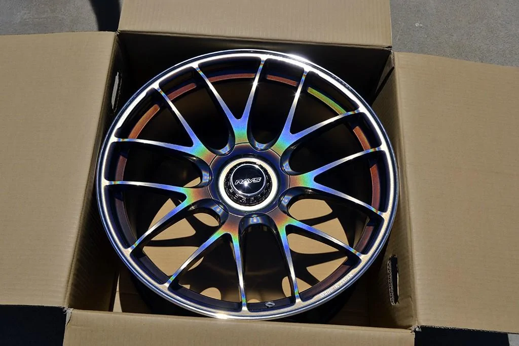

Congrats!! Ray's Prism finish is AMAZING
Prism Dark Silver G27
