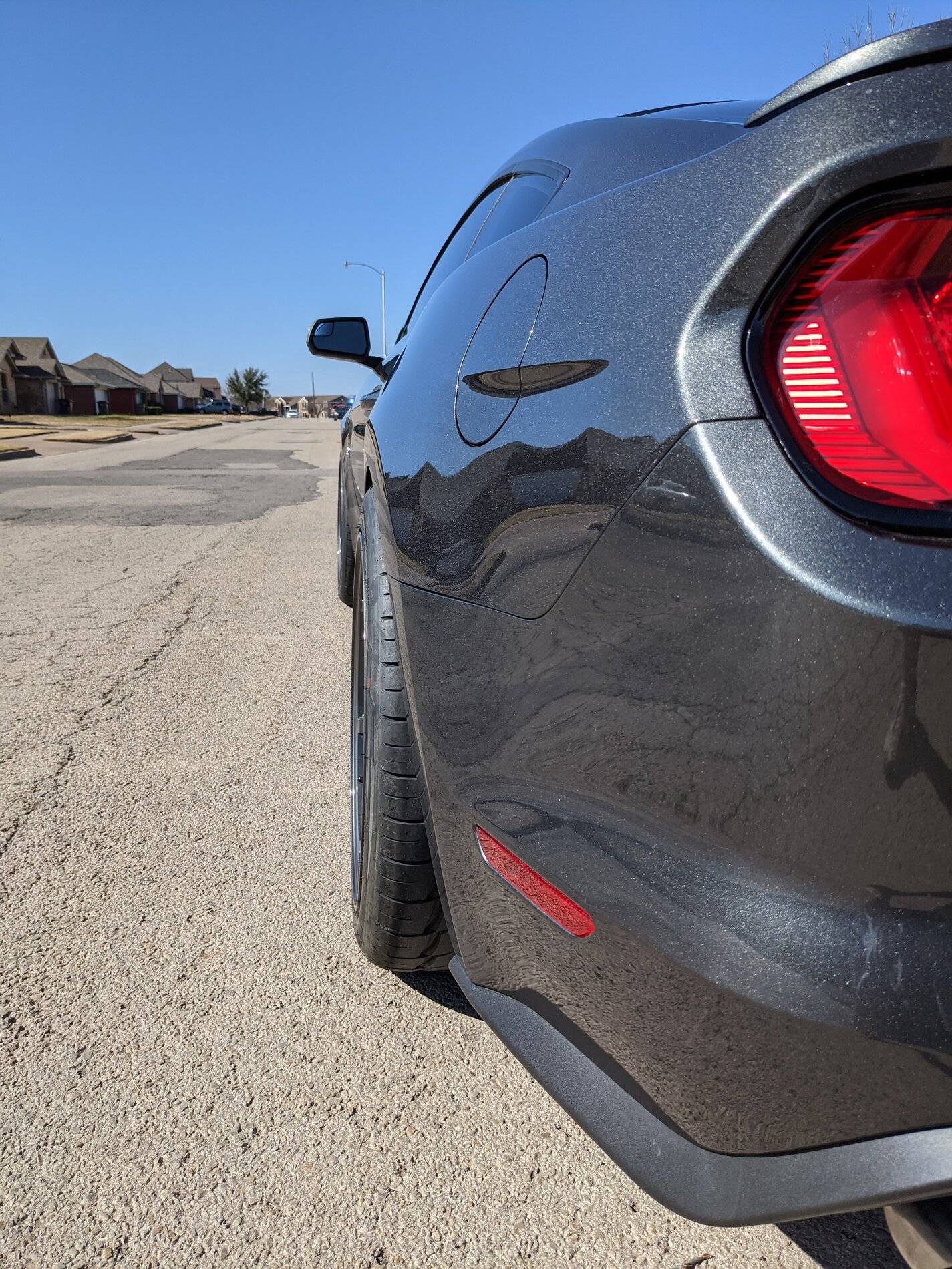

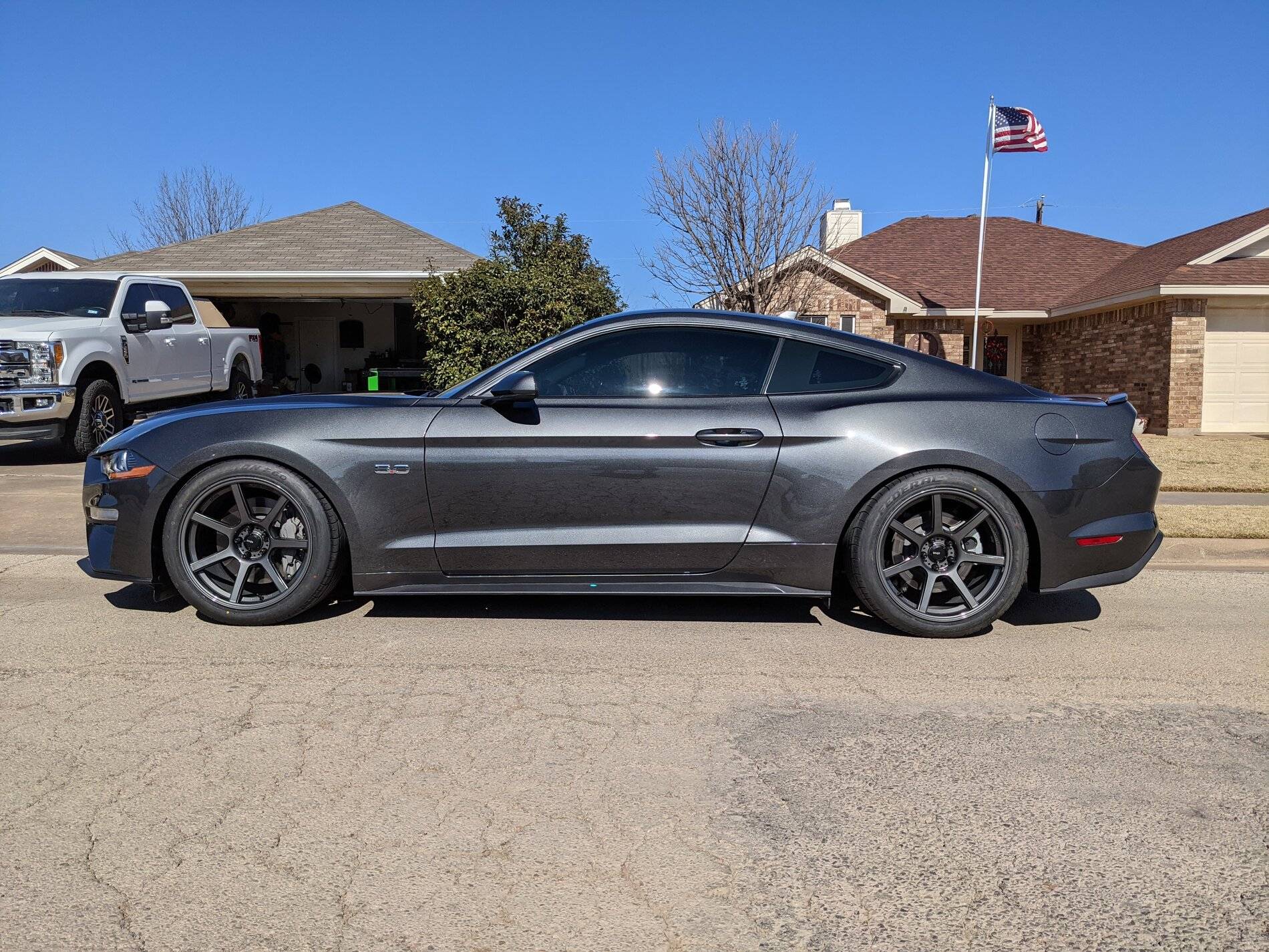

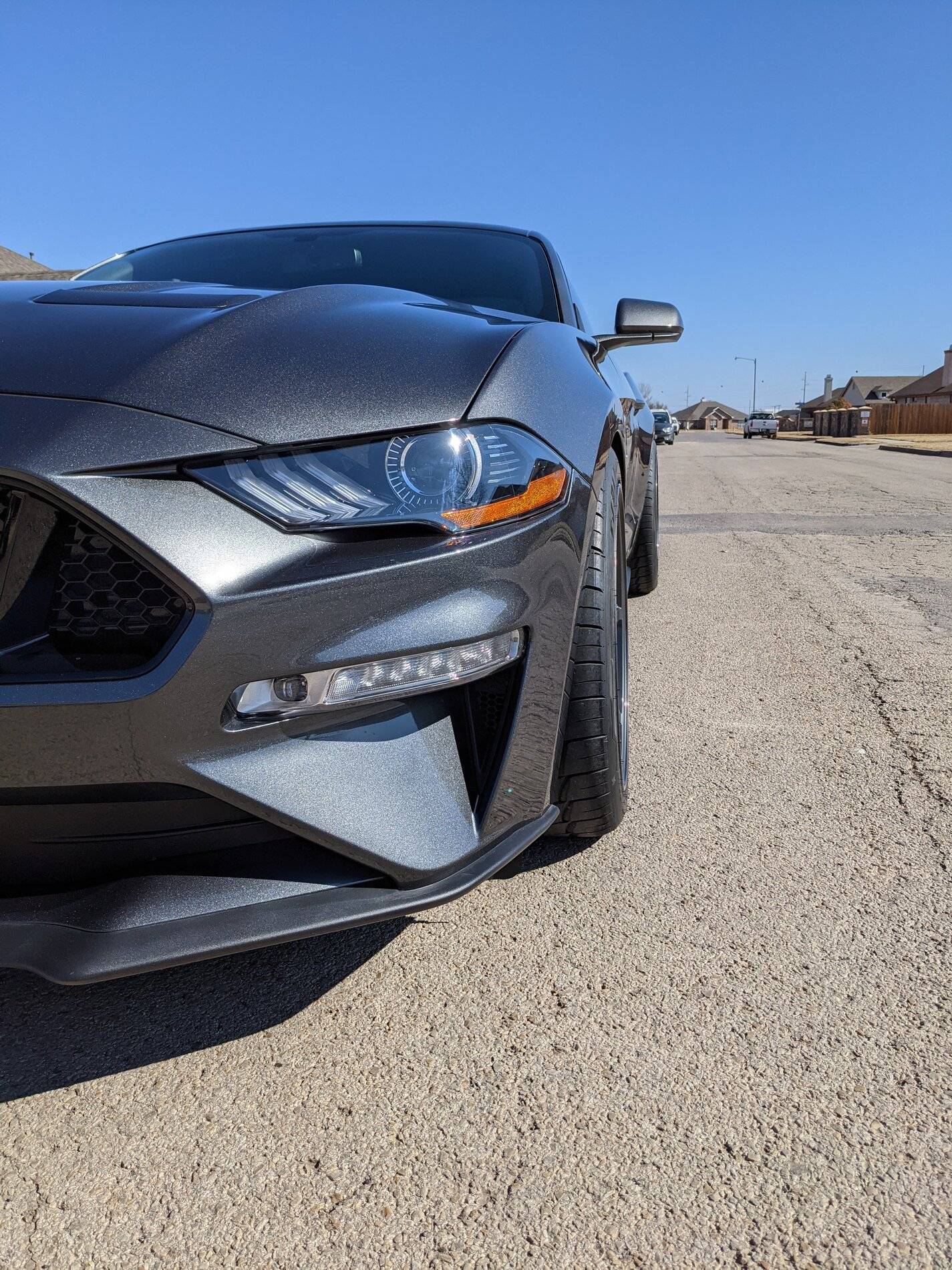

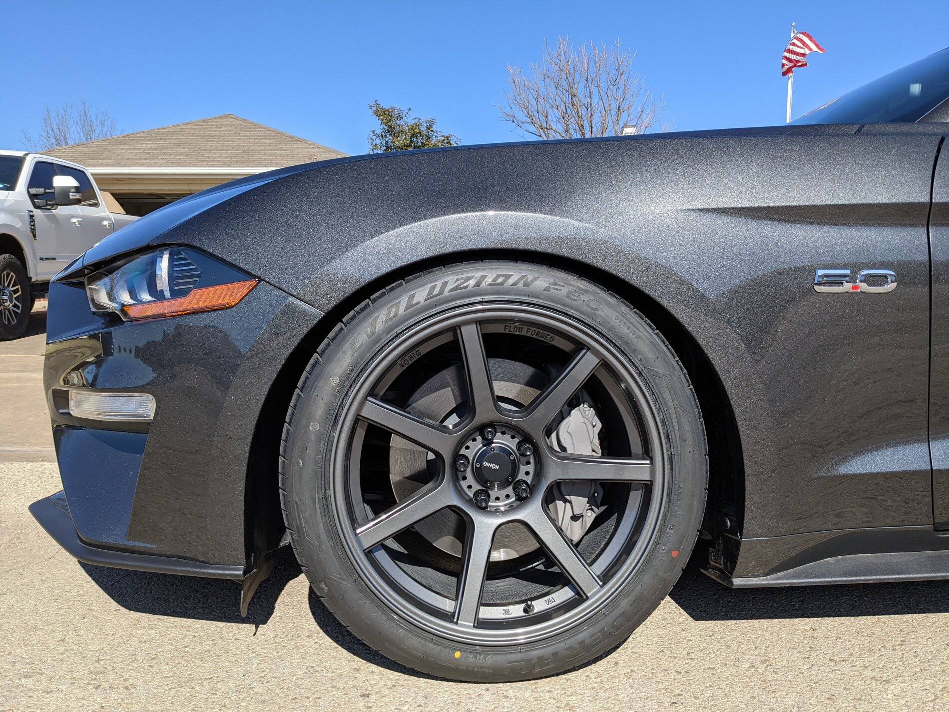

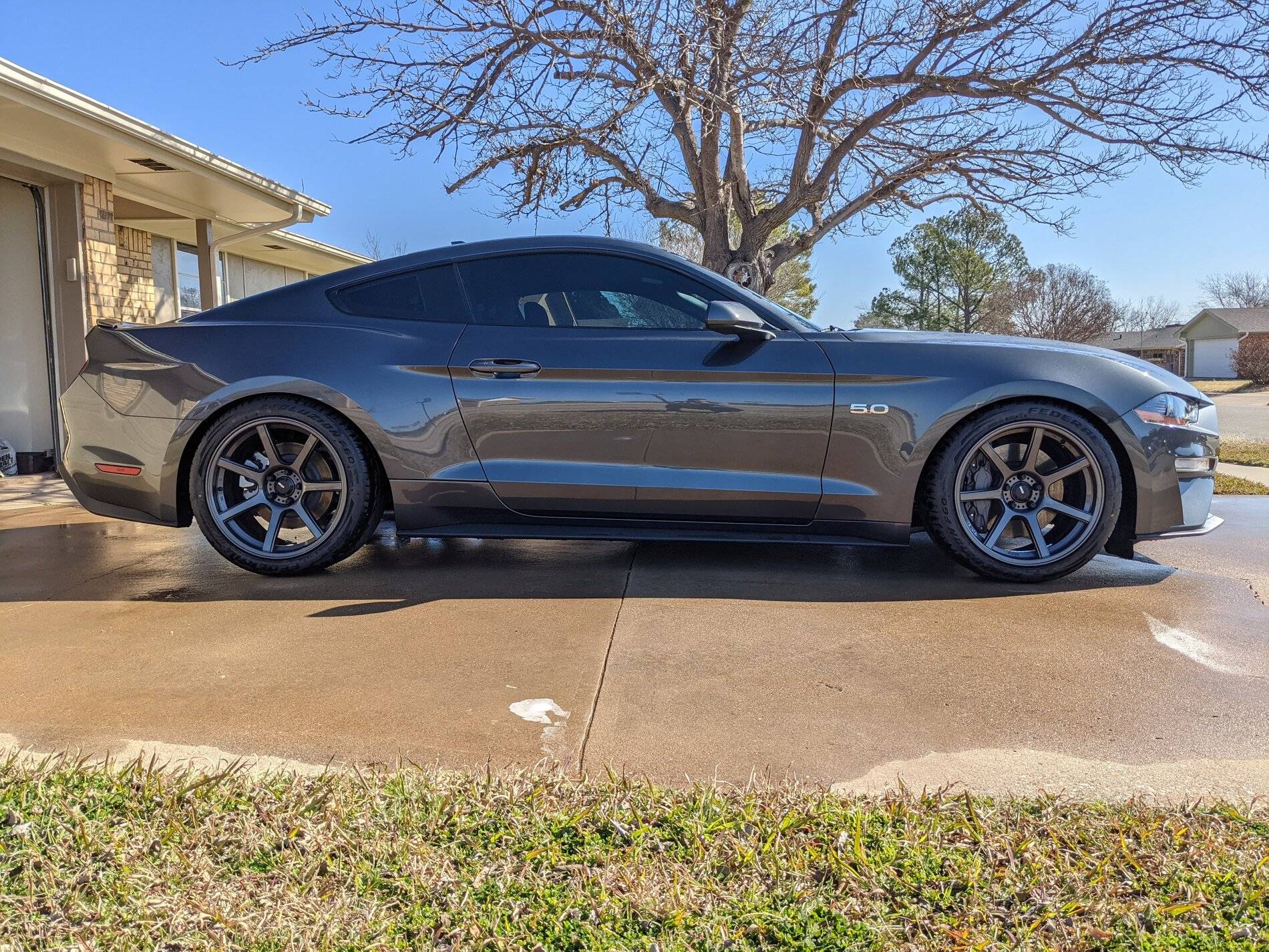

Konig Racing Ultraform Gloss Graphite 19x10.5 +25 Square with 285/35/19 . Will be going to 305/30/19 in the future.
BC Racing Coilovers
From what I think I know, that's some real aggressive specs in the rear. What do your alignment specs look like?
It is somewhat aggressive, it settled at -2.6 in the rear and my front is sitting at -2.8. I will need camber arms to pull in any more on the rear. Unfortunately Konig Discontinued this wheel so I was stuck with trying to make the +25 fit. They made a +40 as well but I looked for months and had four different companies look for them to no avail. So alas the square setup of +25 is where I stand. But I'm not sad about it in the least.
I have had these wheels on three(350Z/370Z/ZL1) other cars all with 19x10.5 and all have ticked the scales at 19.2lbs each. Which is VERY light for a 19 inch wheel that's 10.5" wide. A very strong design, and have never had any issues when road course racing, or autocrossing. Not to mention this gloss graphite is literally the same as the Magnetic Metallic with just a little less metallic flake in it.

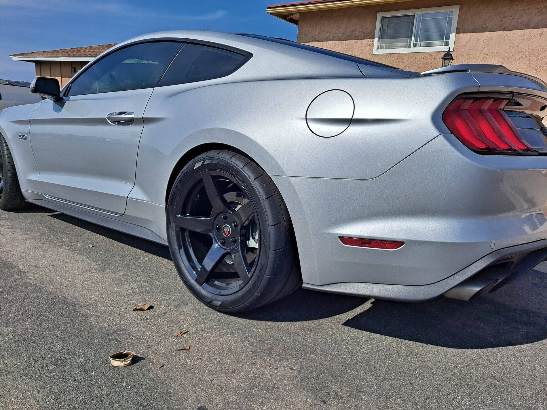

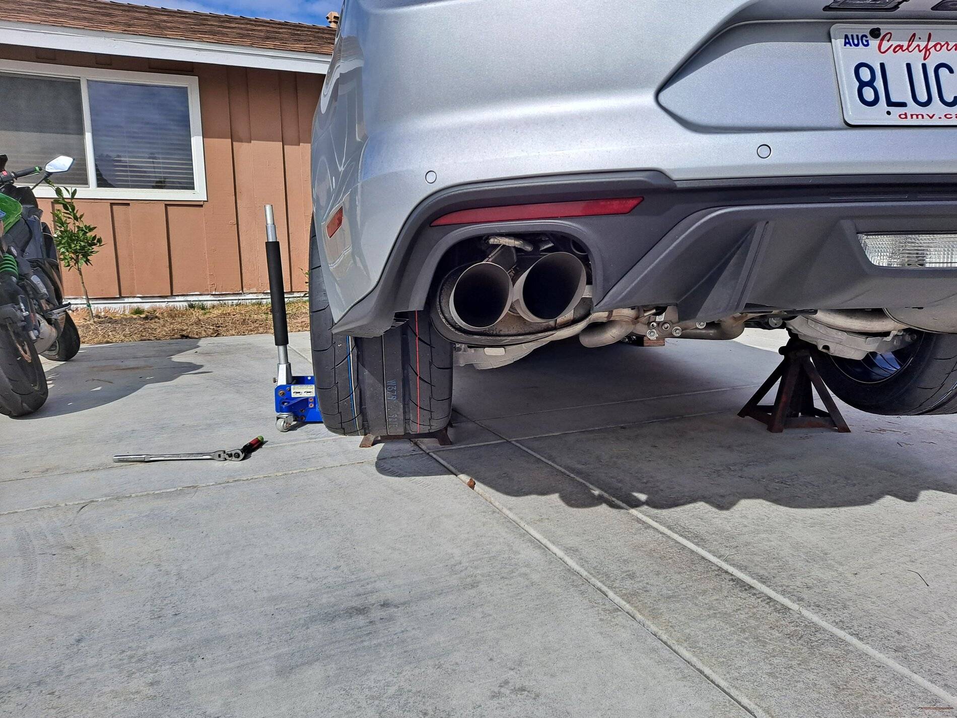

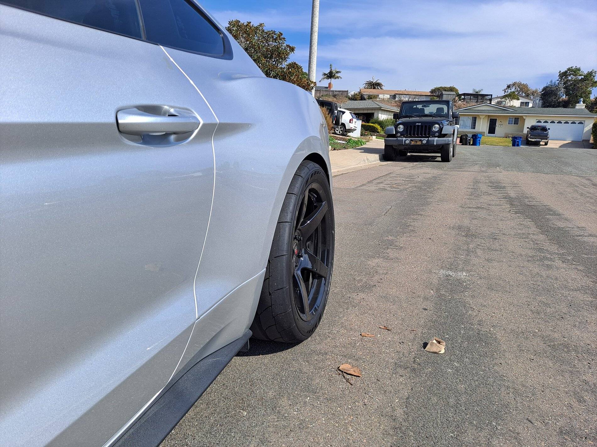

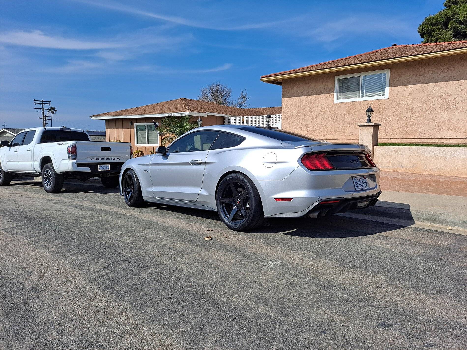

So here's my report on fitting 20x10.5 +45 Velgen VMB8 square setup. I tried it with a 3mm spacer first and was not happy with less than 1mm wheel to strut clearance and then with a 5mm spacer. I always wanted to experience a wide tire in the front and to my surprise, with 305's the tramlining I was so worried about was not present at all. Another concern was the tire to spring support plate clearance, but as you can see in the photo it clears just fine. I put the old and new wheels on the scales and it showed a total savings of 5.6lbs. As for the driving, it grips really well when the tires get warm, it's not much noisier for me to notice, the road imperfections are a bit more noticeable but that's what you'd expect with the lower sidewall. For the looks, the front wheel sits ok to my taste, but if not my very steep driveway I'd drop it even more, but the back with this tire size doesn't fill the wheel arch well enough. That's why I already ordered 305/35 Nitto R2 for the back. It will also add the rake back that I was not happy losing with this square setup. Keep in mind, I still have -1.9 camber on the front and -2.4 on the back from when I was running 25mm spacers. I don't need that much camber anymore and as soon as I install FP Track struts I'll be setting back camber stock and leave about -1.7 in the front. For now it's stock PP1 struts and Steeda Sport progressives.
Looks really good. With the 305/35 giving an extra inch in diameter to the rear wells, it will fill it in nicely. No concerns the extra inch will rub anywhere ?
One of the members here (@krisk) runs the same exact tire with the setup that extends 1mm more than mine in the rear without any rubbing so I am sure it will be fine.
