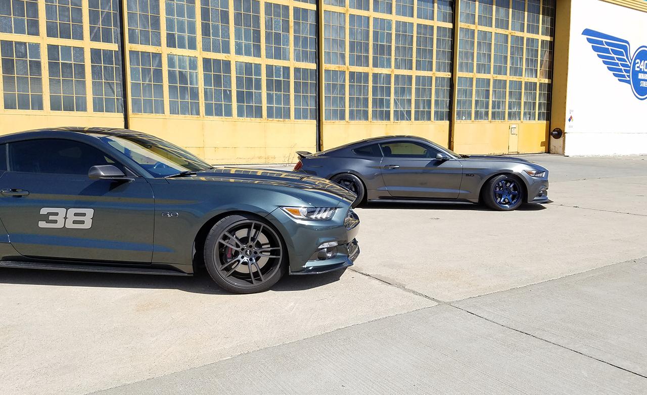

I believe they are pretty close front and rear. Here are a couple of pics so you can decide for yourself.
Looks perfect :eyebulge:

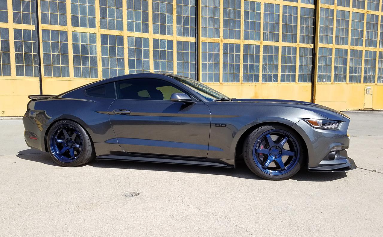

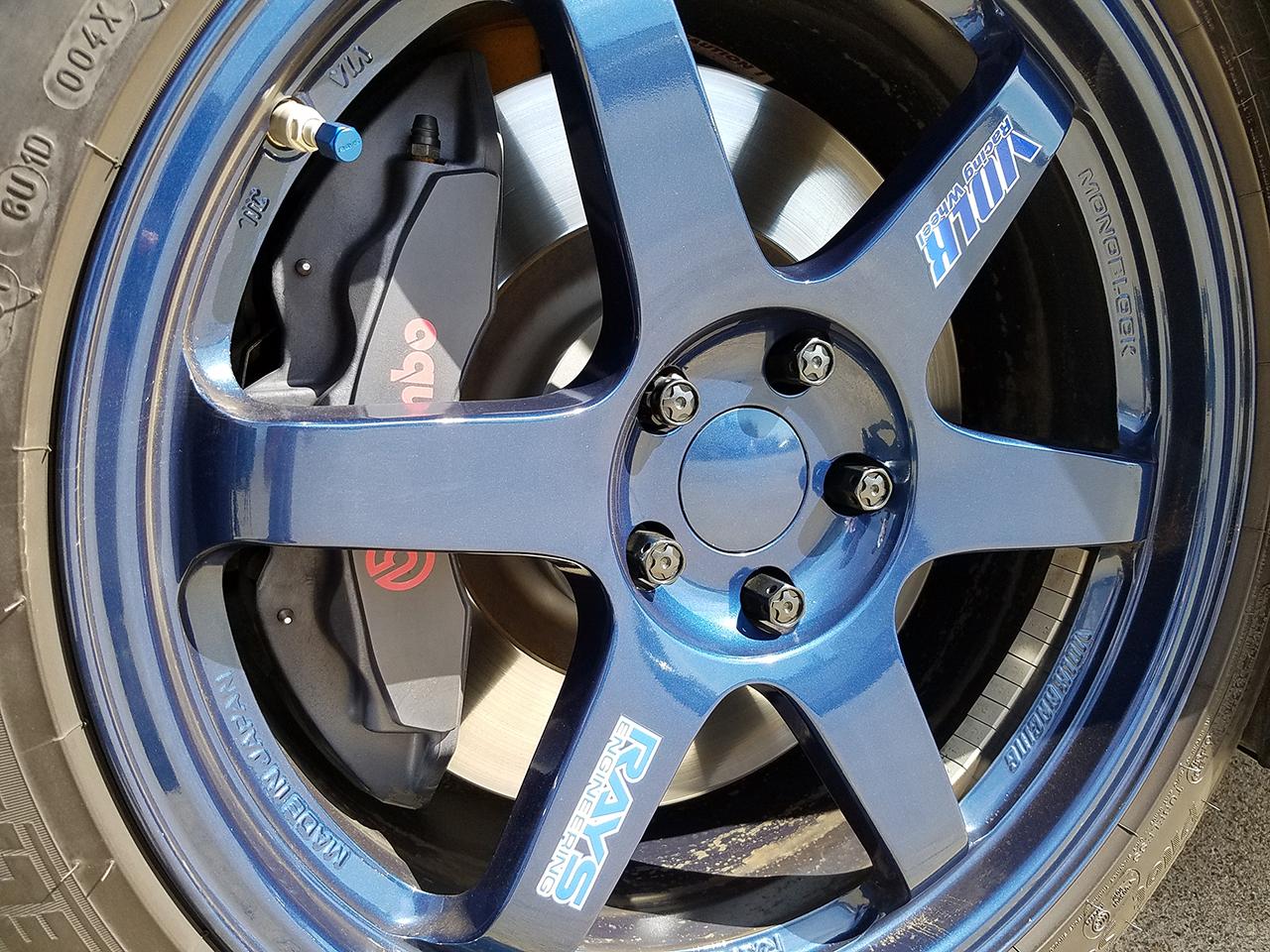

Hey guys! Need a bit of advice here before I pull the trigger as I'm looking at a similar set of fairly aggressive wheels for my GT.
The owner of the car below says that the pictures below show a TE37 in 20X10.5 +22 all around on 275s (and that they fit with no issue).
Does that sound about right to you folks?

10.5 with a 22 will poke on the front. I have 10" with 35 and it's about flush. I'd say with a good amount of camber you can make it work but won't look good IMA.

If your going for that aggressive stance which will look dope lol it will work.
I can try to look for some pics but we did have a client do a 19x10.5 front and a 19x11 rear with our FS01 wheels.
you can also get the look with out going to wide/ simply lowering the off sets of the wheels, if you already have some wheels on your car then you can add some spacers and it will give you a good idea of what to expect.
but** this would look funny if you have a 20x8.5 and you add like a 20mm spacer lol ** you do want the wheels to be some what wide.
mods maybe required like fender work, possible camber and open minded to tire sizes.
