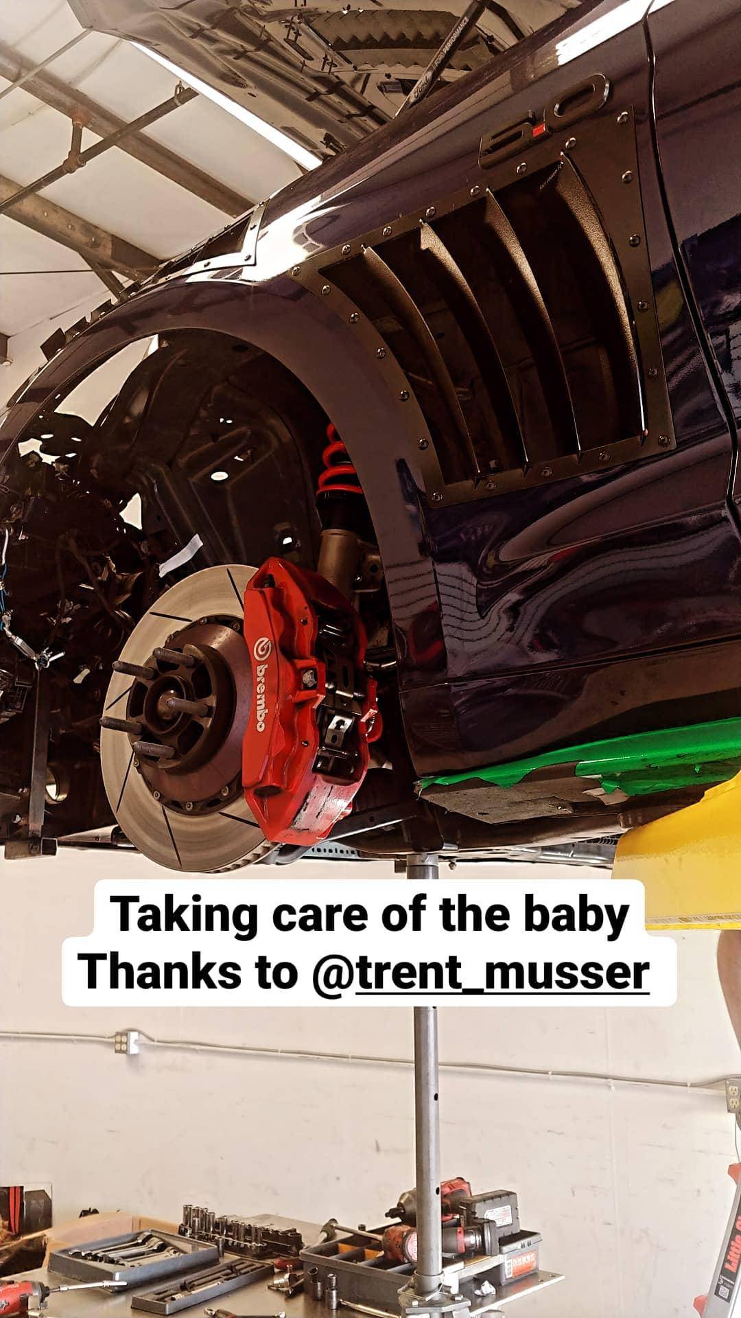

I use girodisc. My car is a track car. I had them since car was still a street car.
Pros
11lbs each lighter.
Better cooling.
Mine last long. (better cooling better wearing)
Cons. 1000$
Is it worth it for spirited driving. No.
More than 6 event per year? Maybe.
The pads are more important.
Pair with a good pad (not the hawk5.0) and you are gold probably with oem style too.
