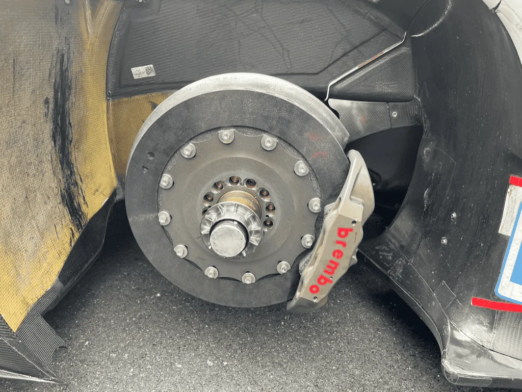

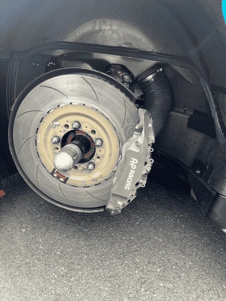

Here's basically a summary of the rotor tech of EVERY car racing at LeMans last month.
