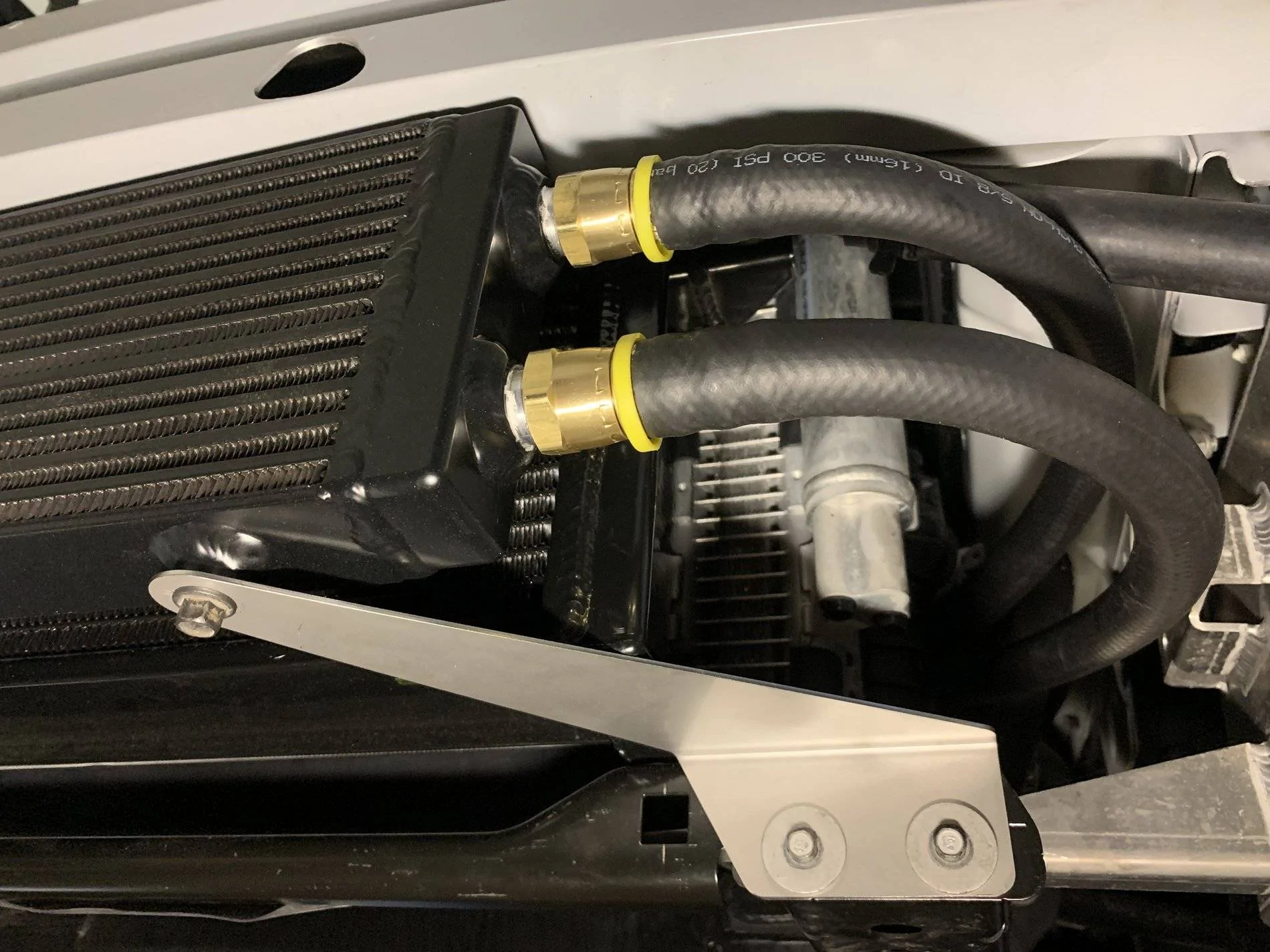

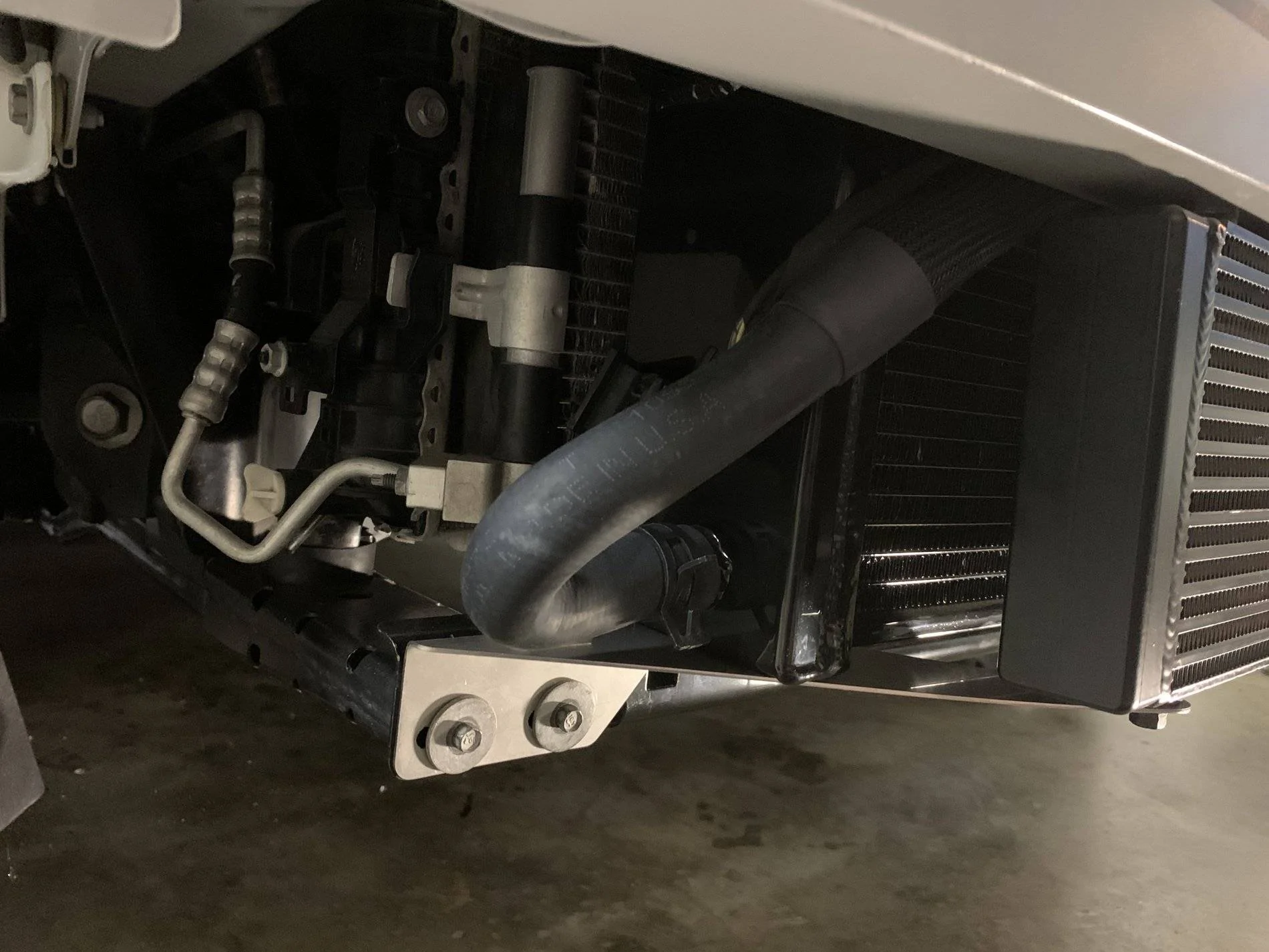

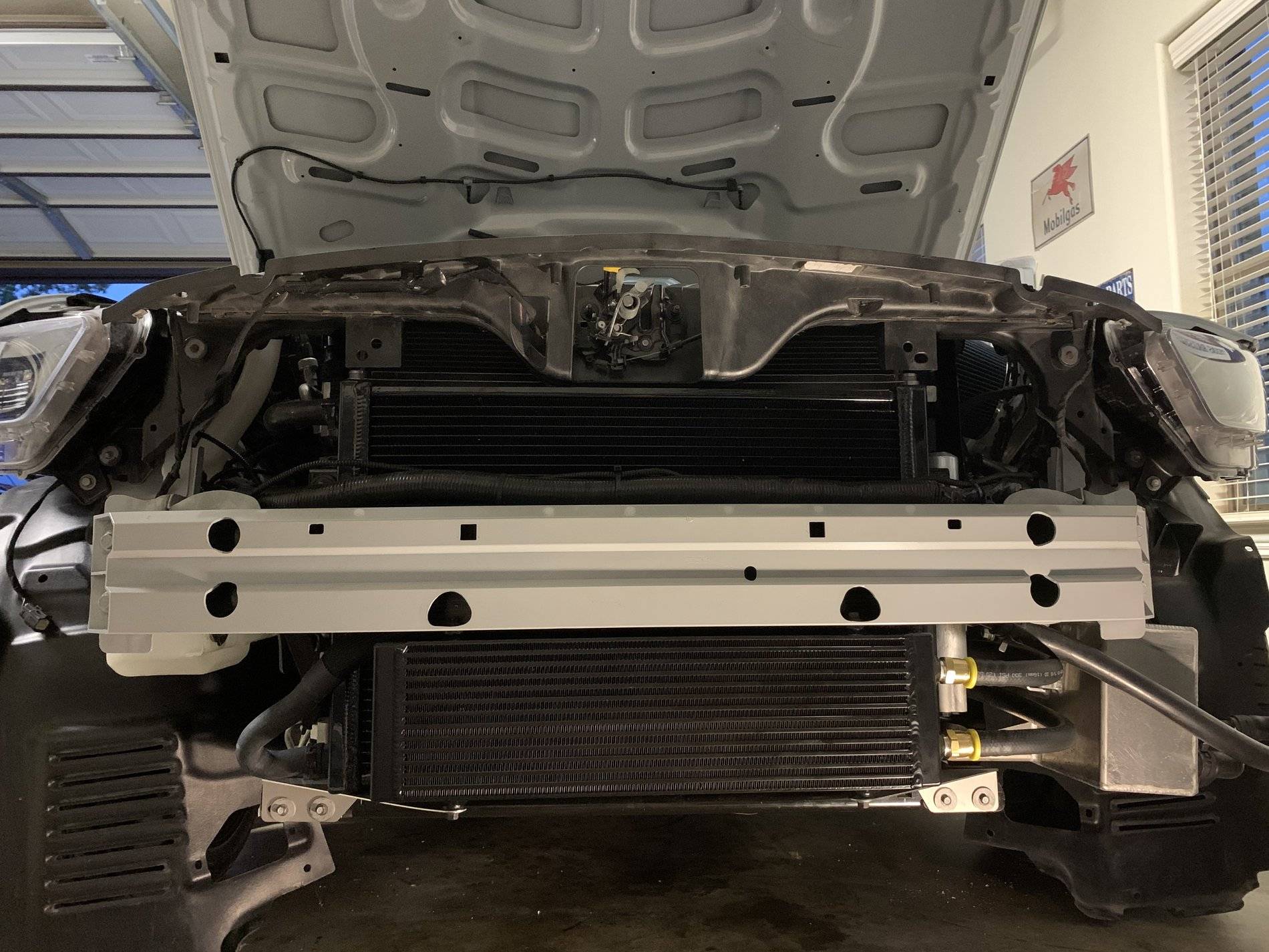

I just upgraded to a larger oil cooler and I am pretty pleased with how it turned out. I have a tank/pump in the way of the factory setup so I bought a larger oil cooler off of Ebay for $90. The cooler was built much better than I was expecting. It has welded bosses on the top and bottom so I mounted it directly to the underside of my bumper and made some stainless brackets to support the bottom. It fits in really well behind the bumper cover and other than the yellow guard on the parker hose ends I am pleased. =-)

No issues with oil cooling at all. The car originally had an oil cooler mounted between the supercharger heat exchanger and the A/C condensor. I upgraded to an oversized thicker heat exchanger so I was forced to relocate the oil cooler. I don't ever plan to run the car on a road course so I think an oil cooler is overkill but I thought it looked cheesy to just run a loop on the oil cooler lines.
