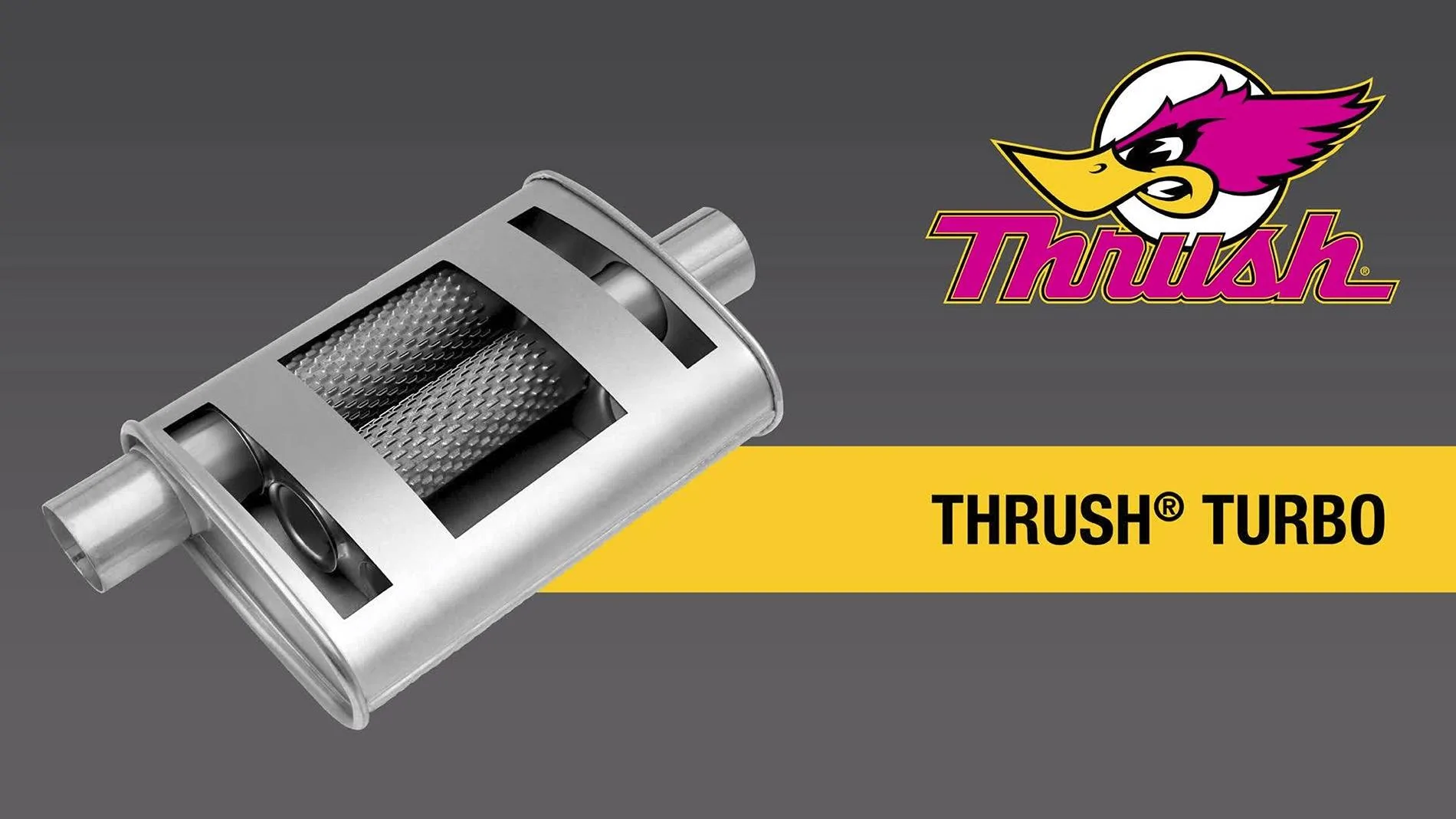

I’m struggling to understand what you’re saying exactly but will try to answer your question. In your context, it appears as though “turbo” means something like a glass-pack or bullet style muffler. If so then I don’t think adding more will accomplish what you want. This style “absorptive” muffler only has the ability to reduce high frequency sound. Adding more will still allow mid and low frequencies to remain. I’ve found the best results by using both absorptive (like a bullet/glass pack) and reactive (like a corsa) mufflers to capture the entire frequency spectrum.
This is a turbo style muffler
There are some differences but most are basically like this.

It is not

Turbo mufflers cost HP, they flow like shite.
