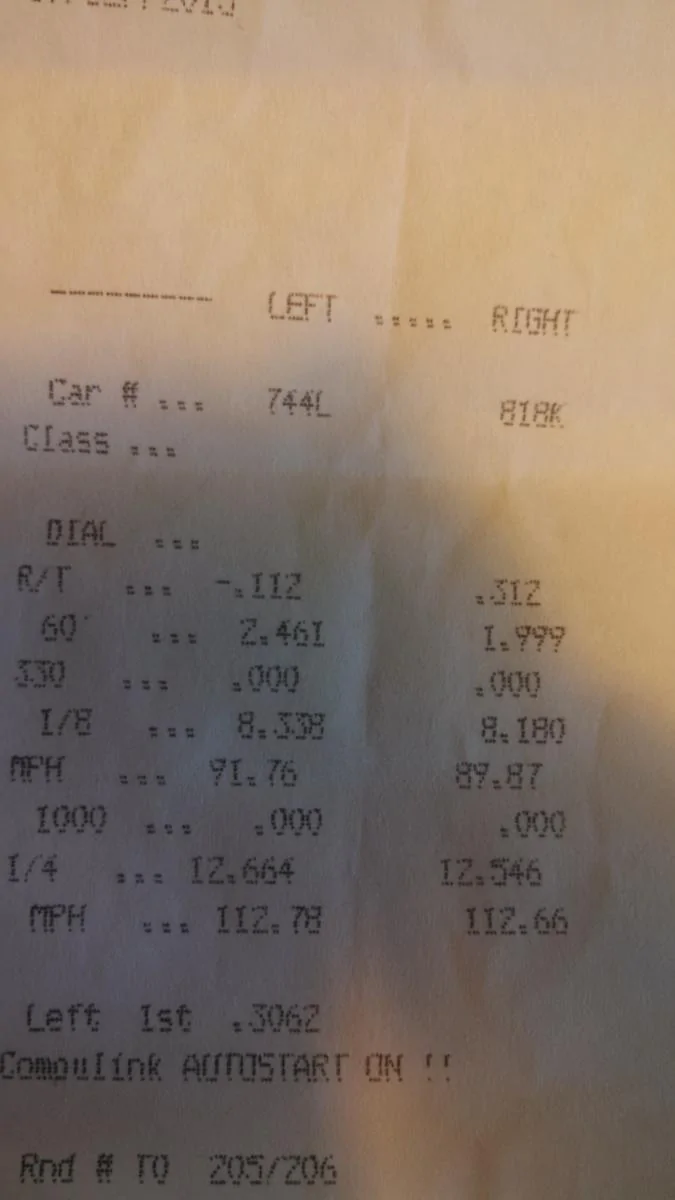

Ok so let me follow up. I got the Lund tune and it did feel the most aggressive and powerful. Rev's to 7500k before it shifts. I went back to the steeda tune for a better comparison and raced again. This time no cats and all 2.5 inch exhaust into a borla x-pipe resonator. I also put the stock air box back on with an AEM dry filter. Just going back to the stock air box felt better than the k&n cai at low rpms. The AEM filter came last and I didn't notice a thing. The 60fts still suck but I think I've finally discovered the launch secret. I will race this combo again In a couple of weeks but with a full tank of gas. I believe I can get the 60fts down to a 1.92-1.96 which should shave a 10th off, 12.45ish. If I can race again in Oct I will try some better gas along with the Lund tune and maybe...12.30 range. I'll leave the light weight pro star wheels/drag radials for next year. I'm the right side of the time slip.

Another curious thing I noticed after the exhaust changes. The car reacts slower now. My reaction times are usually .150-.200 when I race. This time every pass was a .300 average. I had to hit the light at the very beginning of the 3rd yellow.

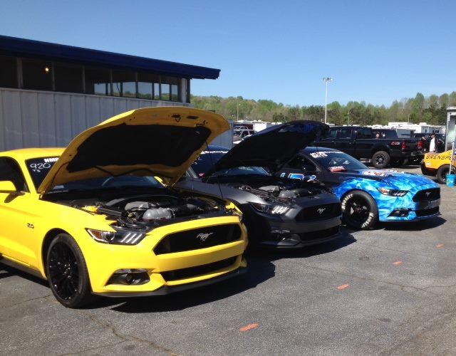

All tuned by Rick Erdman@ ATS.
NMRA Atlanta
Just saying. There are more good options for your tuning needs than just the few always mentioned. Rick Erdman has been developing his tuning files since October 2014 when we bought our 2015 GT right off the truck. It was the very first one that dealership got in.
Rick has been working with it first with a Procharger D1 and now currently with a VMP TVS.
He has been finding all the weak links of high HP by racing NMRA this season.
Rick has been working via email since the late 90s and doing remote tuning for many years. He was actually one of the very first tuners to offer it to his customers for whom coming to the shop for a dyno tune was not an option.
