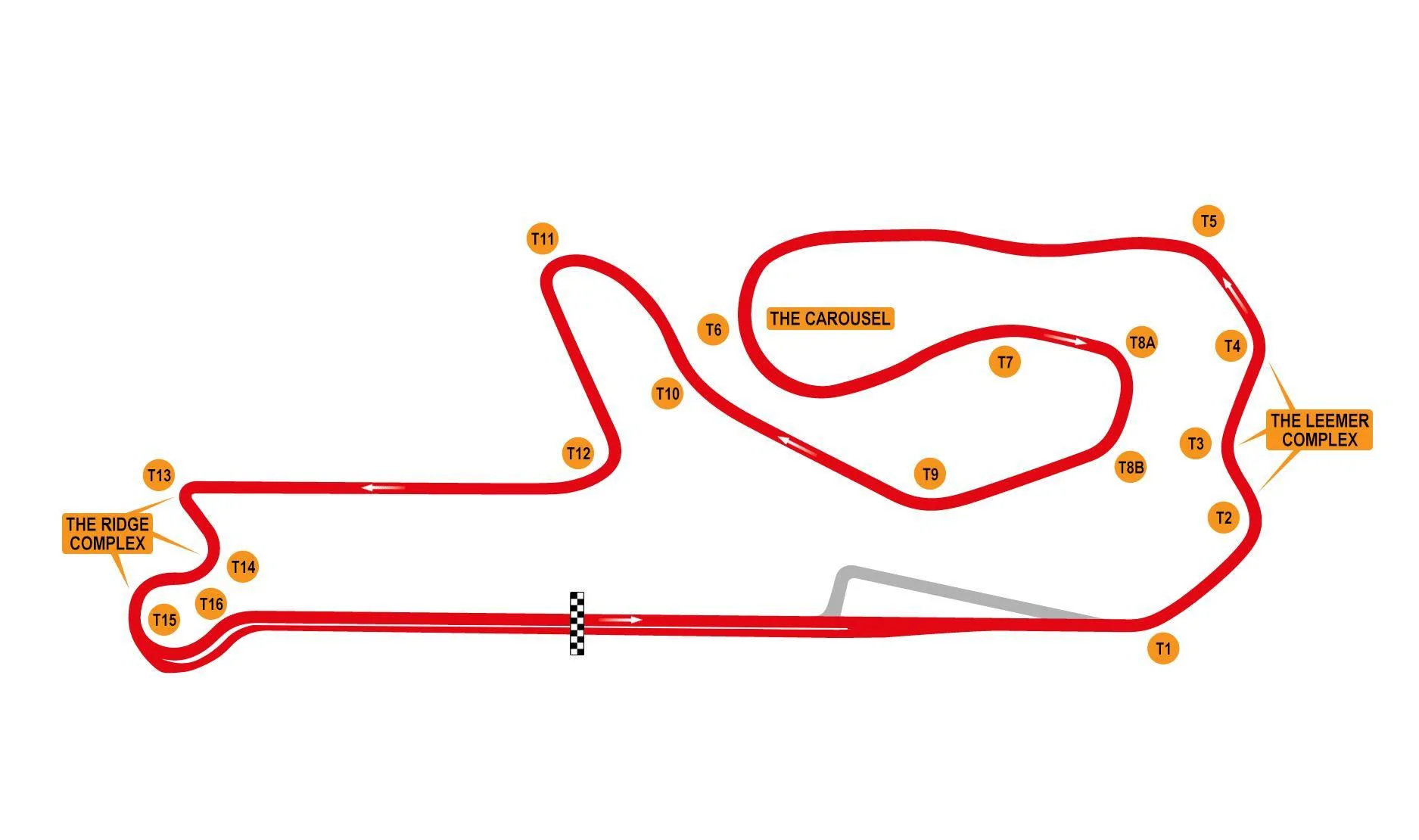

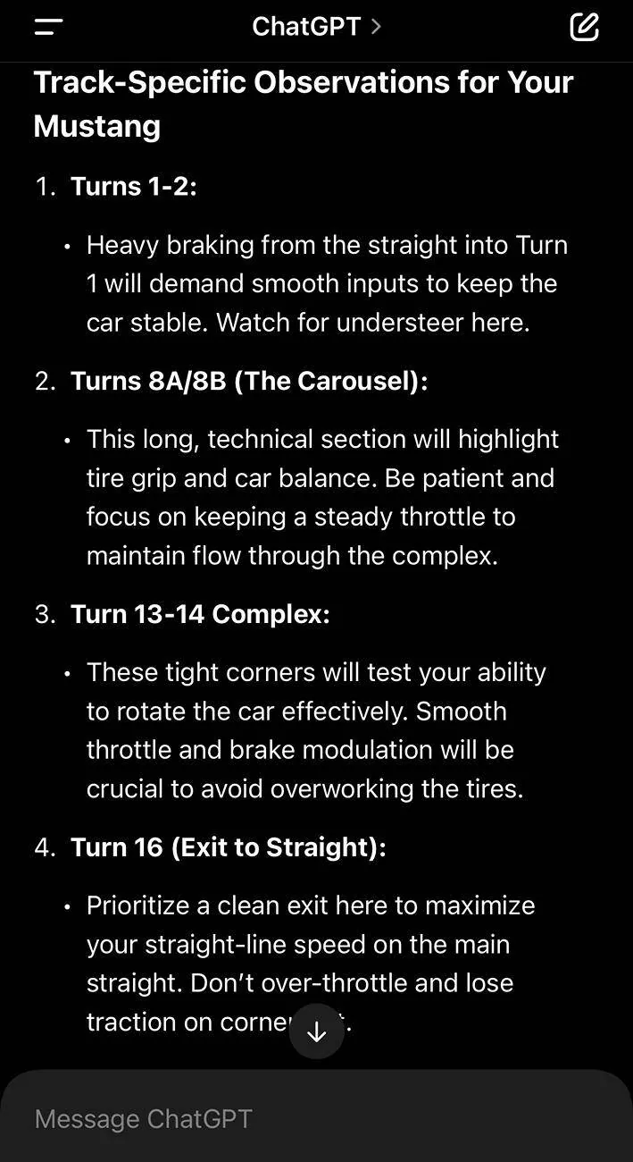

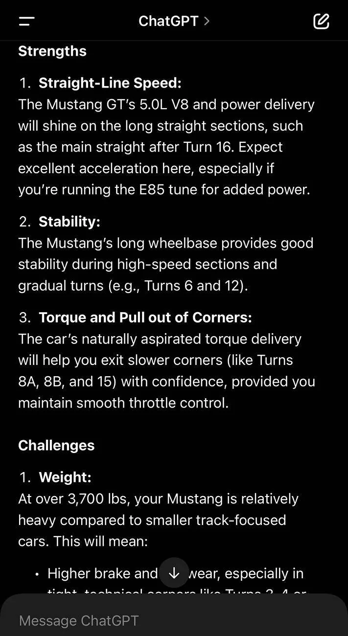

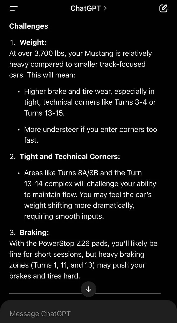

I know the tires are not optimal for the track but I also don't plan to go for any record times, I just plan to get out there for my first time on a track and get seat time. The track is The Ridge Motorsports Park and I have been practicing on Assetto Corsa on my sim rig for the event, I even resorted to asking ChatGPT (I know, I know) and I even got some decent info from it based off my car specs and the mods listed above.

I have thousands of laps at The Ridge. It's one of my favorite facilities. I'll be there the weekend of the 19th for a test & tune and again the following weekend for the LDRL race.
The Ridge is a fast track for a high HP car and you really need to pay attention to braking zones and decreasing radius corners. If you apex too early with too much speed you'll end up off track. Luckily there's plenty of runoff but you may get stuck, especially if it's wet. You'll have a lot of fun if you don't get over-confident and push too hard. If an instructor is available, take advantage of it and pay attention. Watch your mirrors and be aware of what's going on in front of you as well.
A word of warning: Once you get that rush of driving on a racetrack, you'll want to go again and again. Have fun!

Thank you so much for the advice! I'll make sure to keep in mind about the decreasing corners because on my sim (I know it's not the same IRL) turns 11 & 12 really trip me up. 11 is hard to get a nice speed and line dialed in and heading to turn 12 I have to shift to 3rd because 2nd isn't long enough to ride out before decel and turning. I also am worried on having a good flow on turns 2 and 3. I'll have to see in person how everything goes but regardless I'm super excited!
