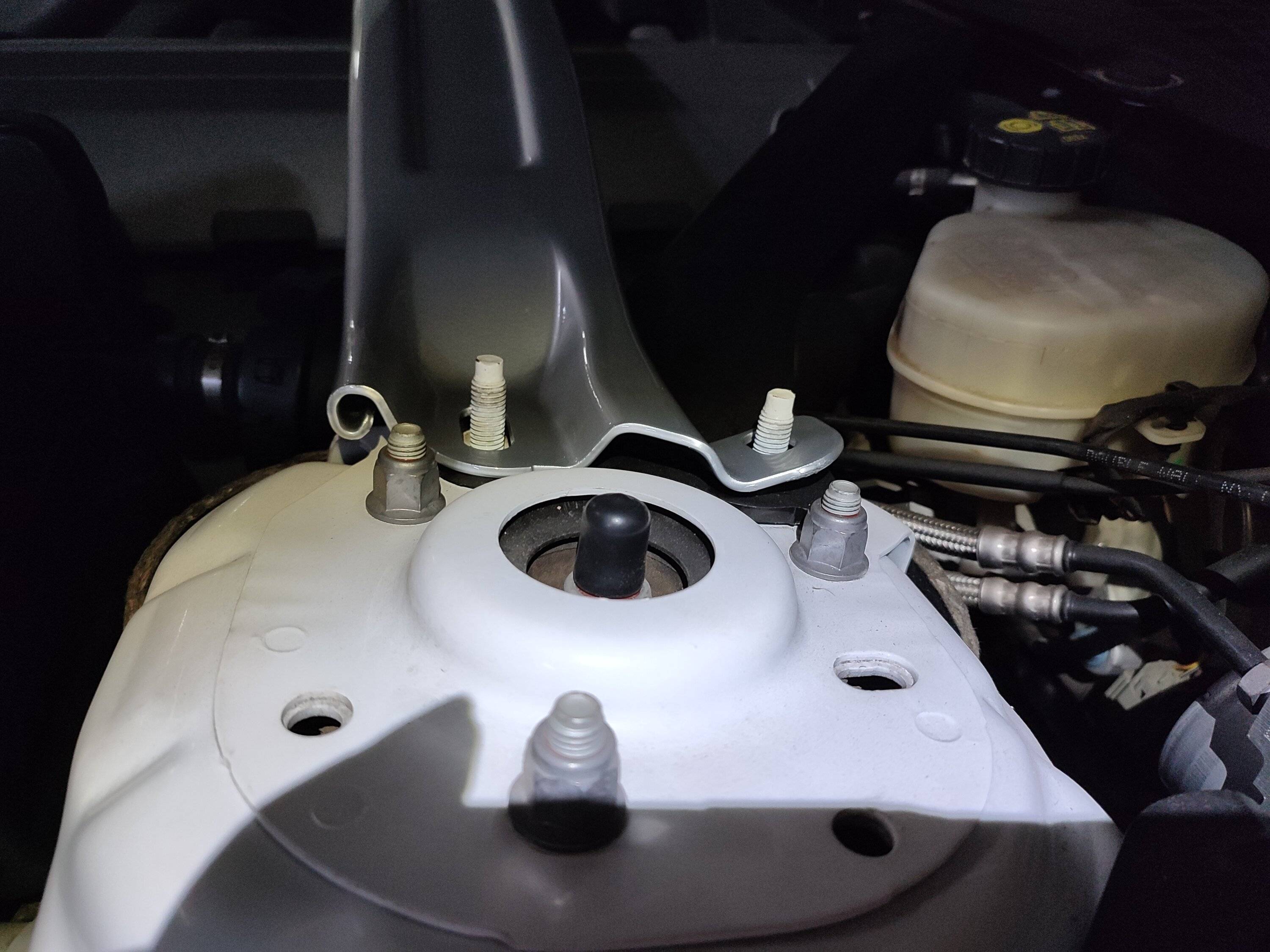

Well, finally my story does not have a happy ending. Once the piece is received, it turns out that a tab is bent, so the nut does not seat properly and there is a risk of breaking the bolt. It's time to claim but I'm pretty frustrated. If they return my money, I think I will not order another piece. I don't really want to continue with this that only brings aesthetics.

That is easy to fix. The top strut brace does stiffen the chassis.

Just put the corner in a vice and bend it back into shape. Not a big deal, will not stress the metal.
Well, second part of the end of this story. I followed your advice and took the brace to a body shop. The could aligned the tab, but some paint chips appeared -unavoidable-. Anyway I applied a bit of varnish to prevent oxidation at those points.
Finally, I bought 4 fresh nuts, because they could be provided here earlier than I supossed, peace of mind, fresh nylon, no need of glue, applied a bit conservative torque, 39 lb-ft, about 4% less considering the factory error of the tool. Don´t think there could be any issue. I felt relaxed when I applied the torque and none stud was broken. I'm not even going to tighten the lug nuts after I move the car, it just stays that way.
Thank you very much for all your useful advices. Tower brace installed. Accessing to the oil dipstick is a bit PITA but it´s not impossible.
