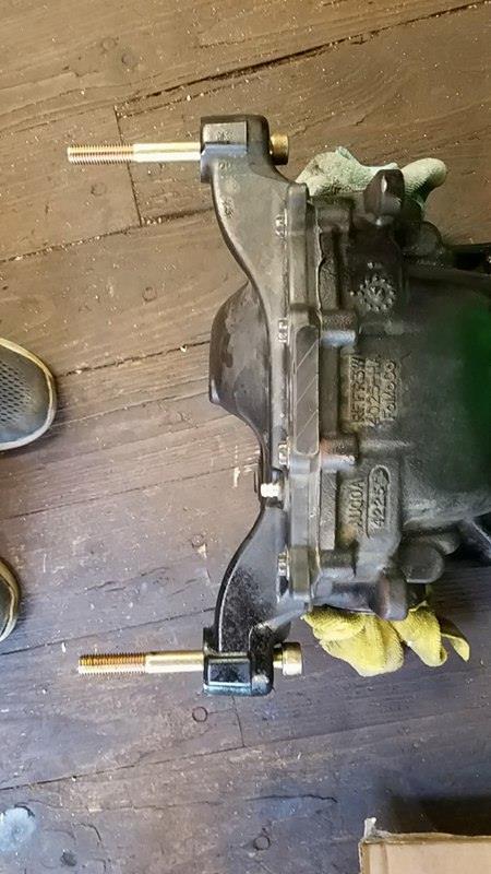

Plenty have broken diff bolts without wheel hop, including myself.
The best way to overcome this is to simply remove the shear loads from the weak threads on the 10.9 Graded 14mm bolts.
For example, use a 12.9 Grade bolt and place the shear load on the shank. The difference in shear load capacity is staggering.
Excellent stuff Kelly!
There is probably an obvious answer to my question but I'm gonna ask it anyways, for us running STEEDA's insert kit, would we be able to get stronger hardware from you?
IvanCRF
IvanCRF
Feb 19, 2015
1,166
352
El Paso, Texas
5.On'ry
Would this require re-threading the differential?
Are you running their kit? If so, shoot me a call and I will send them out to you. :cheers:
No. It requires drilling the thread out to fit the shank through, and also requires some minor mods on the front side of the mounting ear.
Yes sir I am...Thank You Kelly! :headbang:
Will call you in 10 minutes...

Kelly, do you see less failures with the all aluminum differential bushings? Or is there more to be had with the shank style bolts?
BMR Tech
Sep 4, 2014
168
5,141
3,711
Tampa, FL
www.bmrsuspension.com
Dion
2018 GT, 2010 GT500, 2019 F-150 5.0
Have not seen one failure with solid aluminum. That is the best way to go.
Not allowing the diff to move at all, is what will prevent the bolts AND the diff ears from failing.
I tried to stick with various diff mods on mine, but ended up going solid aluminum. Over 10 sixty foots in the 1.2's...still no signs of any issues.
I worked with GForce with the diff stuff, and we actually supply them with the solid bushings for their kits, and the holes are larger and fitted with larger diameter hardware. However, the 14mm stuff is fine with solid.
