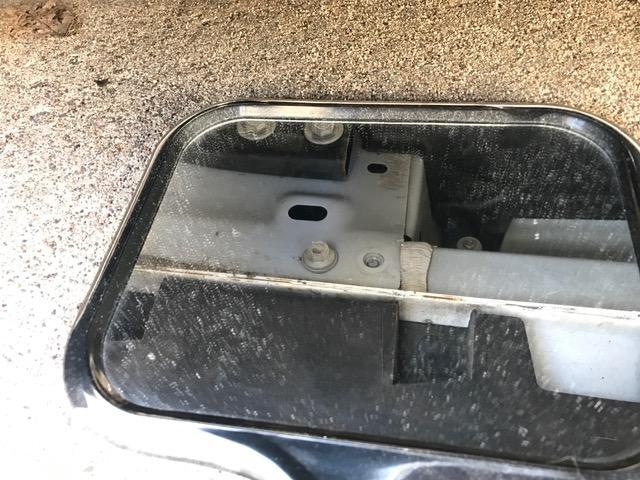

Sheared chassis bolt while installing Steeda Jacking rails. Now what?
