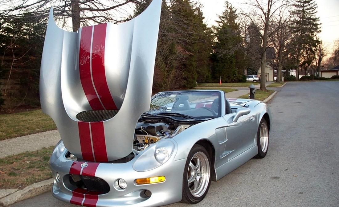

Check out the hood on the Shelby Series 1. This is the direction I would go. IIRC Shelby has a 'Deep Draw' hood similar to this for their current Mustang builds.

More like a tiny, mini-draw, on the GT350 Shelby. I had actually hoped to score the hood louvers from the GT4 hood and fit them to my stock hood. Problem is, the contouring of the GT4 hood is different.
