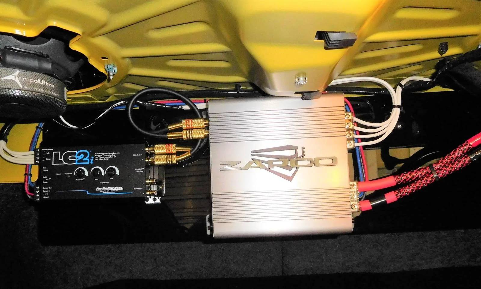

I'll snap a photo of my install in a few days l, I paid a shop to do it.

+1 more for the LC2i. Additionally, I tapped my rear deck speakers by soldering into the terminals from the trunk. It took me all of about 5 minutes to have the speaker wire set up.

I too have the p300-12. It is way more than I needed. However, i first used the high level speaker inputs to the p300 and it sounded okay at lower level volume (8-15) but anything higher it just started to lag or what i think is called roll off. With the lc2i, it completely fixed that problem and does it so well that at 2 on the volume bass "can" be really loud. You just have to set it to where you are comfortable. This is why I wouldn't use a cheap line out converter or high level inputs.

You are correct. The p300-12 does have high level inputs. Our cars naturally have bass roll off at louder volumes so I added the lc2i to alleviate that roll off. if you do not listen to your music very loud and just want some lower end, I would skip the lc2i and just tap the rear deck speakers for the p300-12.

It can if you don't tune it right. What I did was set the lc2i accubass (that's the thing that helps roll off) to the center and turned up the volume to where I usually keep it and adjust there. From there I didn't touch anything else on the lc2i and tuned the p300-12 to my liking.
