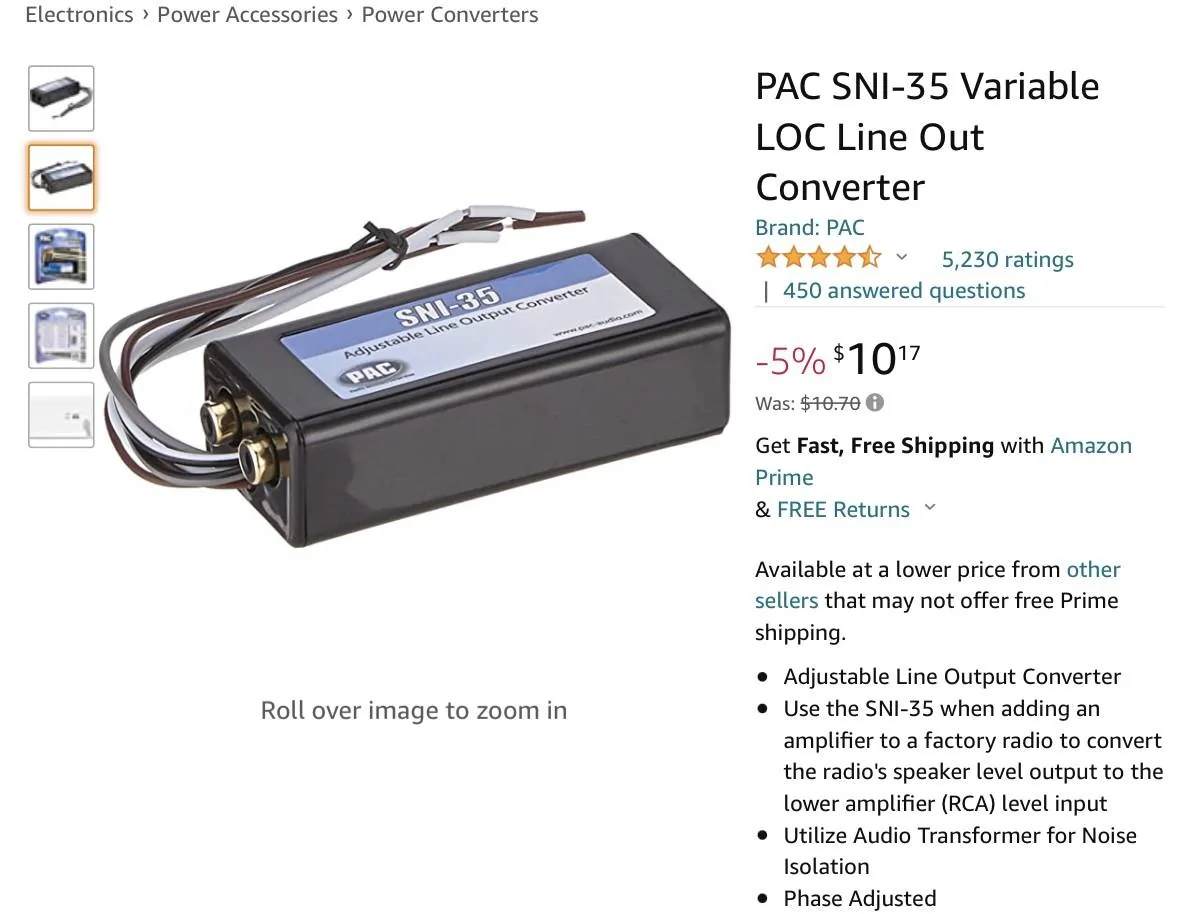

Adding an aftermarket powered subwoofer on a 2020 Mustang premium with the 9 speaker system. I’ve read post after post about this, but can’t come to a conclusion.
I don‘t need competition sound. Coming from a C7 with the upgraded sound just had me completely spoiled. The Mustang has a really bland sound and no low end at all. I just want a little more bass from the system. I also don’t want to spend too much on this.
So am I on the right track?
Under seat powered sub
LOC converter tapped into rear speakers
Disable factory EQ with Forscan
Can it be that simple?
here’s what I’m looking at….anyone have any thoughts? Help? Advice?

I just went through this myself and learned a bunch from the guys on here. Lots of options here. The best method is grabbing the signal preamp. You can by a t-harness. You'll still need a trigger for remote turn on with this method, but it gives you the best possible signal. A TR4 or IGN3 works fine for the trigger.
If you want to keep it super simple, grab a powered sub that accepts speaker level inputs. No LOC needed. No trigger needed. Just power the sub and tap the rear speakers.
