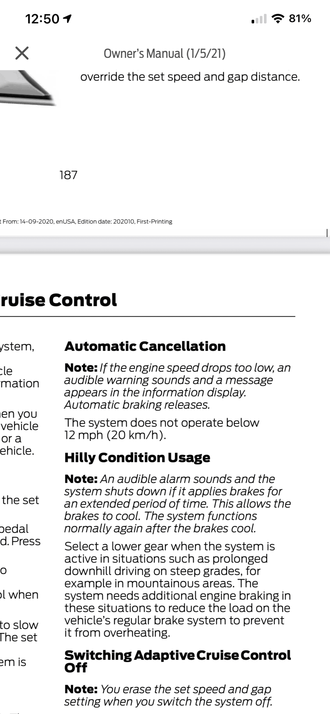

Unfortunately the Mustang wasn't designed with Stop-and-Go, and it seems it must be too difficult or too expensive for Ford to add it. I am sure the S650 will have it. As was said, you cant activate the ACC till 20 mph and it will turn off below 12 mph. Though note, unlike some other cars, if it turns off while braking it will stay on the brakes for an extra second or two to give you a chance to reach the pedal. Our Kia Soul works down to 5 mph, but the instant it turns off it releases the brakes, which seems dangerous.
