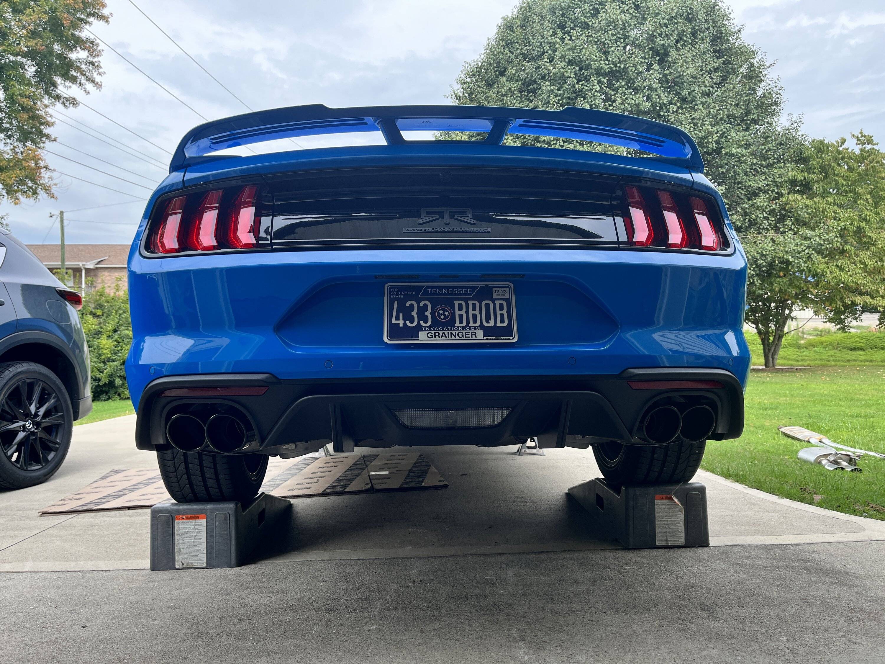

I just did the Borla S type with active. I got the full cat back which has an Xpipe and I couldn't be happier. In quiet mode it is tolerable and opens up considerably when in normal mode or higher. And no drone whatsoever. I am a huge fan of Borla obviously, their TN manufacturing facility is only a couple of counties over from me here in East TN so I like supporting a local business. And the sound is truly amazing, I had a Borla Touring on my Gen 3 Coyote F150 and it was nice as well..
Video clip is of my first cold start after install (started in normal mode, valves partially open)
