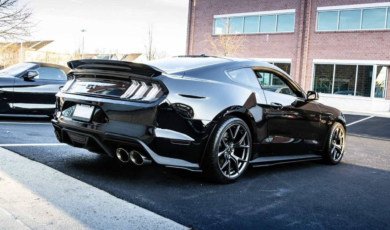

I have a similar setup, GT500 exhaust with H pipe.

Looks great with the bigger tips. Any sound clips? Does it sound like a GT with an H pipe or do the 500 mufflers give it a different tone?

a slightly deeper tone. I think the GT w H pipe in track mode can get raspy where the GT500 almost fully eliminated it.

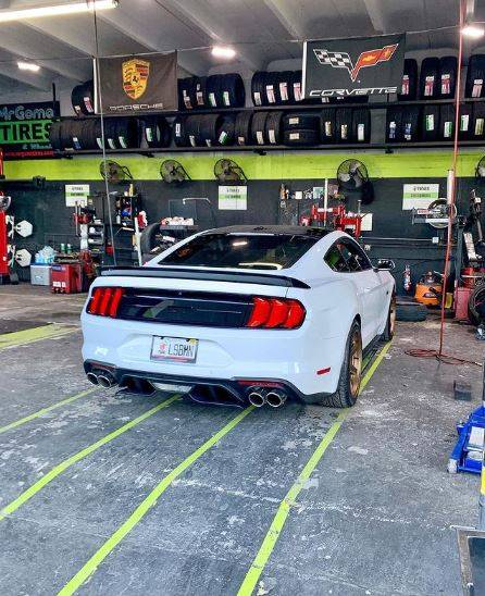

Same. I can care less for any gains but rather for the look of the Mach 1 exhaust. I personally wouldn't want to mimic a Mach 1 by any means. I feel like adding the valence would be too much for my taste. Its a different story if the Mach 1 valence is needed for clearance.
I personally have just slid on some eBay tips for the time being. This was my economic solution. I believe i spent around $100 and sure beats the look of the stock AE exhaust.

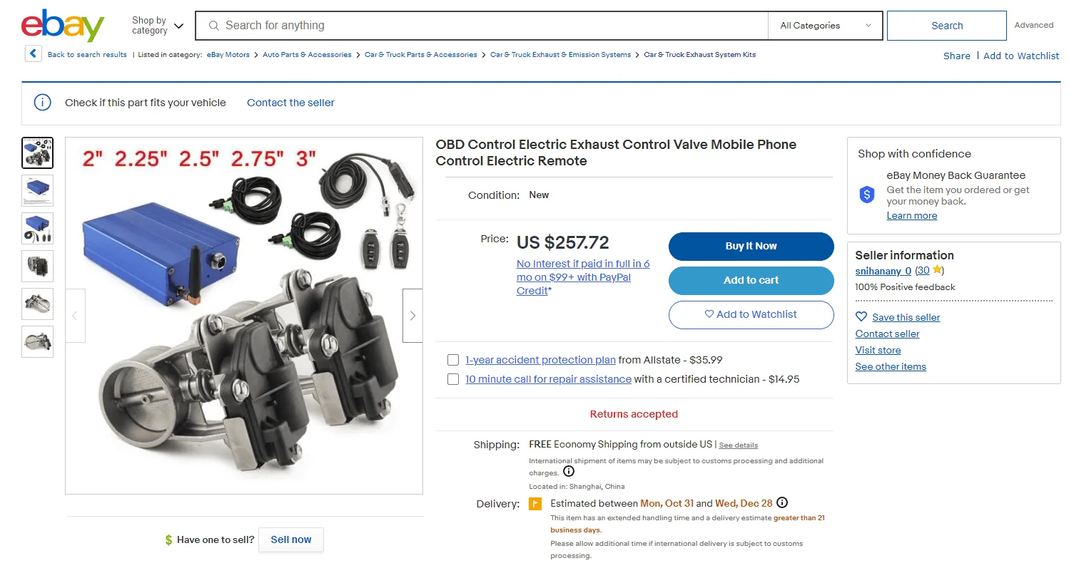

For anyone thinking of doing a DIY AE controller, you should check this out: https://www.mustang6g.com/forums/threads/mustang-gt-active-exhaust-controller-standalone.179782/
Just to add to this, I bought a kit just like this one on Ebay and it has worked perfect for me for more than a year now. The electronic actuators bolt right up to the AE valves (so you can toss the valves that come in the kit), although you'll need to source the springs separately. This kit only allows for two modes, open or closed, if that's all you're looking for.
