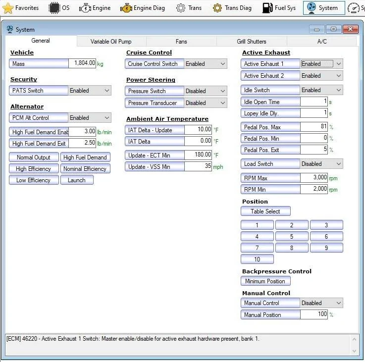

Somewhere, in some thread, someplace in this forum, someone provided a chart showing the opening of the valve according to mode/rpm/throttle. Maybe it was three discreet settings but I thought it was more (thinking is a dangerous pastime). Of course I can't find that thread now.
*Update, found it: https://www.mustang6g.com/forums/threads/2018-active-exhaust-install-guide.101913/page-51
The lookup table implies the valve has many positions, if it really does is another question.

Awesome! That’s actually very helpful. Just looking at the maps it does look like 3-4 max positions so I suppose I do have it figured out as much as it’s being used. I may go ahead with my throttle position mapping. I can see how it could help vs or in combination with the rpm. Thanks for adding that.
I'm thinking you didn't interpret the tables correctly as there are way more than 3-4 positions. The first table dictates which position table is used and the rest show how the position is varied based on RPM and throttle position. Ford felt the need to make adjustments between data points as small as 1%, not sure why they would put that effort in if it didn't really do something.
That xx$ may get used in a function against another variable to determine ultimate position. And the position may get rounded from the final calculation in the controller as well.

I posted those tables and have HP Tuners device/software to view PCM parameters. There is no other strategy other than the tables I posted though I forgot to mention that when in 'Normal' or 'Wet' mode it selects different tables based on current transmission gear. Then, it is based on throttle position and RPM. There are some settings related to idle but that affects only when idling.
Watch this video, it shows the valves, RPM, and you judge throttle position by listening as you watch RPM's. See if it matches up with the tables I posted...
I saw at least 4 distinct positions between open and closed in just a quick view. Tough to judge the transition speeds to see if it is adjusting but having that many positions alone seems to make it more likely to be an encoder system with all positions 0-100% as Mach VII is suggesting rather than a stepper design.

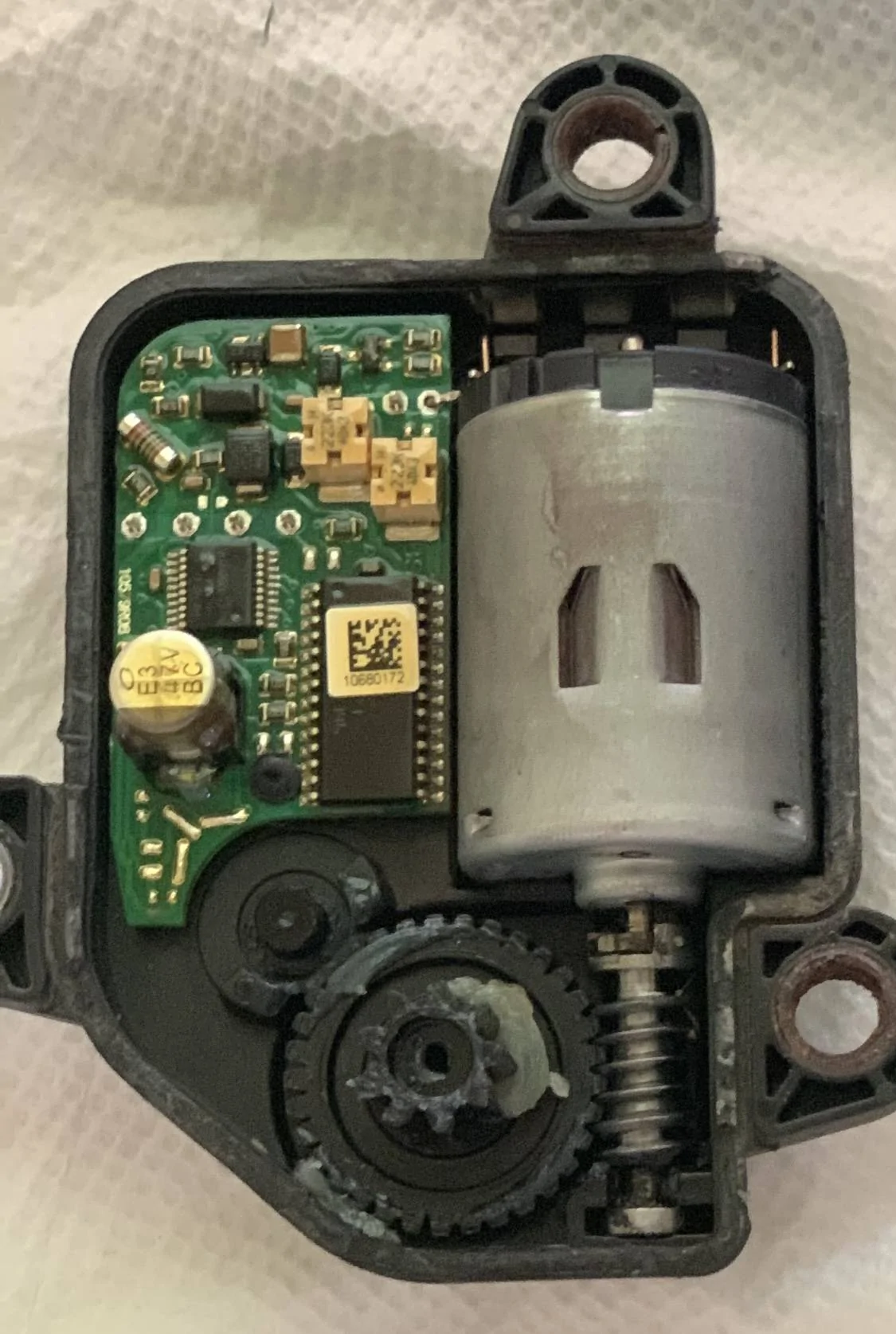

Here is the inside. Motor isn’t anything special and doesn’t look like it has a feedback loop.

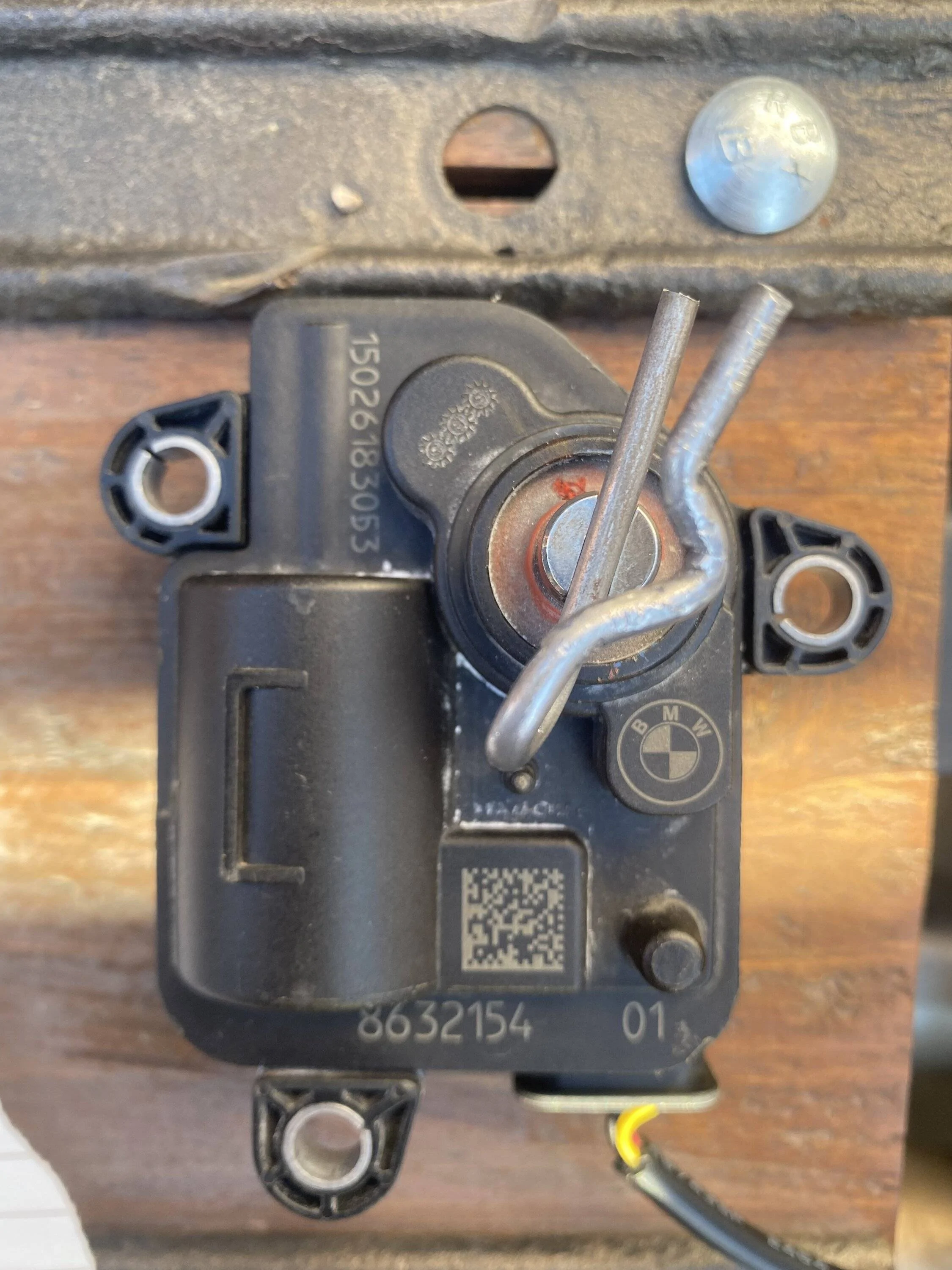

Note-I don’t have the oem actuators to compare, however, from looking up pictures online the below seems to be the case.
A couple of updates:
I was having issues with the valves not fully closing.
1. After much tinkering and having a controller to move positions I realized the BMW actuators do not align with the positioning of the valves using the oem spring. I heard there was guy saying you could use these actuators because they fit but had to “clock it 180”. I opened up and rotated the shaft 180 only to realize after getting it sealed and back together that it’s positioning seems to be based on running to the limit (current spike) and then determine that as 1st position. So, in effect I did nothing but break open the actuator. It reset its positions and I was back to identical directions and positions.
2. I then tried writing different code to invert the position in one side. Still not lining up… in the end was a blessing because that added complexity and additional wiring that I now see I didn’t have to have.

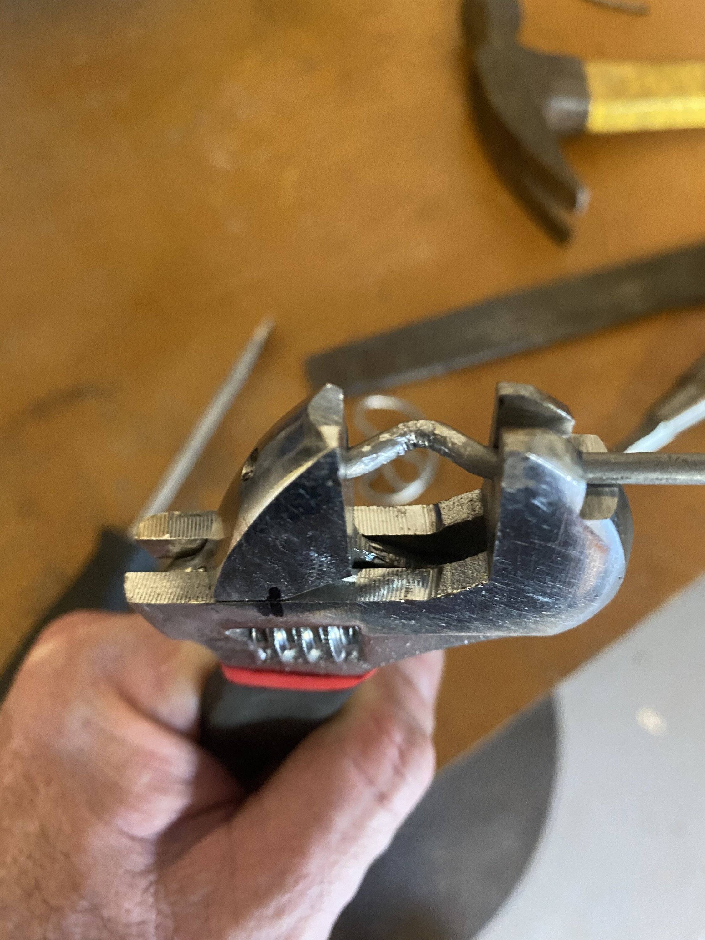

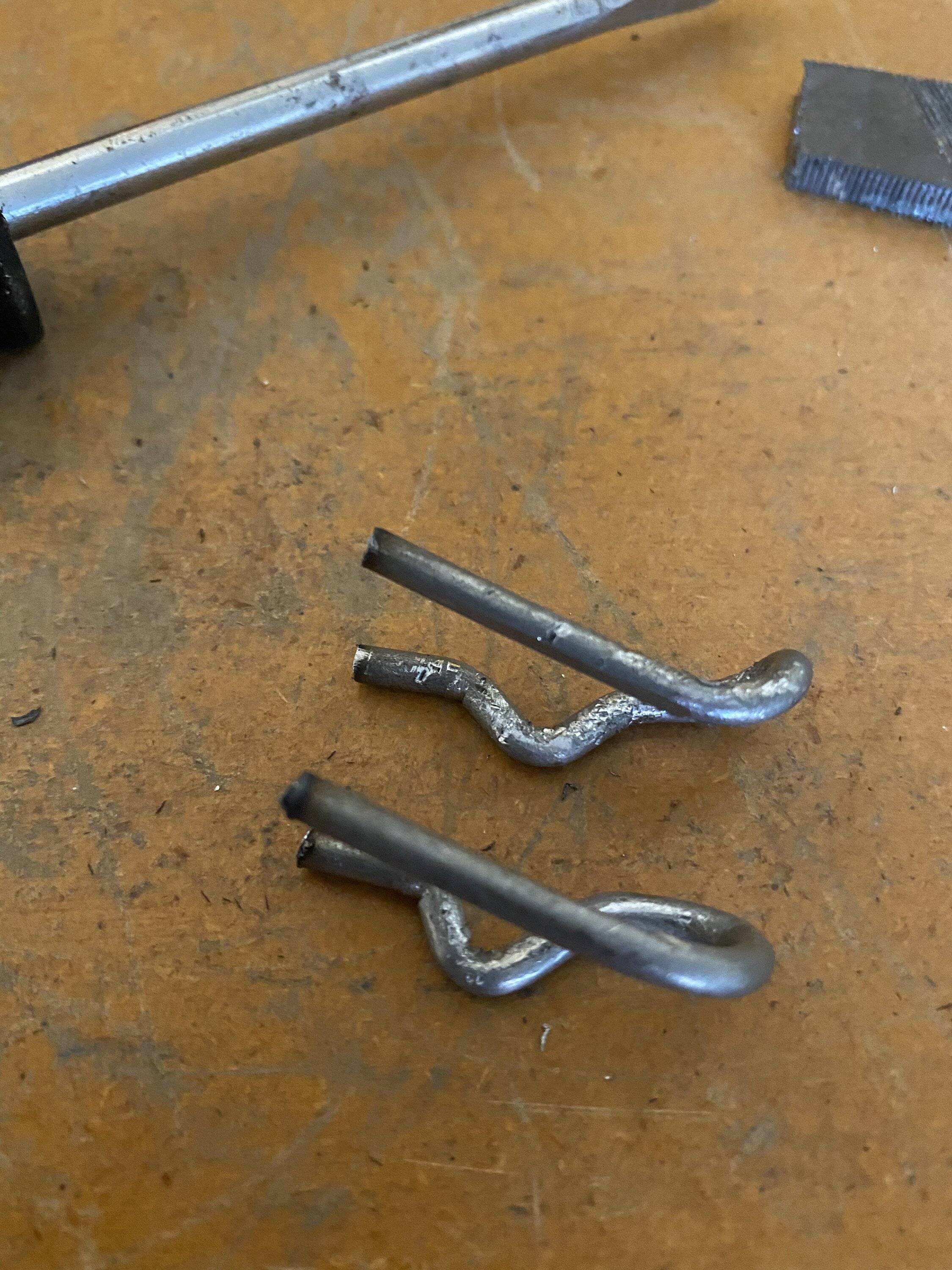

3. Finally out of frustration, I made a jig using an old crescent wrench to bend my own springs.
Success! Both actuators rotate the valves in the sane positions as expected and I have true active exhaust. I’ll continue to tweak the code to adapt for RPM and or throttle position now that I can drive it and see what makes the most sense for my preference. It’s very cool to hear how much difference there is between modes. ( to remind, I have 3” pipes with no resonator).
I’m under the impression that the oem actuators do in fact work differently and it seems that the shaft may have the cut to hold the spring in a 90degree position different than the BMW actuators. This is based on what I found to work and the fact that the springs I made are only a few degrees off to allow correct positions between actuator and valve. Vs the oem spring which essentially creates a 90degree offset.
Anyway, that’s what I’ve found so far. I’ll post some video probably tomorrow of it working on startup
