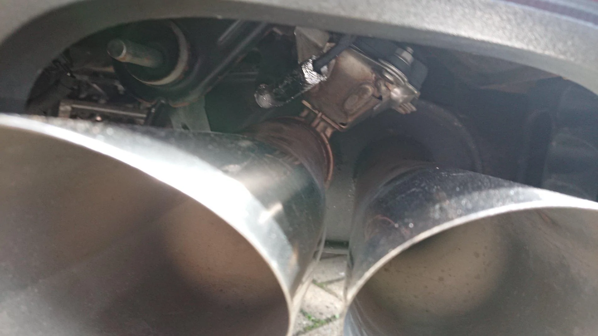

Mine is now installed and is working normal again. Looking at the loom I can see they are well covered now with aluminum type casings for heat protection. I can take a picture is anyone wants to see this.

So here is picture of wires now 'covered' you can see the aluminum wrap around them. Above exhaust.
This is a stock... No mods. Work completed by Ford garage under warranty.
