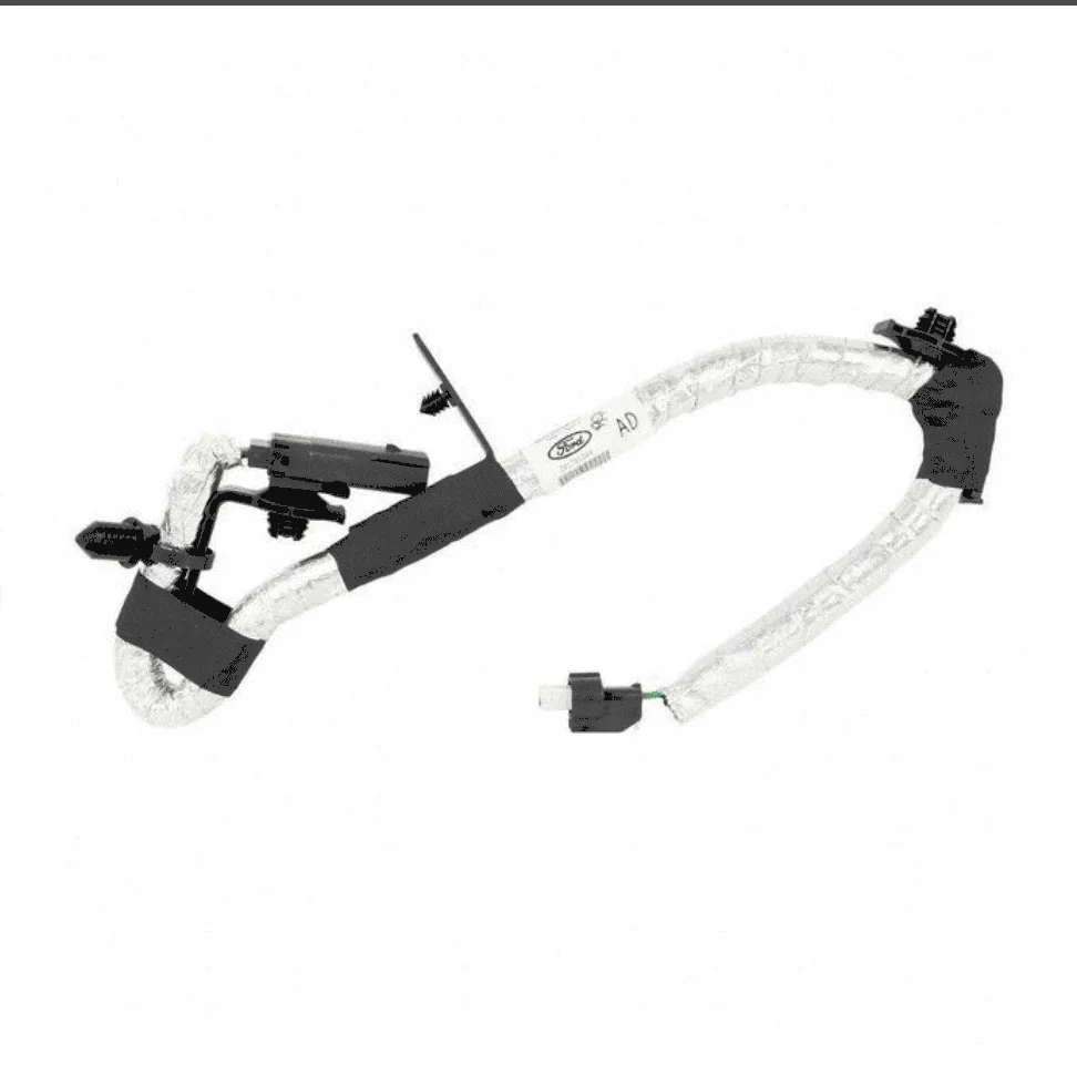

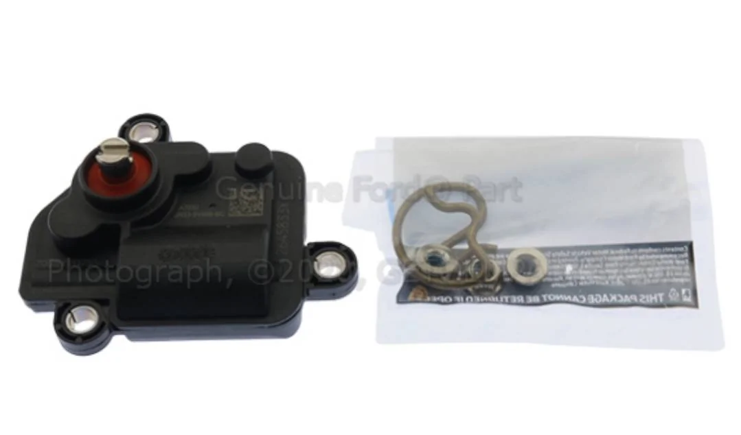

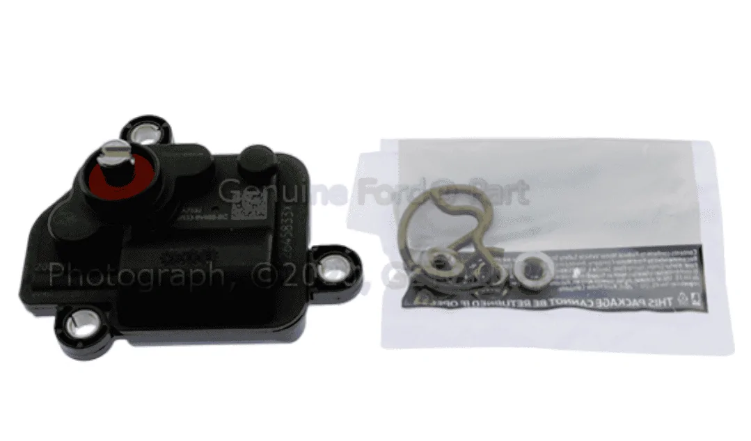

I found this posted by HollowKEYS in February.
Active Exhaust Actuators: JR3Z-5K245-B
And the Active Exhaust Pigtail
harness: JR3Z-14A411-H

Thank you for that, might try the pigtails first

The spring in those actuators are very finicky. Sounds like it slipped out of the notch. I know when I switched out my stock for the active Corsa Extremes, I had a hell of a time getting the damn springs to seat correctly. Right after the install, it would not stay in any mode outside of track for more than 3-5 seconds and then would open completely. It would also tick. Sounds similar to your issue. I opened up the actuators and both springs were not seated correctly. After hours of trying, I finally got the spring to seat correctly. Took me almost as long as the physical install of the exhaust. But once seated in place, no issues since. Been almost two years.

You could try that. That could possibly rule out the wiring harness as the issue, if the issue is now on the other side. But Id make sure to look into seeing if the spring is seated properly and has the right resistance when rotating it if you rule out the pigtail as the issue.
