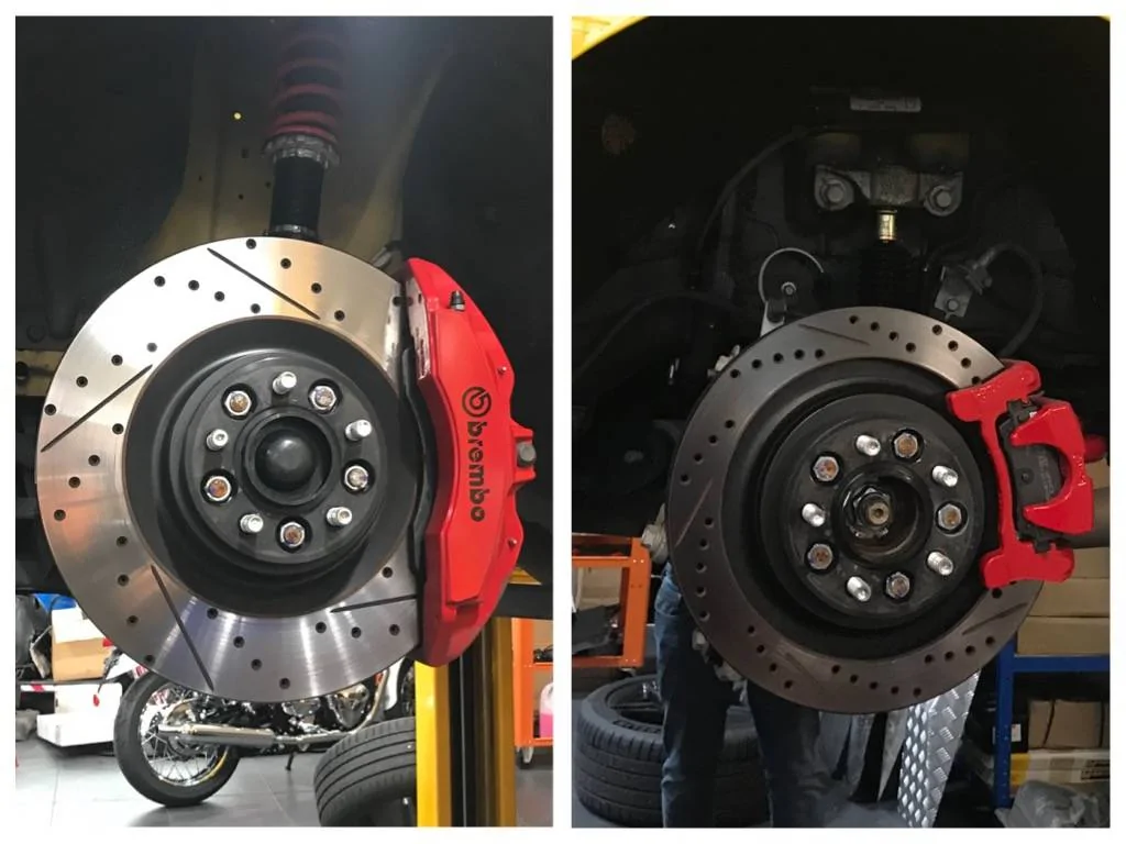

So the smell seems to have gone! Must have been the new Borla system. Im at a loss what discs and pads to buy though. Looked at EBC grooved and Yellowstuff or maybe EBC discs and standard pads.
Benno2000
Feb 3, 2019
201
241
Essex
Ben
2017 GT - TripleYellow \ Black stripes
Good news on the pong gone:like:
You know that this is my idea of brake porn.......:)
Stoptech rotors with Ferodo pads on front and Ford pads on rear.
Although I’d happily have fitted the Ford Performance kit if it had been a wee bit cheaper, lol.
Benno
