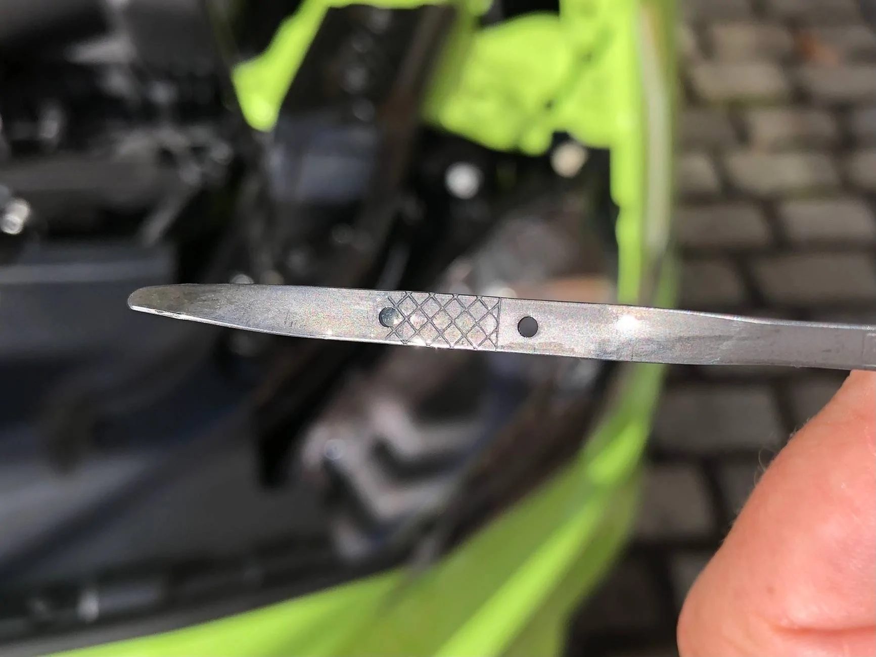

Oil level on a clean stick with new oil (one hash down from the top of the hashing) :

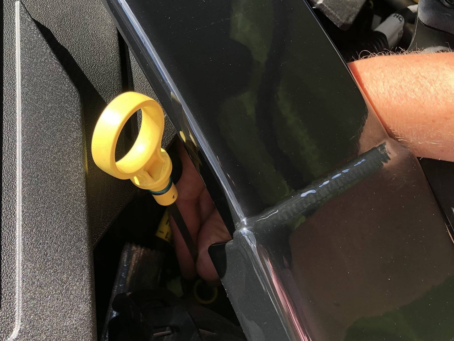

My easy peasy access method :
Don't worry about a solid upper brace blocking the dip stick, it was a pain at first but I stumbled on a method that makes it very easy :
  1. Stand on the left side of the car level with the brace.
  2. Right hand on the right side of the brace, down low just over the top of the dip stick tube.
  3. Left hand on the left side of the brace holding the dipstick.
  4. From the front of the car, point the end of the dipstick under the brace at your right hand.
  5. Feed it down the dipstick hole with your right hand in small movements, maybe 75mm at a time.
  6. Don't apply any force with the left hand, use that hand just to keep the dipstick as vertical as possible and to stop the top of the dipstick from flopping around and / or marking the strut bar.
That method is that easy, it really makes the position of the strut bar a non issue :like:
