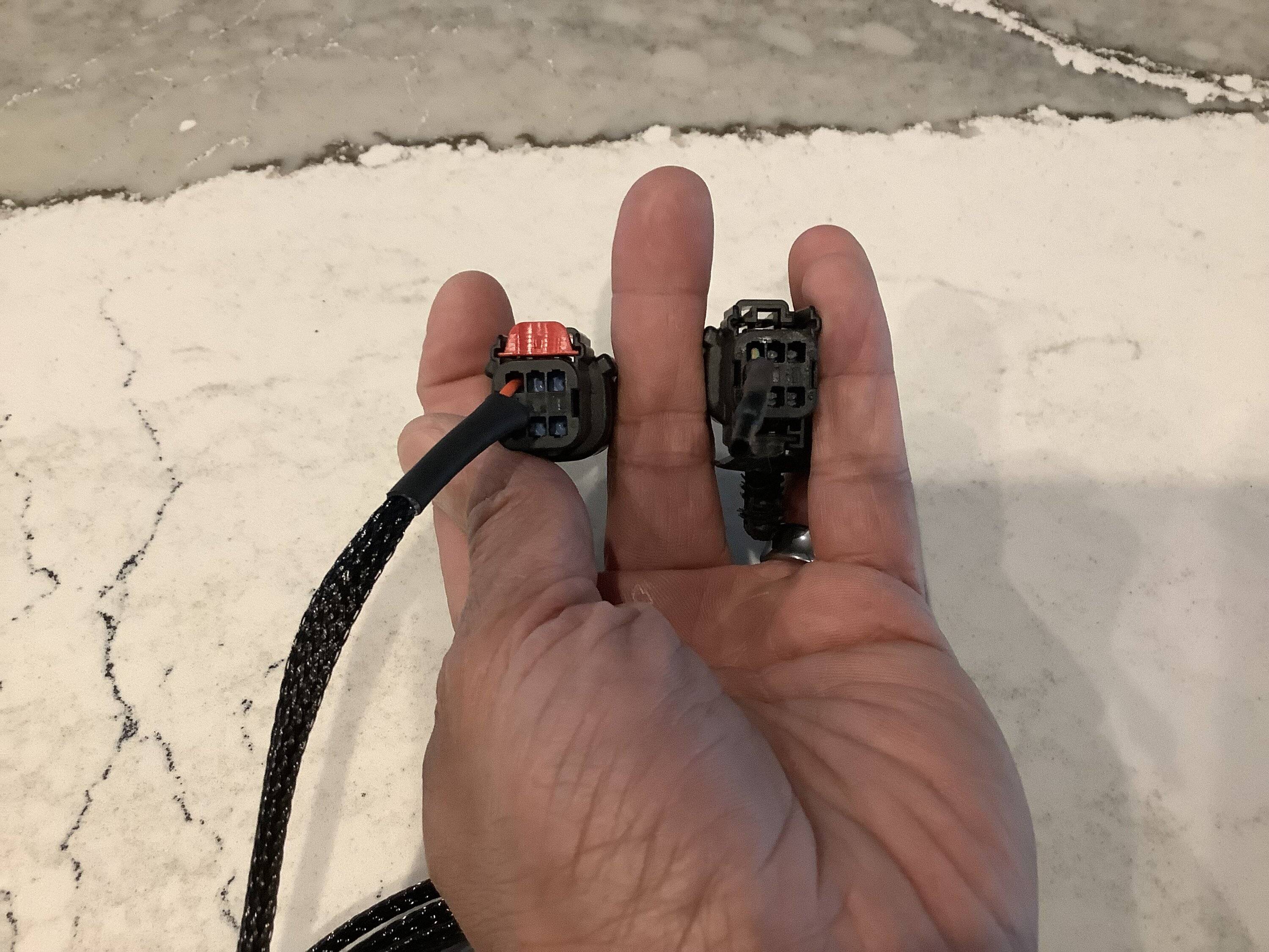

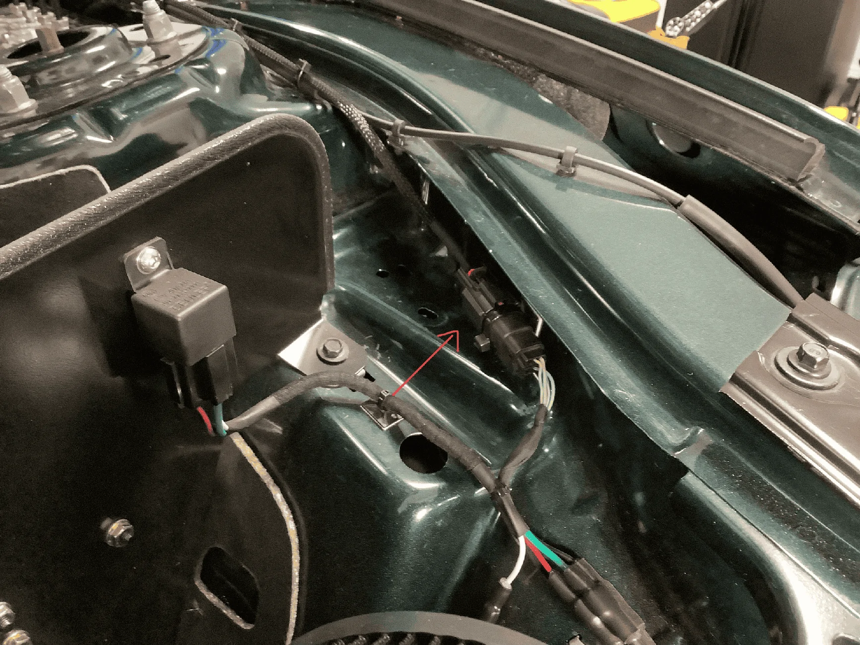

I have conversed with a few members on what it would take to bypass the ABS via the nanny plug, without disabling the line lock feature. Today, I received my aftermarket bypass kit and have confirmed that the wiring is in fact, in the same location on both the factory nanny plug and the aftermarket bypass plug. With that being said and just as others have suggested, one could make their own if they’re willing to cut the loop on their factory nanny plug, extend the wiring to reach into the interior of the car and add a SPST switch.

Exactly. I’ve tested it many times and the downside was, I lost the use of my line loc feature and couldn’t do a burnout without power-braking. I had been looking for a workaround to keep the line lock active, while disabling everything else. I just wasn’t willing to cut my nanny plug, not knowing beforehand whether that was the thing to do. Of course, I and others had suspected that was all that needed to be done, but I could find no one who had actually done it themselves. Now that I have the aftermarket kit in hand, I have confirmed this, which in turn, could save others the $$$ that I spent for conformation, should they want to do this mod using their factory plug.

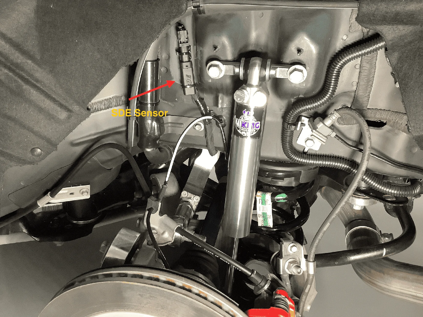

1. I would occasionally get the Suspension Fault - Speed Limited to 80 MPH. This would happen occasionally on the road during normal driving and it also happened at the track on a pass. The reasoning behind the Suspension Fault message was because I removed my rear Magneride shocks and put on KellTrac Ultra Spec Inverted double adjustable Viking shocks. Once I did that, I had to keep the PCM thinking that the Magneride suspension was still intact. To accomplish this, I installed Shock Delete Engineering sensors where the Magneride shocks plugged into the factory harness. This worked a good portion of the time, but not all of the time.
I discovered that disconnecting the nanny plug was the workaround to keep the car from being neutered by the Suspension Fault mode. The only problem with that was, it disabled the line lock and I needed that to stay active.

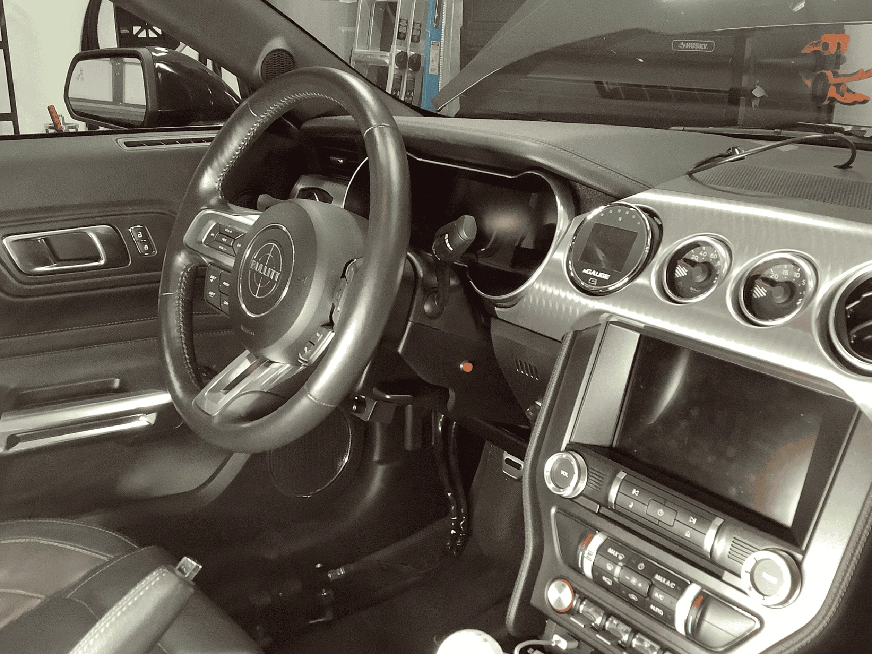

2. With the ABS Bypass Mod, I can instantly enable/disable the ABS/Adv. Trac systems for pre/post burnout, by pushing the red button on the right side of my steering wheel.
