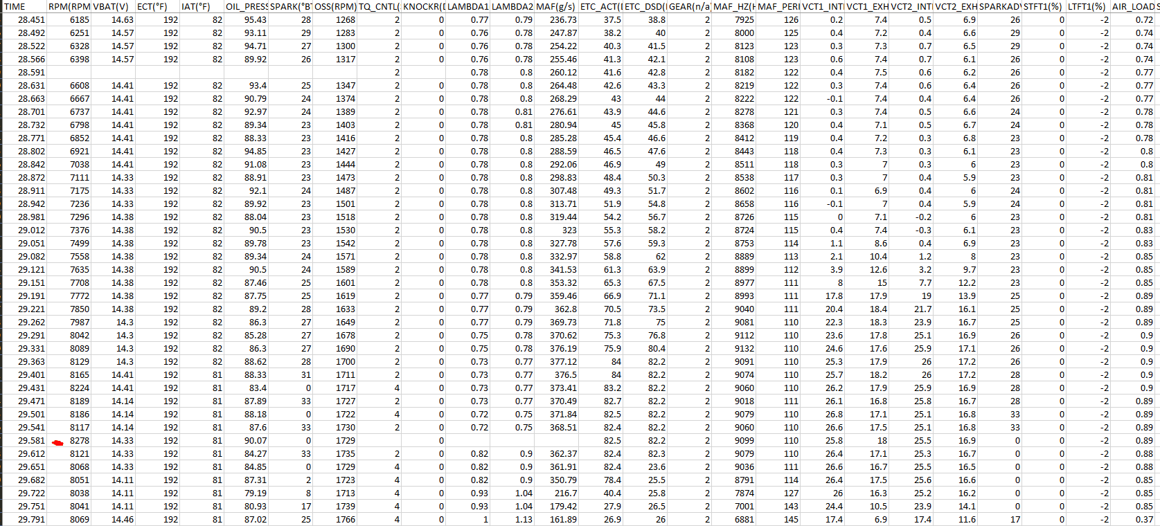

I had no idea what to title this but I have an odd problem.
My car is a 2019 GT A10 300A, I did the Sync 3 upgrade and now have active modes. The car is tuned by Palm Beach Dyno and that's the only real performance mod.
Upon WOT the car will shift and come out of gear but not go into the next and instead of bogging it revs past 8k RPM much like if you had a manual car and didn't lift off the clutch. The car has no codes. I sent a log to PBD and got a revision but it didn't help. It does not do it every time. I am usually in Sport+ or Track mode. Is this how the traction control and advance trac work? If so that's not how it was untuned.
Has this happened to anyone else? Is this a mechanical issue like clutches or valve body?

Looks like PBD messed up some torque tables.. again. But for S&G's try a WOT in 'D'.

Put it in drive and go wide open throttle from say 40 mph. But don't kill yourself in the process. it should go through all the gears and it will shift at about 7500 rpm. If it does, the PBD messed up some tables.
