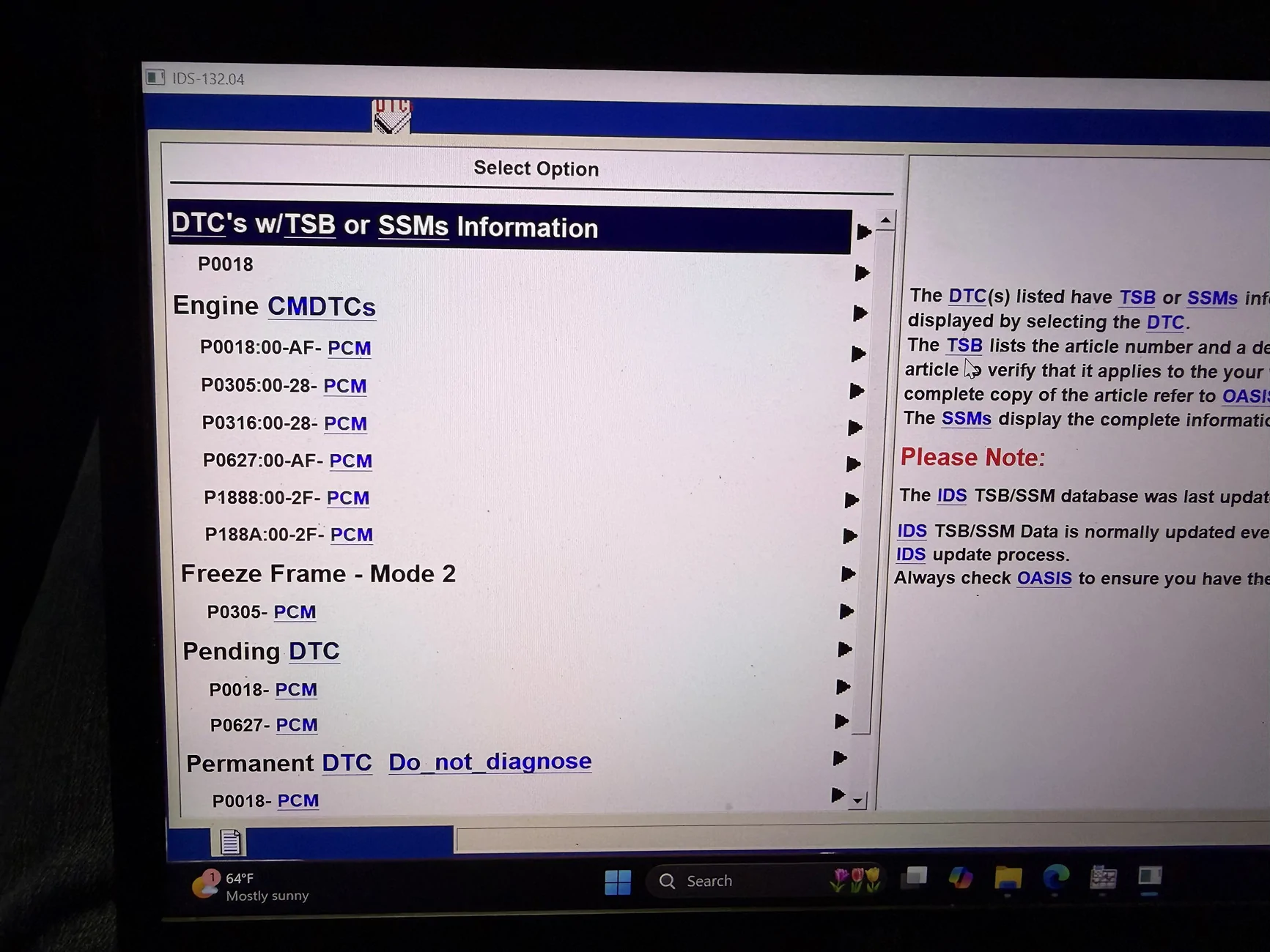

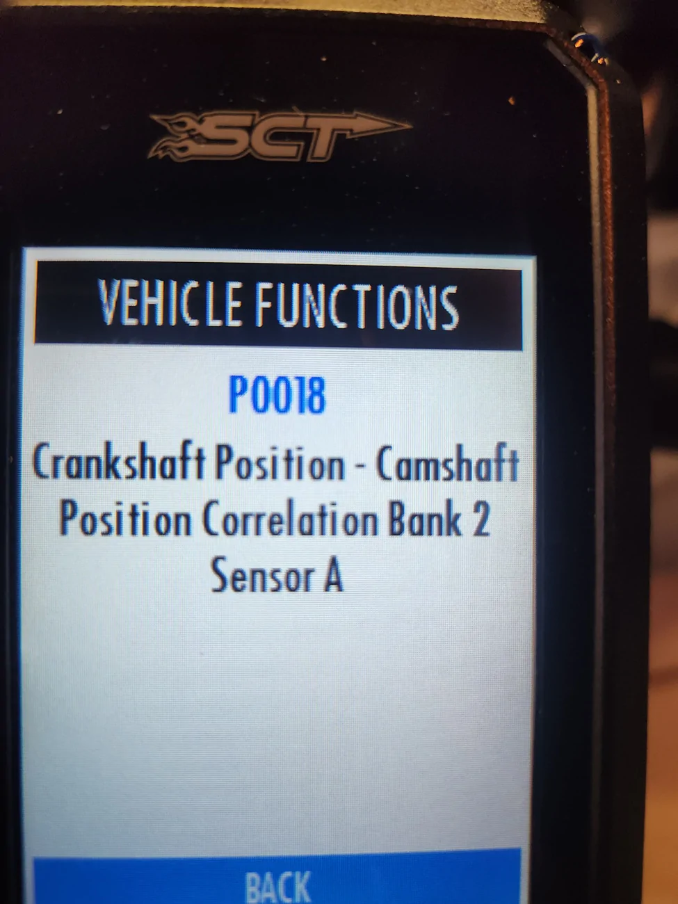

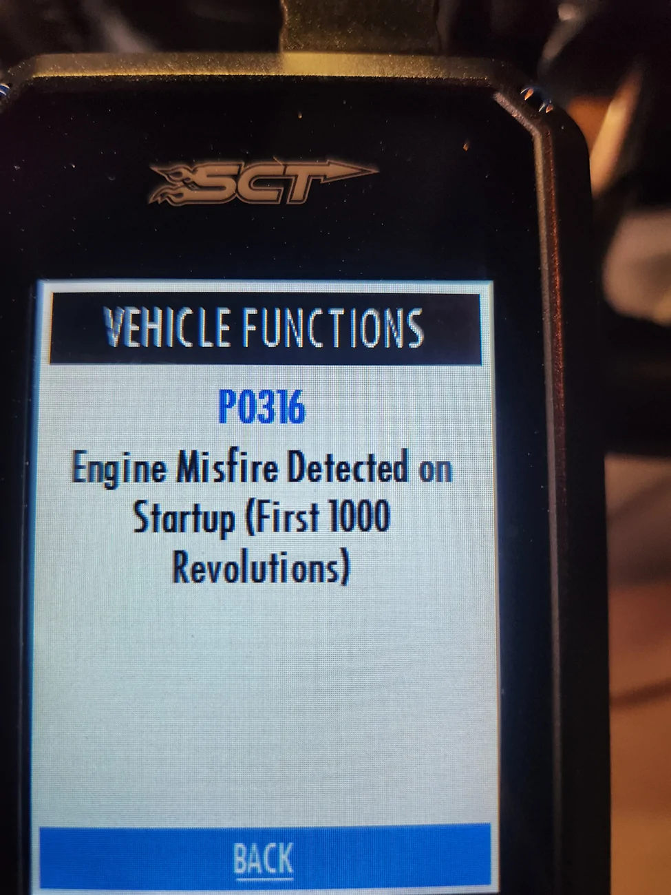

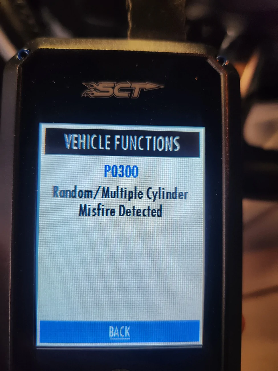

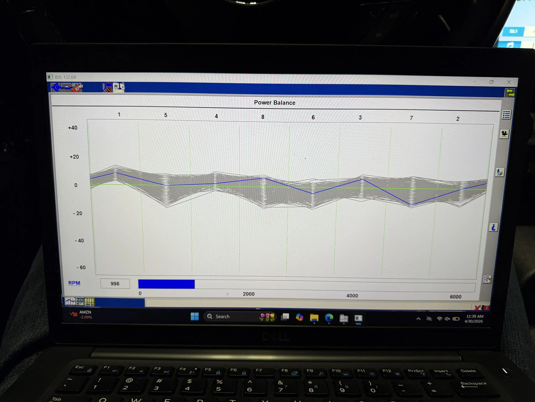

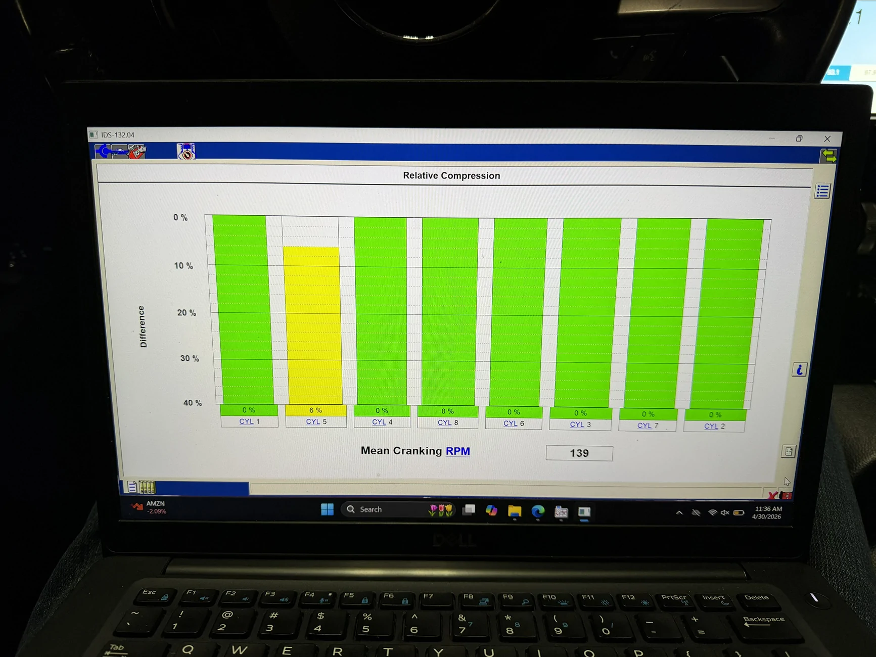

Let me start this post by saying, I believe the shop had the best of intentions and based off of their analysis, I understand where they are saying what they are saying. They may, in fact, ultimately be proven correct. But...
They ran a static compression test and cylinder 5 is down apparently 6%. They did a cylinder balance test and all 4 off the drivers side cylinders are off. The drivers side exhaust cam is 16+ degrees out and the drivers side intake cam is off by 11+ degrees. He suspects that there is piston to valve contact and at this point the engine needs to be replaced. He did not do a borescope view of the pistons. He felt like it was a foregone conclusion that it wasn't worth tearing into it and wasting my money, which I can appreciate him thinking that way, especially if he proves out to be correct.
That being said, the shop I had it at that got it running seems to disagree and I am friends with the owner and shop foreman. The shop foreman was the one that figured out the issue with the solenoid and got the car running better. He actually DID do a borescope just before I took it to the last shop and he said he looked at every piston and there was no evidence of any piston to valve contact.
I am taking the car back to them and they are going to pull all the timing components off the car and start fresh, set the cams and timing again. We'll go from there. I may be throwing good money after bad at this point but I have to try before going full new motor again....dammit.

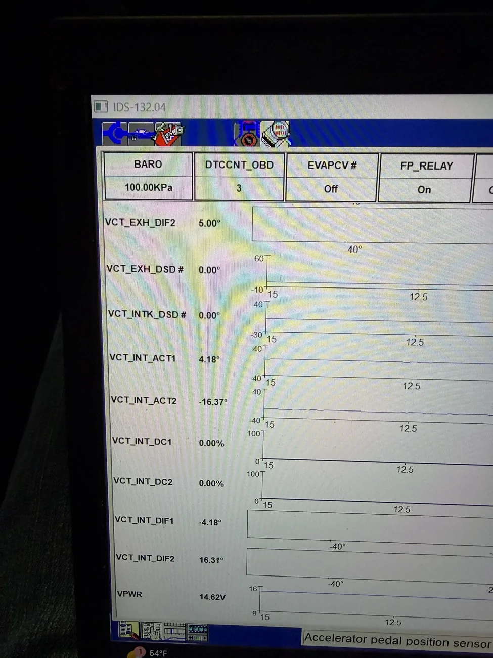

Arrhhh. That’s no fun Jason. It does look like you are 1 tooth out , which would add up to the degree’s you are showing. And as far as I understand your still with in the range on a gen 3 that you won’t have piston to valve clearance issues. If your 2 teeth out then your in the danger zone of contact.

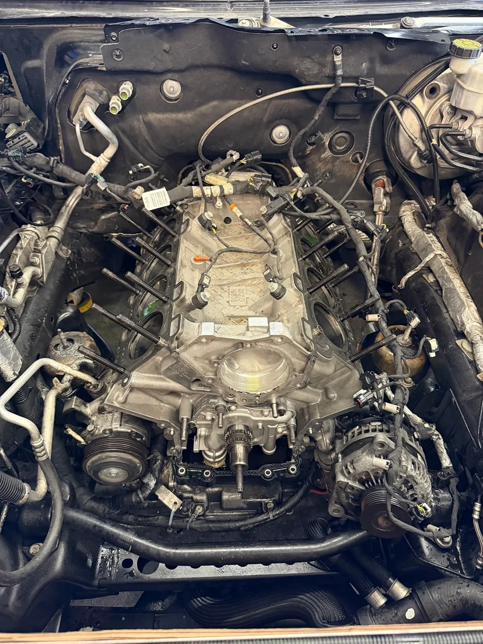

They have had it running decently, got the cams oriented properly, replaced a phaser and all the cam correlation codes are currently not showing up, but there are still some issues. I spoke with the shop foreman on Saturday at length and he is very puzzled. They had it running good and had done the crank relearn, but decided something wasn't right (I can't remember what) and so he decided that he was going to remove the tune, update the firmware on the PCM and then reload the tune, which he did. The car was running fine but there has been a distinct tapping/clanking noise, NOT the coyote tic, that has been annoying me. It sounds almost like a collapsed lifter in an old push-rod engine.He thought that changing out that phaser had fixed the issue, but after the firmware update, it came back. Hes been chatting with Wengerd about possibilities. Not sure how he got to Wengerd other than the owner of the shop is a friend and he bought a Mach1 last winter and I was encouraging him to go with an ESS G3X set-up and to use Wengerd so there must have been some contact with him at that point. He is trying to get the noise issue figured out, then he wants to put it on a hub dyno that he has access to and have Wengerd remote in and dial the car in.
That all being said, I feel like this engine is probably on borrowed time. When I had the low oil pressure issue from the PBH metal pan conversion, I am thinking I may have damaged a bearing or two and that noise is from that but who knows?
My current plan is, as soon as the fundage is available, I am going to have ANOTHER long block built and swap it out. I have my original block and crank still, and another set of 2019 heads sitting on a shelf in my garage. I just have to get it all together and over to the machine shop. I am tossing the idea around of just building it back with stock pistons and rods, freshening up the bearings and what-not, and putting it in like that. I know plenty of guys making the power I want on stock bottom end set-ups. The idea of "over building" this engine was good in theory, but has turned out to be an absolute nightmare in reality.

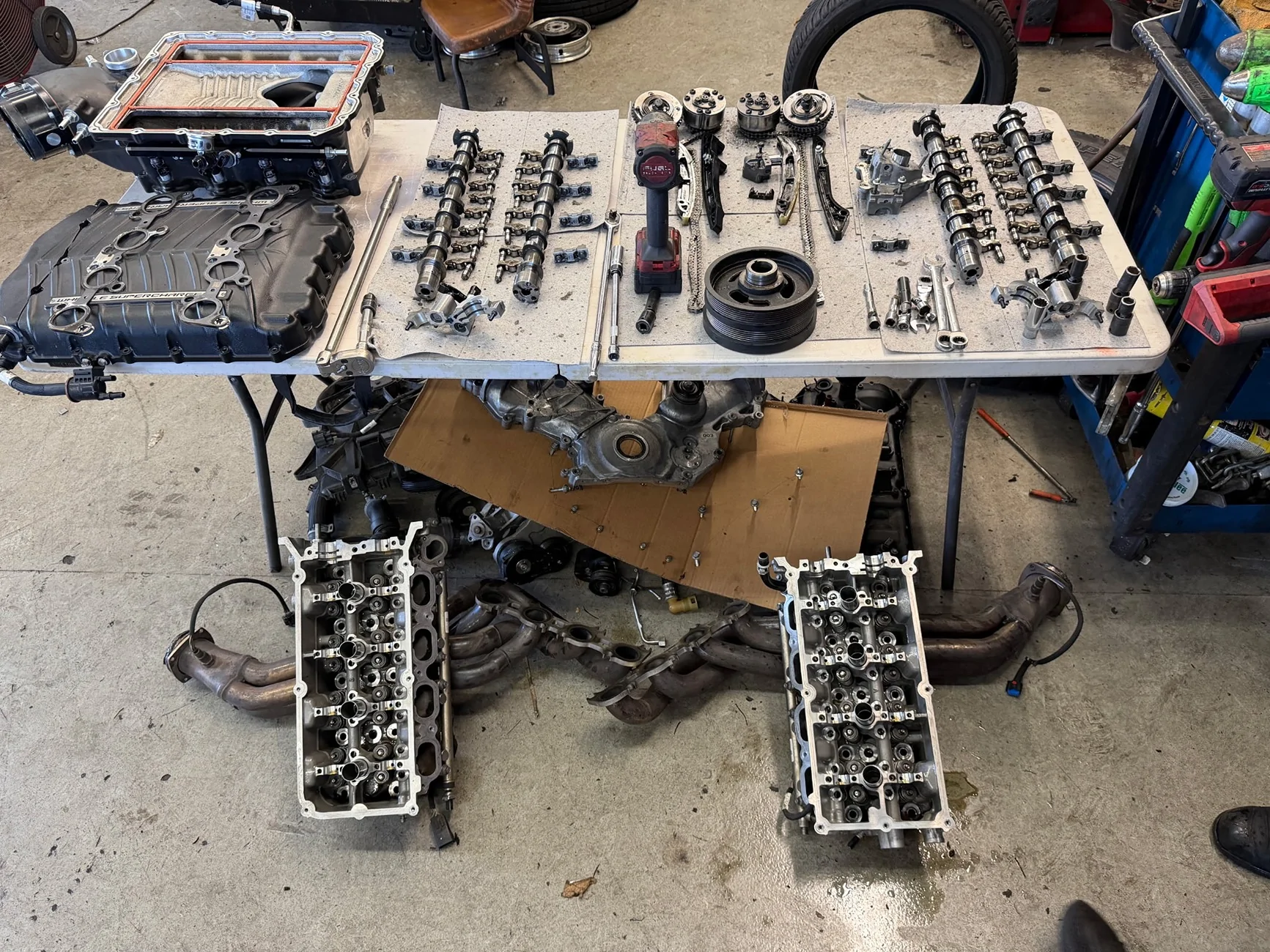

Car has been running but still very poorly. Cam phasers keep locking. Have put new solenoids and phasers on it again. Runs good for a little while maybe 20-30 miles, then a phasers will stick. The last time it was the intake on passenger side locking at about 25 degrees retarded. Won't clear.
Sending the heads out to get hot tanked, cleaned and checked. Taking the oil pump and oil pan off, blowing compressed air through all the oil passages on the block to get any debris in them out. The cam phasers and solenoids keep jamming up. I am assuming their is sediment in the oil passages from the metal shavings when the old heads disintegrated. Trying to avoid a whole new engine. Probably going to end up being that anyway though. Good news is no evidence of piston to valve contact. We will see what happens when we get it all back together again. 🤞
