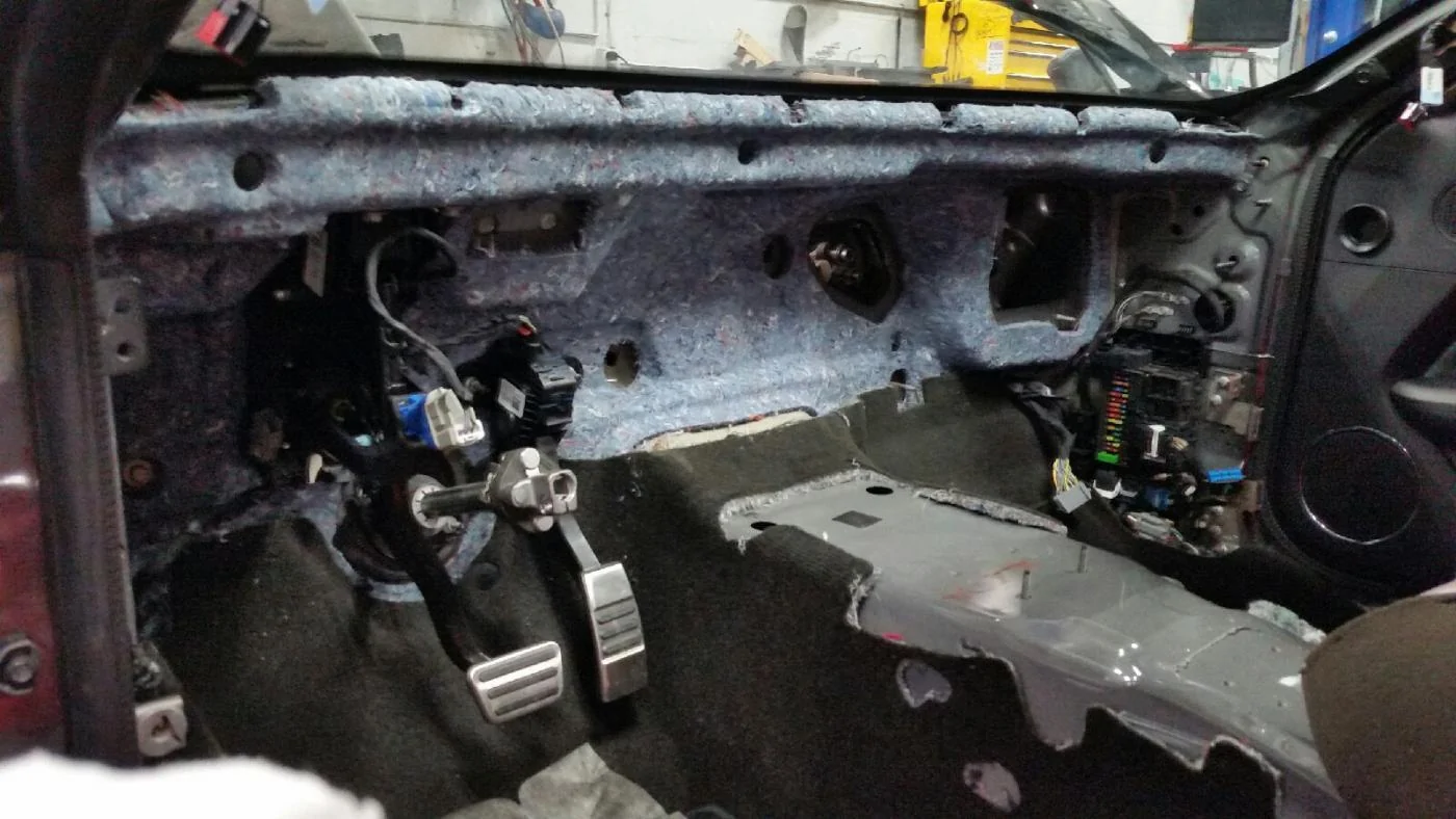

My Ford dealer replaced mine. Had the car for two days and gave me a Mustang loaner to use that only had 650 miles on the clock.
The tech did an excellent job. You can't tell that anything had been taken apart. A/C working fine again. The service writer sent me a picture of the repair when it was in in progress with all the dash and console parts, etc. out of the car.
Can't say how relieved I am that everything went back together like it came out of the factory.

Yup! Here's an image I snagged from another thread from Need4Speed15. This is a 2015 mustang. Having it done on my car now :frusty:
That's ridiculous. Hopefully i can just buy an ACPRO and get it fixed that way
