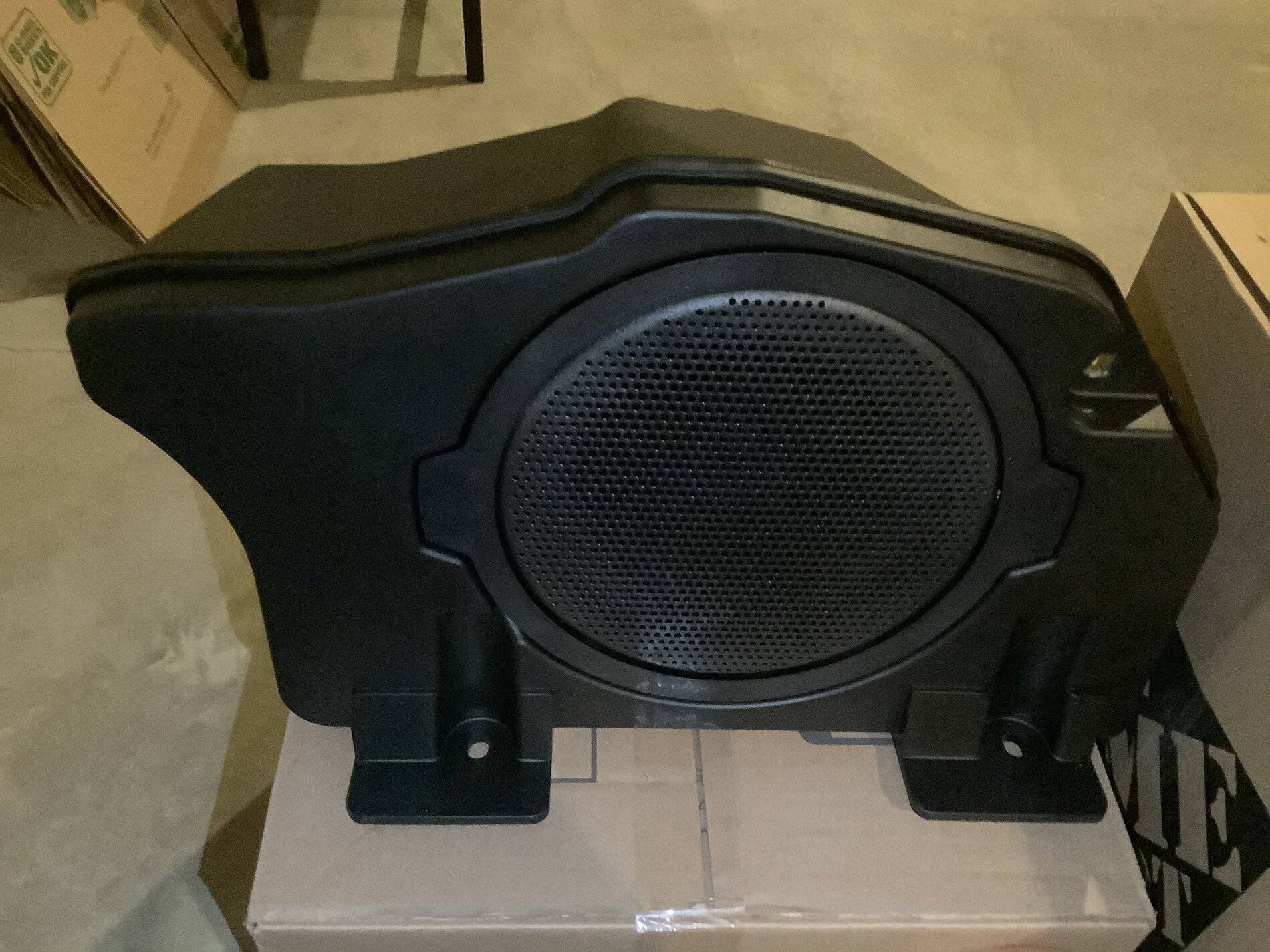

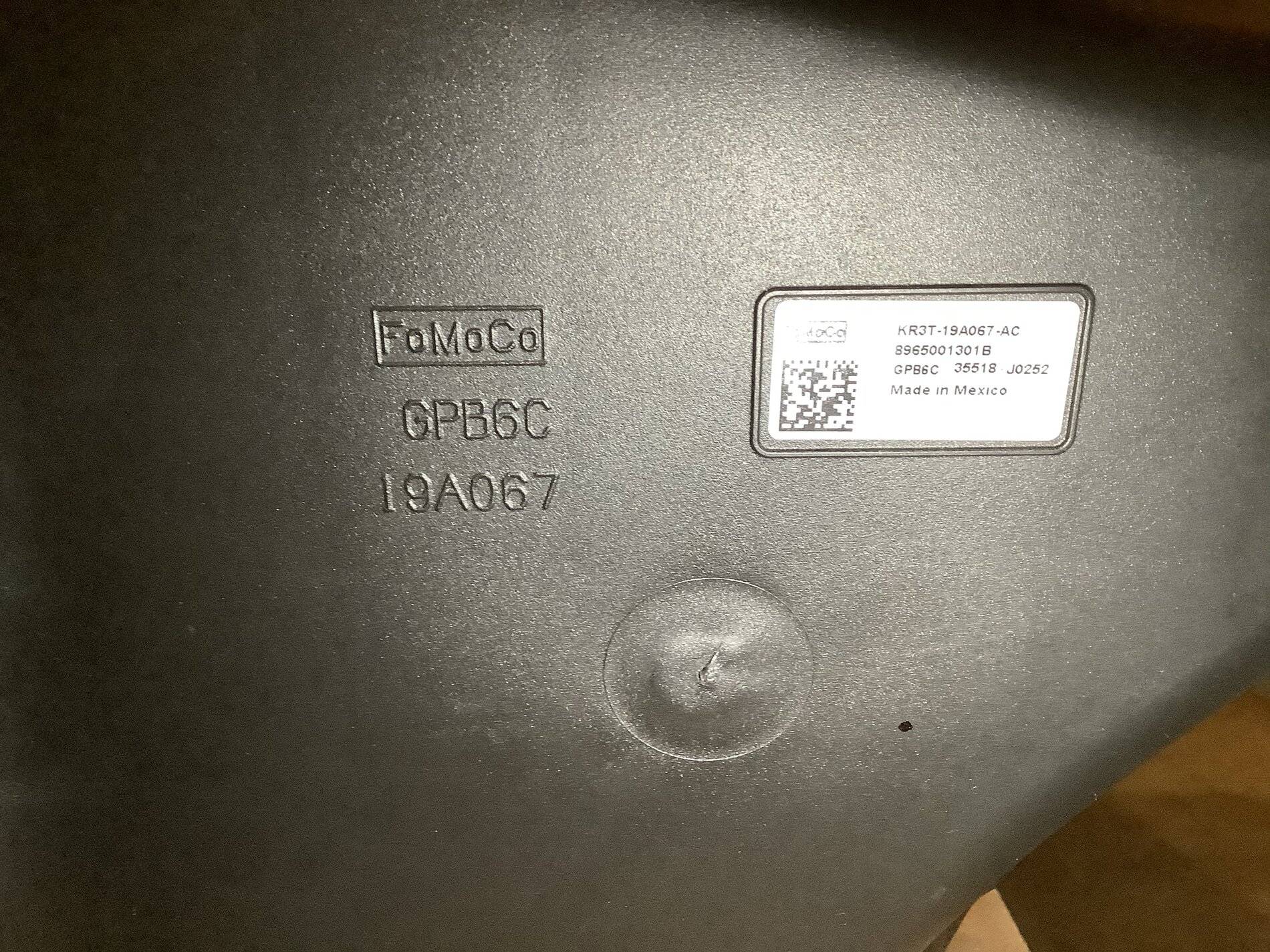

Are you set on the Shaker sub, or will the B&O sub work for you too? Let me know if it will and I’ll get you a part number off of my B&O that’s sitting in my basement

Thanks Yes, the B&O could also work...

Excellent, many thanks.
May I ask what you installed in stead of the b&O?
No problem. I have the JL Audio Stealthbox which has a 12” sub in it. I’ve got more boom, boom than I’ll ever need now. LOL
