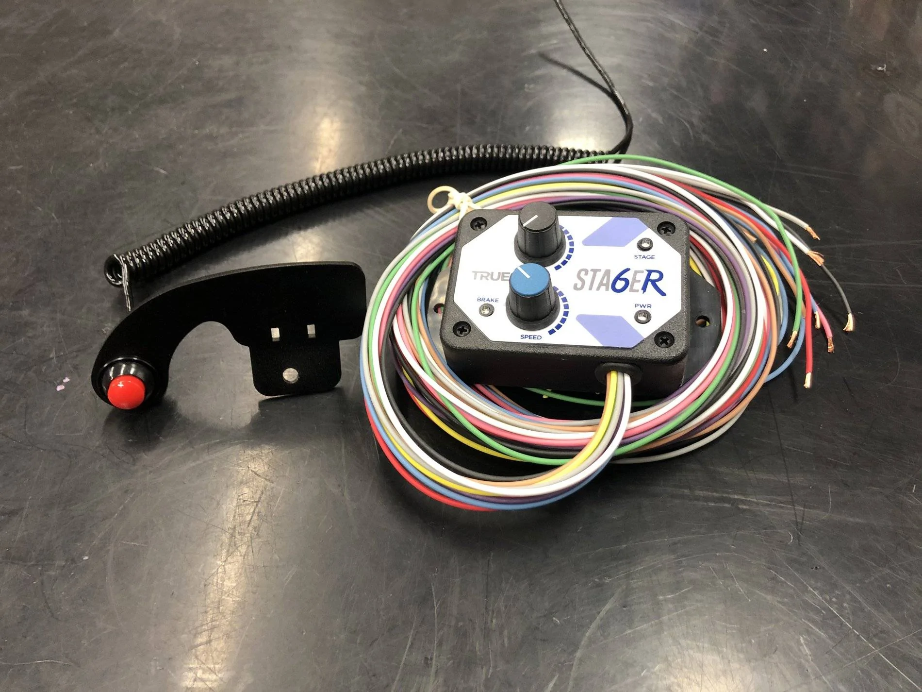

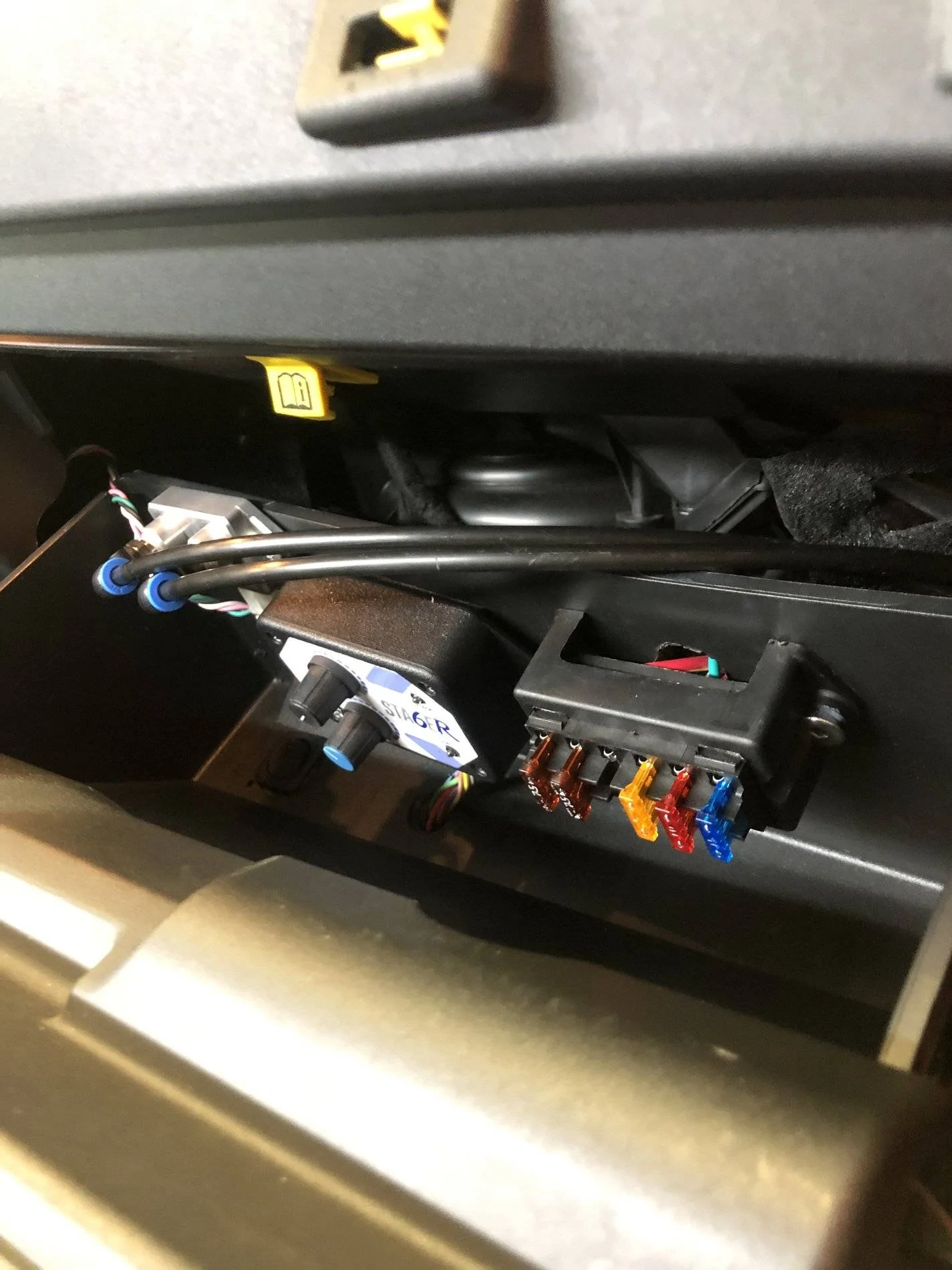

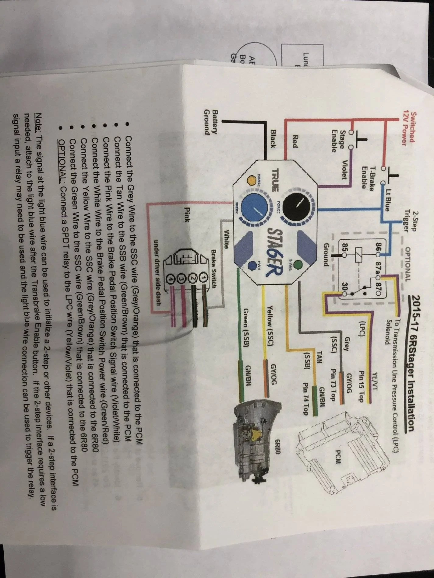

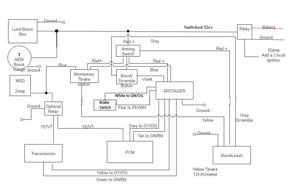

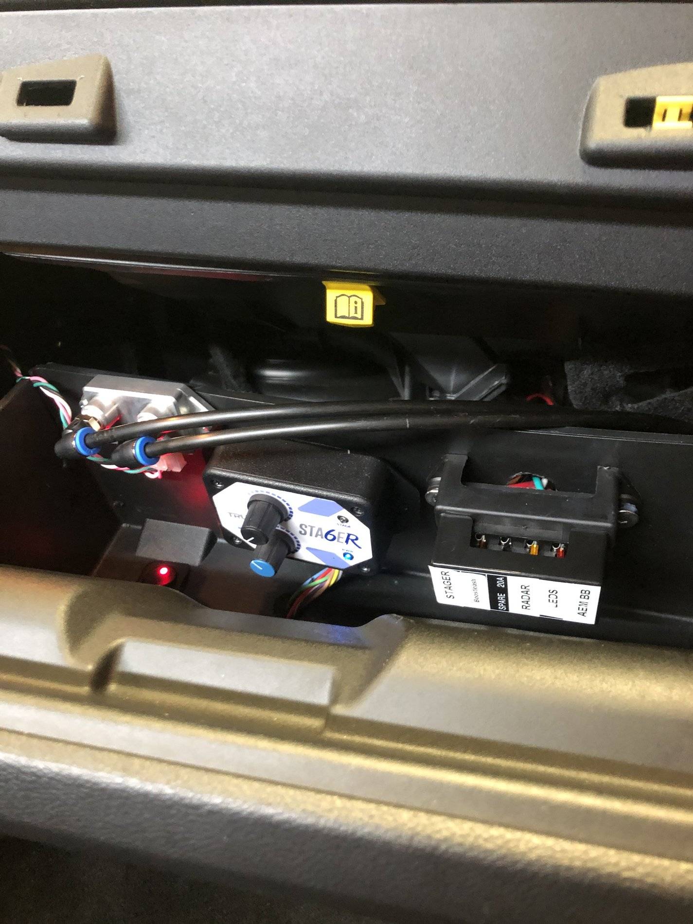

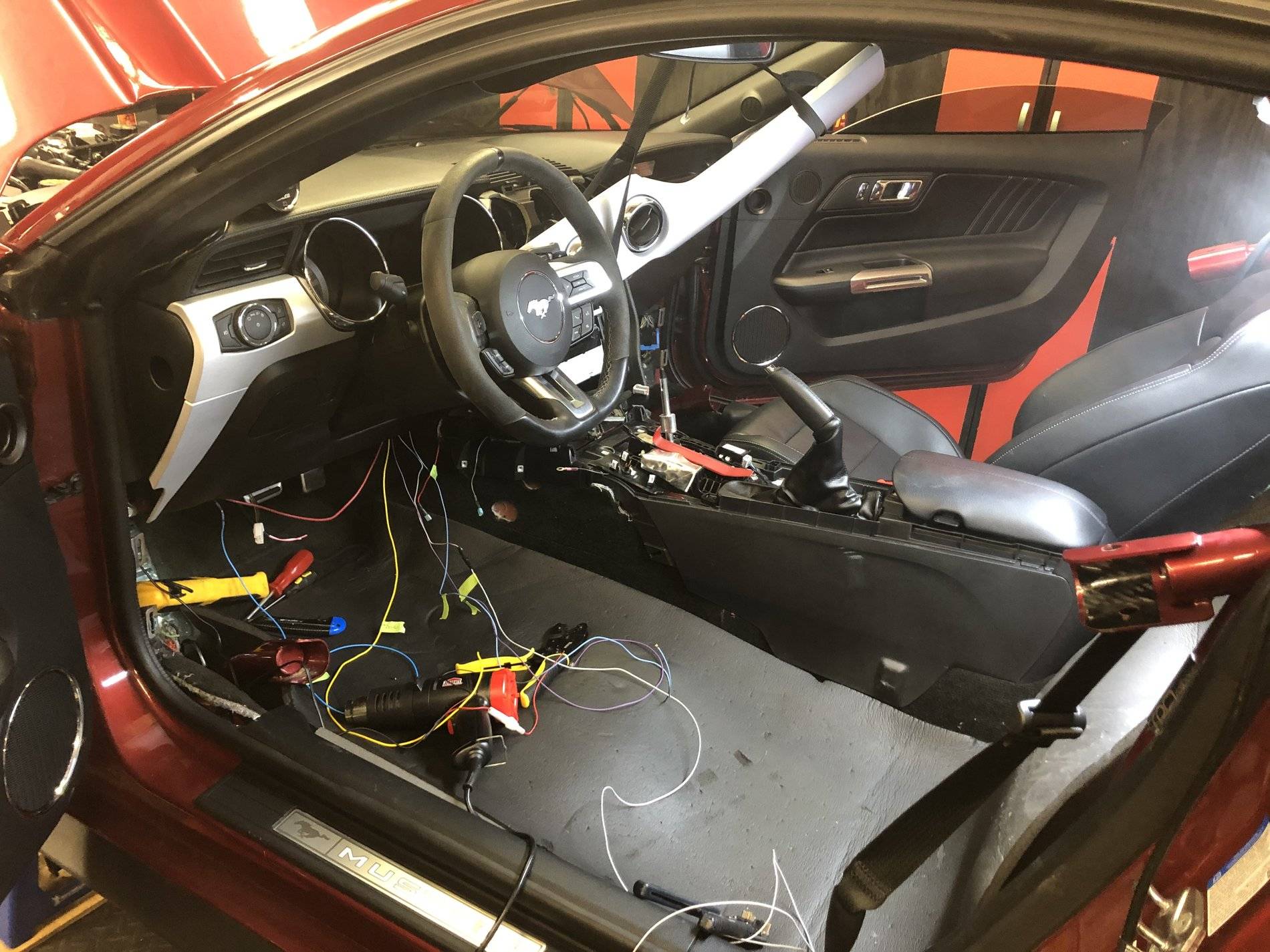

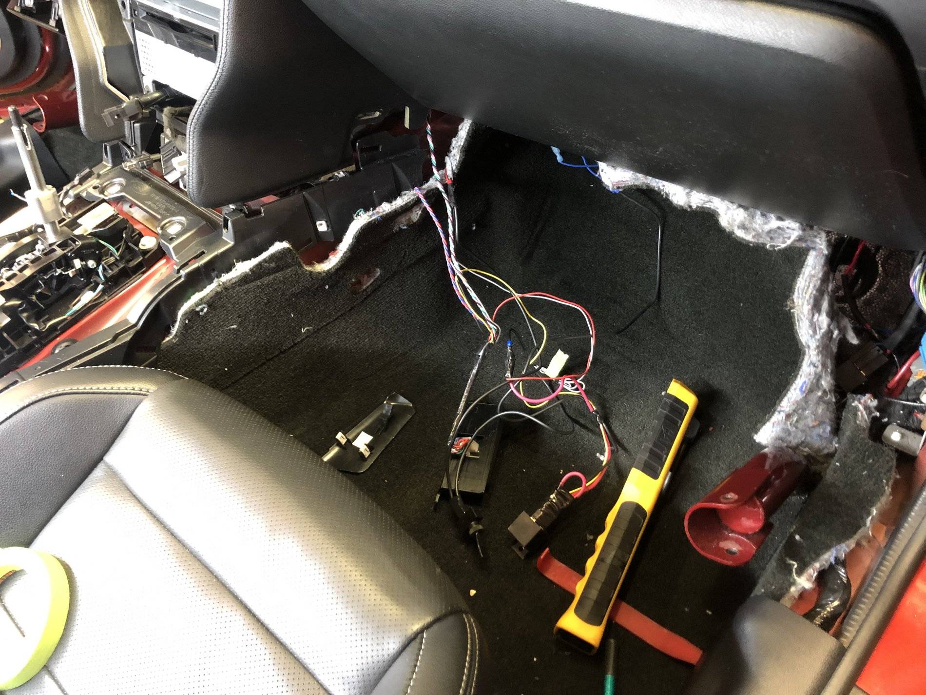

Well guys I just did the 6rStager install in order to add a bump box and to replace the dual relay trans brake that was in this car. I also didn't like the way the Boost Leash controller and MSD we wired so also did all of that. So many hours drawing up plans and trying to figure out how I wanted it turn out. Also added scramble and bump on the same button using a relay. Turned out pretty good I'd say! :)
