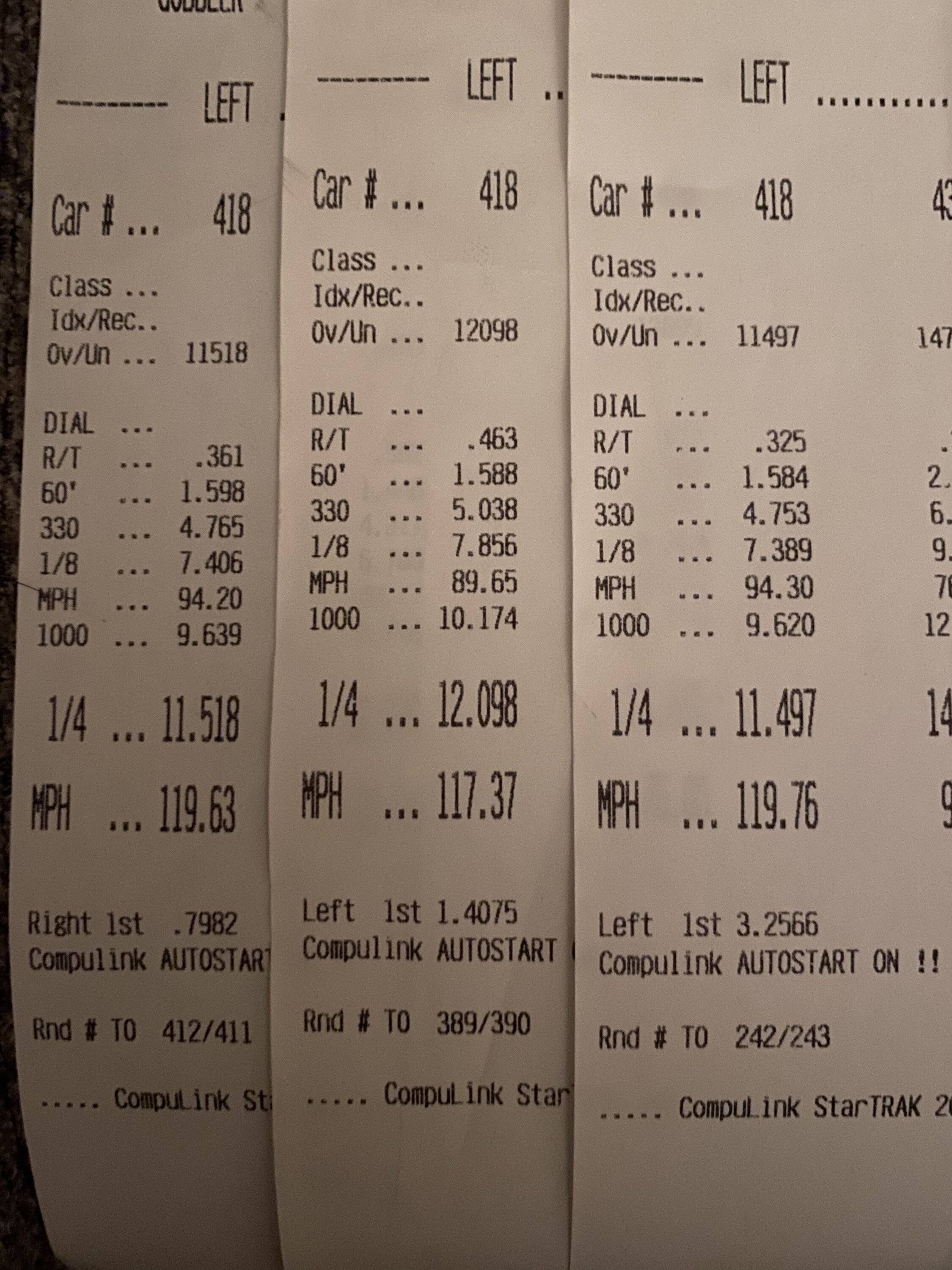

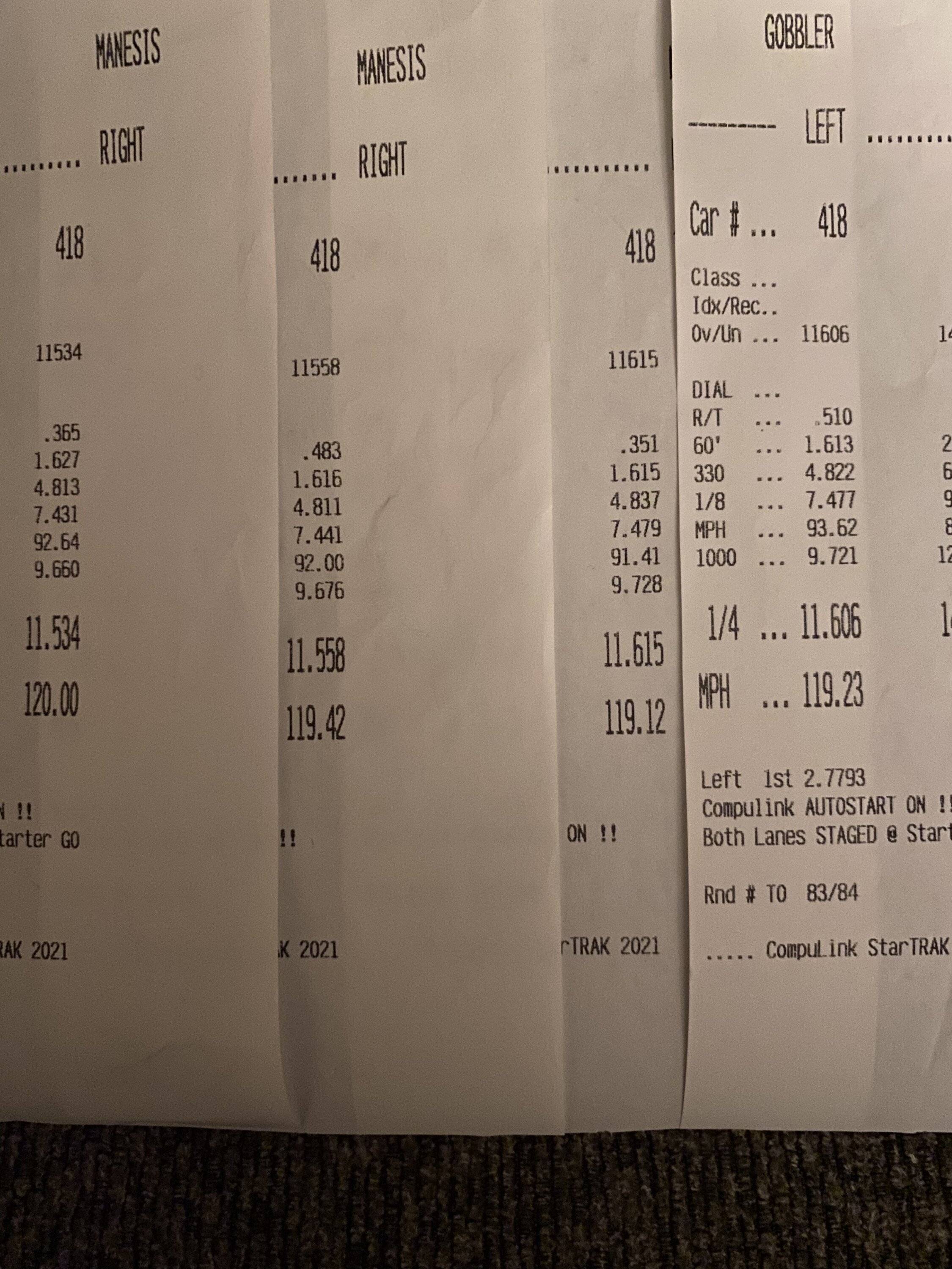

Update - stock struts viking rear best settings 12c16r tires 15-16 psi to keep from breaking traction on the 1-2 shift. didn’t get to try lowering pressure before smoking my clutch. believe the video is of the 11.60 run before getting everything dialed in and it spin about half a rotation.

Good hook on the line @ GLD. I still think there’s some 60 ft. magic left in the 9-12 psi range.

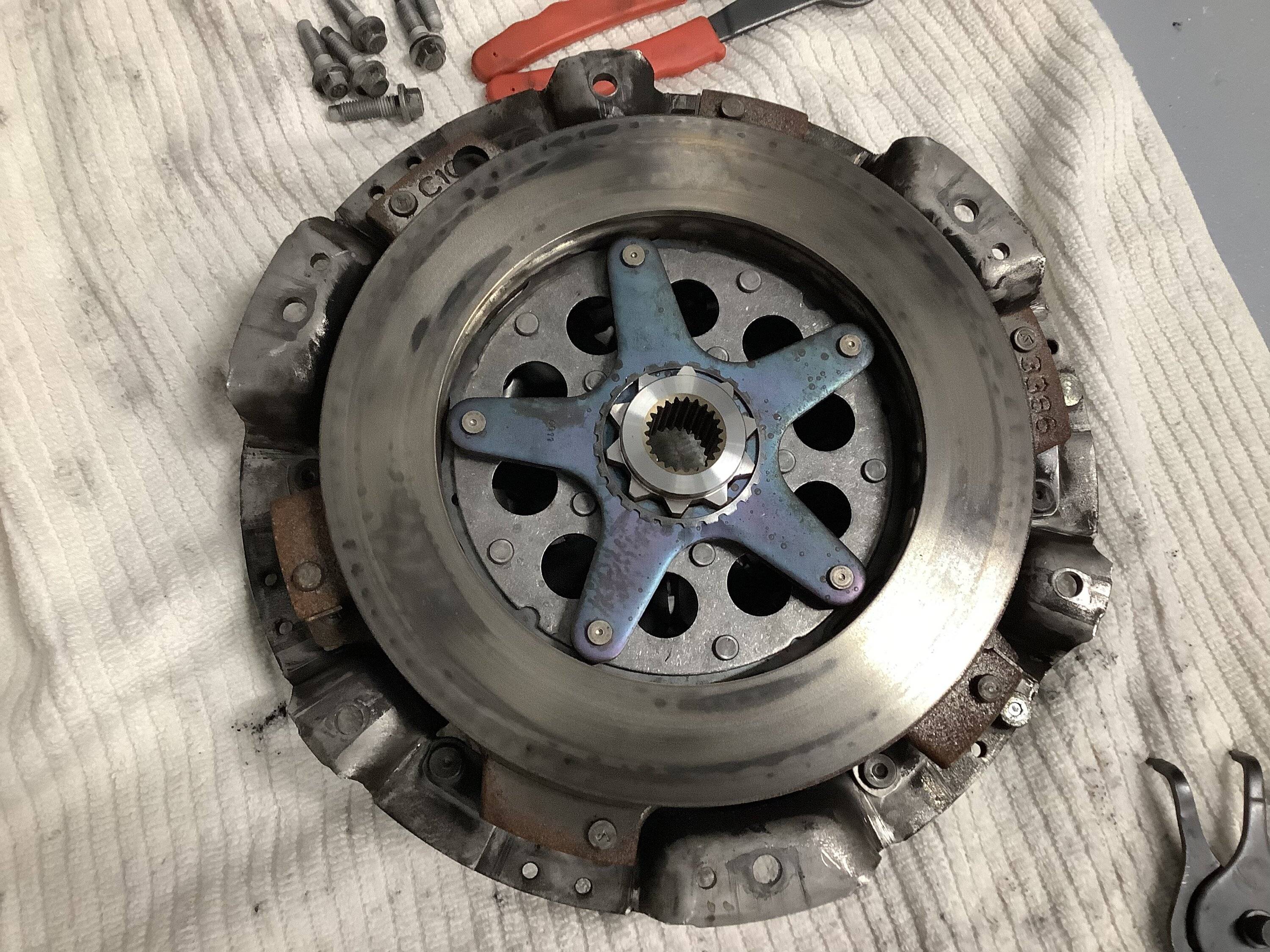

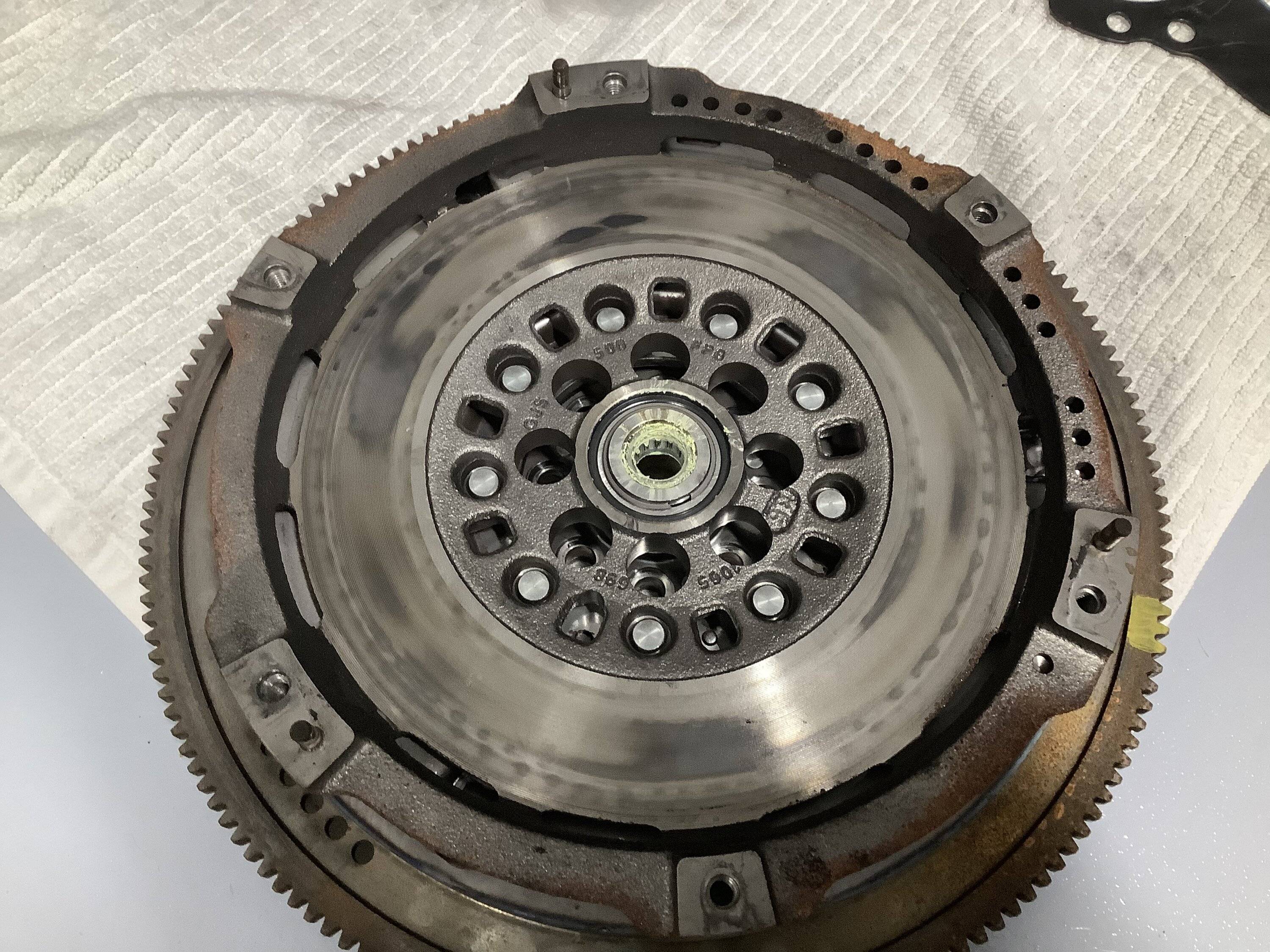

my intention was to make one more pass for consistency on the launch and not miss second gear and hopefully get another 11.49. and then drop pressure down to 10psi but my clutch said f*ck around and find out and i wanted to drive home so i let it cool down and limped it home

MPH was still looking good. What will you be replacing the factory clutch with? What you pull it, will you please post pics? I’d like to see how it looks compared to my BBQ’d factory clutch.

That’s a great questions that i need to figure out. Obviously not another organic one, but not sure if kevlar or ceramic is best for a car that gets daylied for 9 months but also sees the track every other week. Then i need to decide if i need one rated for the current level of power or one upto 700
