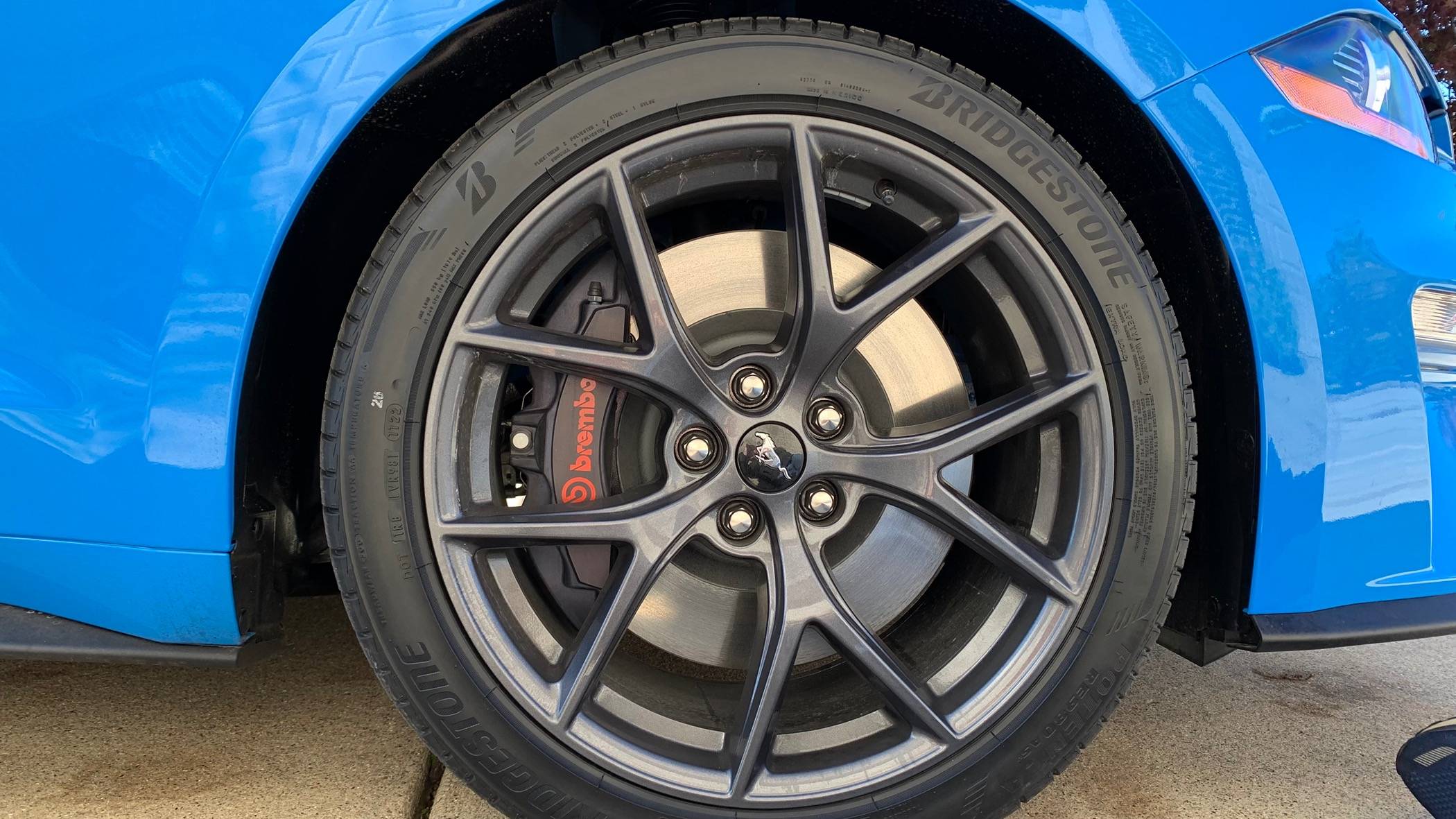

Have the 6-piston Bremos on my 2022 HPP. Can confirm they will give you a concussion if you dare use their full braking power. Total overkill for the street.

Oh yeah. Between the 200+ less pounds over the front wheels and the 6-piston Brembos with manhole-sized rotors, the HPP has way more braking than you will ever need short of a track day. I suppose that’s not the worst thing to have on the street!
Also, the Brembos are super-cranky when cold. Loud grunts and groans until some heat builds up in the rotors, which takes some time due to the aggressive venting and brake cooling ramps in the underbelly tray.
The stoping power is unbelievable.
