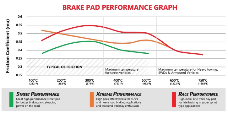

No rain just a bit wet on some sections. DBA claims "Optimal braking consistency up to 550℃ (1022℉)" so we'll see how they hold up, I've added cooling deflectors too.
At the time of ordering there was no race pad available, only the Extreme Performance which is recommended for occasional weekend trackdays. These are also EC approved which is a must to be street legal here.
If they are not sufficient I will look at Carbotech pads. I think XP10 front and XP8 back is a good start from what I've read. (Not legal but I'll just swap them)

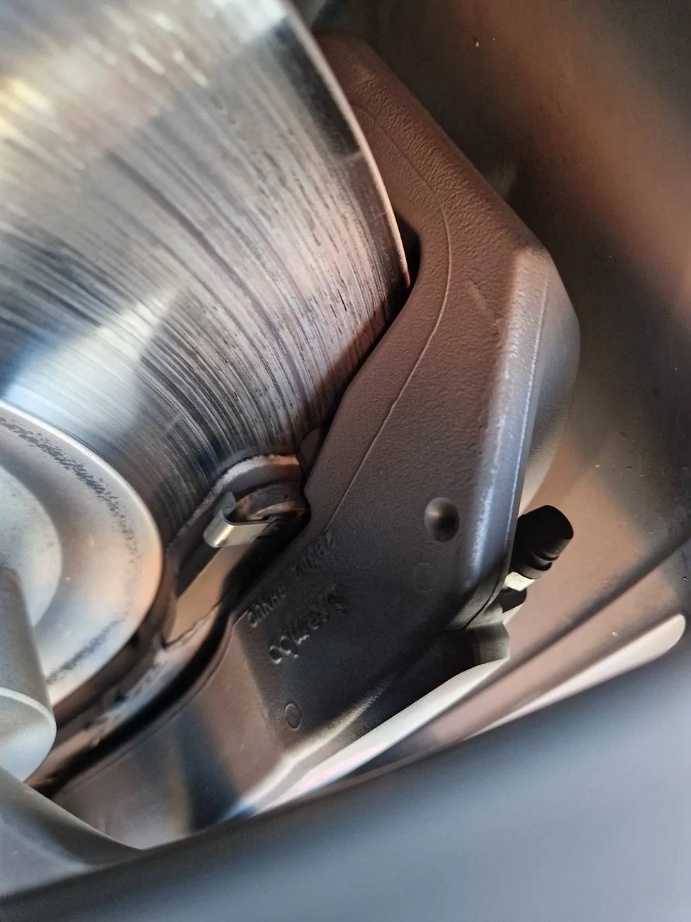

Got back from a dry but very hot day at Zolder. It was 32C (90F). It was a lot of fun being able to push the car hard but unfortunately it kept overheating. Mainly the engine oil got in the yellow after just 15 minutes of driving. I guess I'll have to get an oil cooler.
I'm wondering if there is anything needed for the manual transmission (MT-82)? There are no PIDs to track the temperature, neither is there anything for the differential. Do I need coolers for those if the engine oil is overheating?

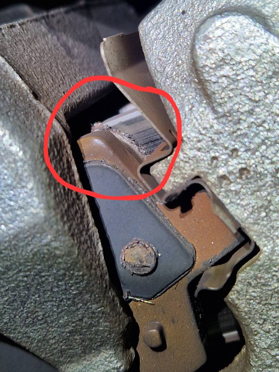

To get back on topic, as for the brakes, they performed quite well but I think I still overheated the pads and got some heavy pad smear on the rotors now. The pads itself looked to have discolored to gray at the edges, looks a bit burned like charcoal. The rears started to come apart it seems. They never faded or failed or anything.
Would I be able to get some more track days out of these pads and rotors? Pad thickness is still good.
After this I think I'll buy carbotech XP8 rear and XP10 front, or would you guys recommend XP10 and XP12 instead? I don't want to make the expensive mistake again of choosing slightly suboptimal temp pads (these were supposed to get Optimal braking consistency up to 550℃ (1022℉) )

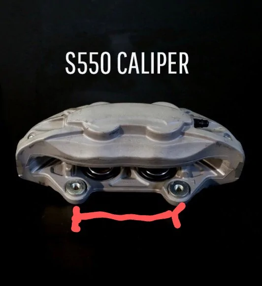

Can anybody with 4 piston caliper on hand please measure the center on center distance between caliper mounting points? Pic with a measuring tape would be ideal 😊
shogun32
Feb 8, 2019
92
16,223
14,019
Northern VA
don't you want at least a proper caliper with 0.2mm precision? :)
Sorry, none of my stuff comes with the 4 pots. And I don't think my neighbor would take kindly to me shoving a jack under his car, zipping off his wheels, and dismounting the caliper.
"But it's for Science" is unlikely to assuage the FFX police officer.
