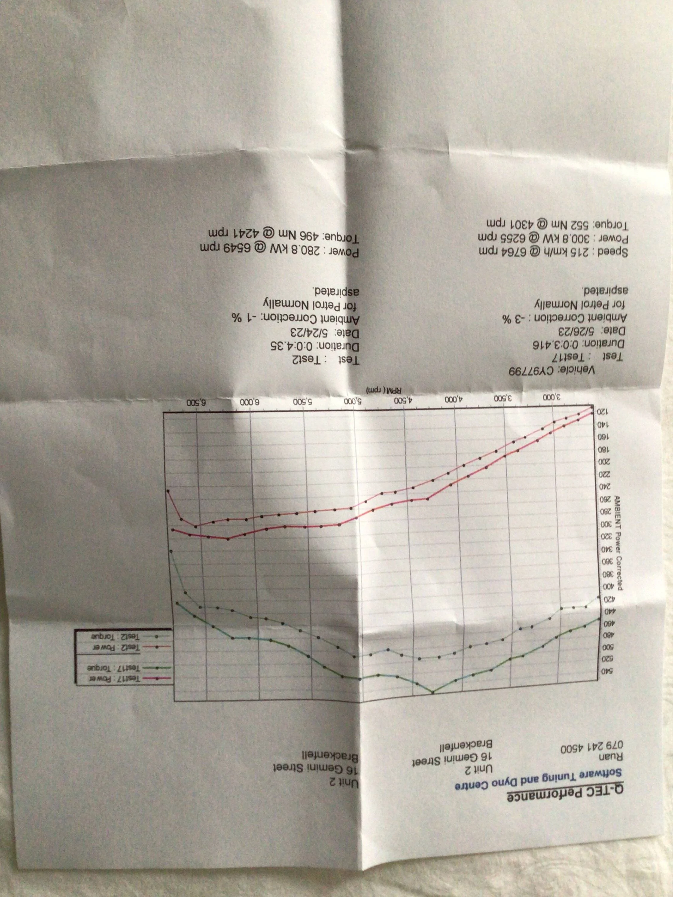

So I decided to do a dyno run …my car is stock 50 with open rear boxes, boy was i disappointed….it pushed no where near what Ford claim 435 Hp😕
So the car with cats installed delivered a modest 280kw (375Hp)
So out came the cats, back on the dyno …instant improvement with not much more noise 😁…however it went to 289kw ….then a tune where they played with the ignition timing and cam timing through the range.
It ended with a relatively stock 50l mustang from 280Kw to a respectable 300Kw 403Hp…still not close to the claimed Ford spin doctors who said 435Hp😡
Rear wheel torque went from 496Nm to 552Nm …that was not bad …total bill for cat, removal & tune and a number of dyno runs was around 400USD.
The guys said if we used a better fuel we would see improved performance, our fuel locally is not great 95 octane.

I thought pre facelift ‘euros’ were 410 (at the crank) ?

Ford like all manufactures rates HP at the crank. So if you are making 403 at the wheels you should be making more like 440-460 at the crank.
Put a 2018 intake manifold on it and bump up the redline to 7500 for the best bang for the buck horsepower.

You don't understand the difference between crank and rear wheel HP. Your RWHP numbers show about a 13.8% power loss from drive-train losses compared to the crank numbers Ford marketed.
Not knowing the age and miles on your car, that's probably about where it should be.
Also, it's 5.0, not 50.
Lastly, cats aren't designed for noise reduction.

Buy a BMW if you want "stated HP" to actually end up at the wheels. All manufacturer power ratings are at the crankshaft. 403 Wheel HP is pretty good really

I fail to see the value of crank Hp ? For me it’s what’s on the wheel after all that is where we need it ….I decided since the stang gang were divided on the issues of cats in or out I would test it
placed the results on here hoping we all gain insight
either way I’m underwhelmed…a so called masculine car that is easily out prone by a golf GTI

Thanks sorry I get confused with 50…5.0 …. I own and shoot with a 50
I appreciate what cats were there for I was just tabeling the results with or without since I asked the question a while back and no one had numbers to substantiate if the removal had merit? Now it’s clear …

In stock form, the Cats are not a restriction.
VW is another one that under rates their Power figures, but I doubt that stock for stock a GTI could keep up with the GT, especially at sea level. No doubt the EA888 is a very capable power plant, but the Coyote really is one of the best engines ever made. Put a blower on it, and feel the real potential of the Coyote.
