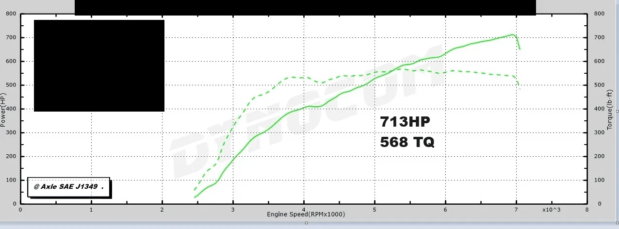

Curious if others have similar builds and what their numbers are.
2015 Mustang GT
Dyno graph attached below.
Build:
Engine:
Ford Performance Aluminator Short-Block
2.9L Whipple Supercharger
132mm Whipple TB
Whipple 10-Rib Kit
ARP Studs (Crank & Head)
Ford Performance Timing Set
ATI Damper
ARP Crank Bolt
JLT Catch Can
Stainless Works Long-Tube Headers
Catless X Pipe
Corsa Cat-Back Exhaust
UPR Crank Breather Valve
SB PCV Filter
Solid Motor Mounts
Whipple Oversized Heat Exchanger
GT500 Head Gasket Billet
OPG / Crank Sprocket
Transmission:
Tremec T-56 Magnum XL
SFI Bellhousing
1200 RXT Mcleod Twin-Disc Clutch
1-Piece Aluminum Driveshaft
Fuel System:
ID1050x Injectors
Fore Innovations Return Style Triple Pump Fuel System
Suspension:
Steeda Stop The Hop Kit
Steeda Solid Rear A-Arm Bushings
Viking Shocks
Lowering Springs
Differential: 4
.10 Gear Ratio
Aftermarket Axles
Tuned on E85
Around 8-9 psi of boost on a 3.65 pulley.

How much boost? How much timing? What fuel?

Forgot!
3.65 pulley
So around 8-9 psi of boost I believe.
No clue how much timing if I'm being honest, I wasn't given the actual file. But I told him to try and be conservative with the timing/tune.
It was just pump e85.

Whipple should give you at least 15psi
with a 3.65 pulley, long tube headers and no cats?
Doesn't boost go down when you decrease backpressure / unrestrict flow?
Also not sure how much boost can be ran with 1000lb injectors.

Over 700 on 9lbs of boost sounds like it's running strong. You have a built motor on E. Turn it up!

My gt500nwith Eaton would give me 14 psi boost

Any idea how much the ID1050x injectors will handle?
My tuner told me that anything above around 800-850whp is likely going to max out the injectors.

Your tuner can look at a datalog and tell exactly how much is left on the injector duty cycle. If they’re saying 800-850, well, they’d know.

That sounds accurate on a gen 2 with out DI. Like Nightmare mentioned, your tuner can check your log and see how much headroom you have left.
