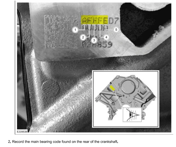

I’m currently building a basically stock Predator short block. The ford procedure for selecting the main bearing thickness, or “grade”, is described here:
https://www.mustang6g.com/forums/threads/bbq-tick-test-request.117273/page-2#post-2467476
However, the code on the block is:
I have reason to believe the main bearing code is the first string of characters, but I also have reason to believe it’s the second string of characters. So which is it?

Hey Im with you on using OEM bearings. Let us know what the current bearing sizes are and the increments they have between sizes. Thanks

You buy the bearing by the grade and mix/match, yielding 5 possible combinations. Ford doesn't tell you the actual thickness of the grades. I guess I could measure the corner and see what it is for a grade 1 and 2, at least. I trust Ford's numbers over my own, though.
The block and crank have a manufacturing tolerance (not to be confused with service tolerance) of +/-0.0005, so the clearance could vary+/-0.001 at the same bearing thickness. Since there are 5 combinations of bearings, that would mean they're splitting up the 0.002 into 5 possible segments of only 0.0004 each, meaning the manufacturing clearance tolerance is actually +/-0.0002.
The service spec on the clearance is 0.0011-0.0025, or +/-0.0007. This means that the service tolerance is about 3x greater than the manufacturing tolerance.
Most machine shops use the service tolerance as a go/no go, but you can see the OEM is much more precise. This is why I use OEM parts and prefer OEM final machining/finishing as much as possible.
