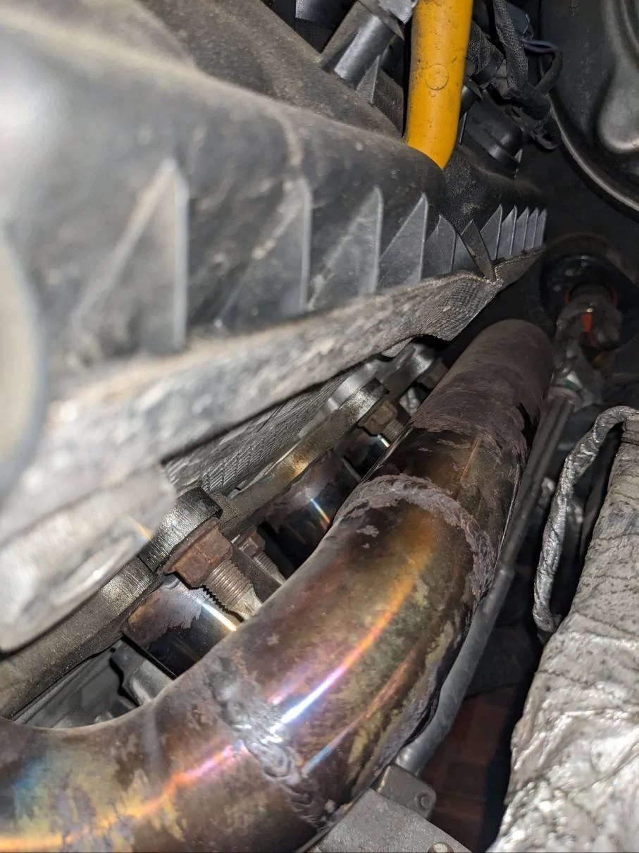

I bought a used 2018 GT 10R80 with LT catless headers. Any way to identify what brand or model headers on my car? I want to buy catted but need to know the brand. They look like Kooks based on the headers collector 2 bolt flange.

Kooks will typically have a metal tag welded on one of the primaries that you can see from the engine bay. Can you post some pics?

Stainless works does too. They have a large tag with SW on it. If there is any tag, it will more than likely be on the drivers side, you can't see the passenger side primaries from the top.

Kooks 4-1 collector is canted down a bit and not perfectly parallel with the ground. Most all others 4-1 collector are near perfectly horizontal running parallel with the ground.

Thanks everyone for all the helpful tips. i dont see any tags on the tubes.

The primary layout, crappy tube butt welds along with the 4-1 collector arrangement and low grade stainless steel corrosion are a dead giveaway.

Thanks that was fast. They'll do for now. Now I just need to find a set of used catted midpipes.
