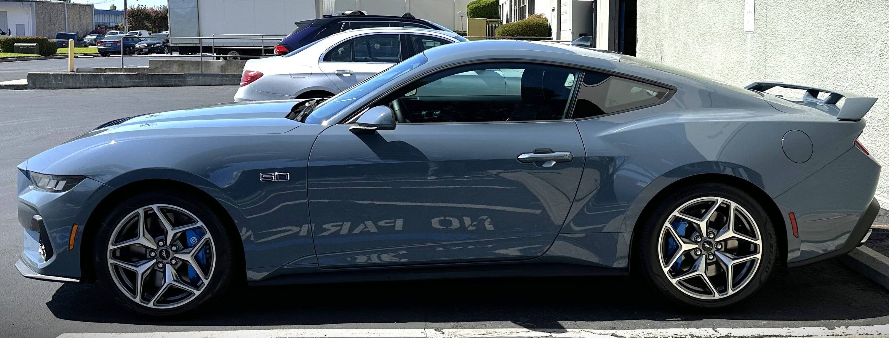

The difference in acceleration going to the auto is actually quite noticeable. It feels much quicker. I really like it.
