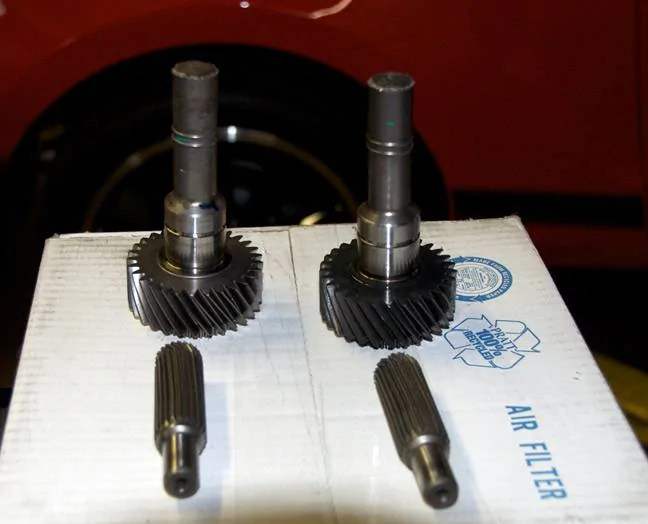

Here’s a pic of two broken MT82 input shafts that I found on another forum. The car that broke them was reportedly making 761/598 @ the tire.
Additional information is as follows:
Car has only been launched from idle on 18" drag radials. First shaft broke on a 2-3 shift at the track. 2nd one broke on a 4-5 shift, highway, street tires.
The MT82 is rated for 383ft lbs.
