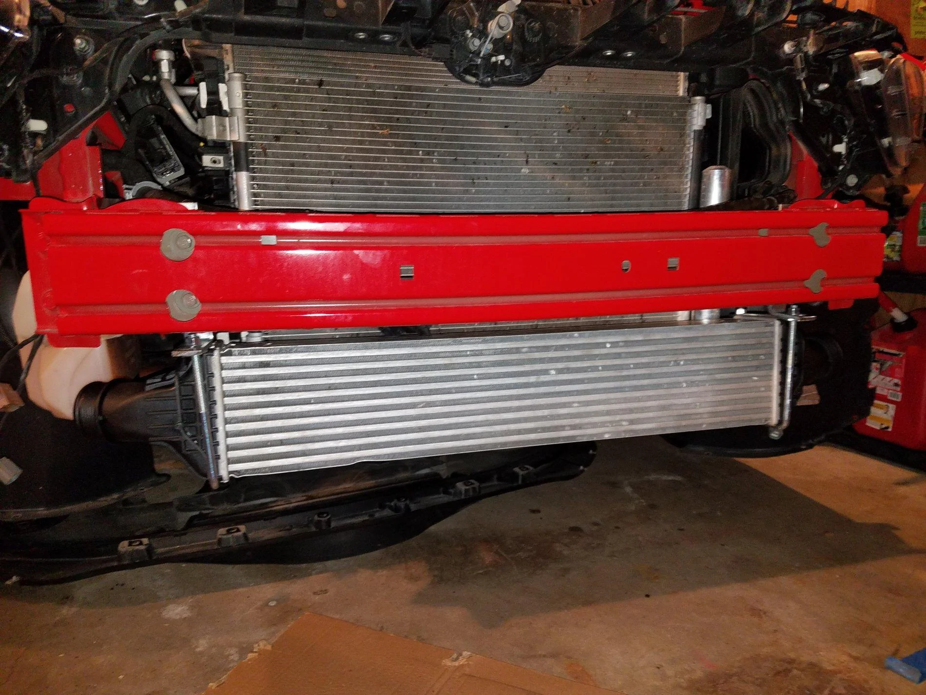

So, I'm about 30% done with my install. Passenger side is pretty much done. So far the hardest part has been figuring out where I want to route the intake and charge tubes and then ordering the correct stuff. It's very cramped on the passenger side next to the radiator and I've changed my setup a couple times. I'm using a different intercooler and intake setup then the supersix kit recommend so I'm having to figure out some alternate routing then what they used.

Yes, crp upgrade kit, spd ported manifolds. I got a used intercooler from a 2017 A4. It was $40 and it tucks perfectly under the bumper. I'm a little concerned about the oil drain on the passenger side. In order to clear the starter I have to bend it almost horizontal. I might take it back off and cut it shorter leaving only like the first 2 corrugations and then run a flexible hose around the outside of the starter. I'm not sure yet.

I'm going to be self tuning to start out also (because I want to learn how) so I'm not going to go nuts on power right away. As for the intercooler it fits perfectly and they make lots of aftermarket upgrades for the A4 so I can easily swap it out for a better one later.

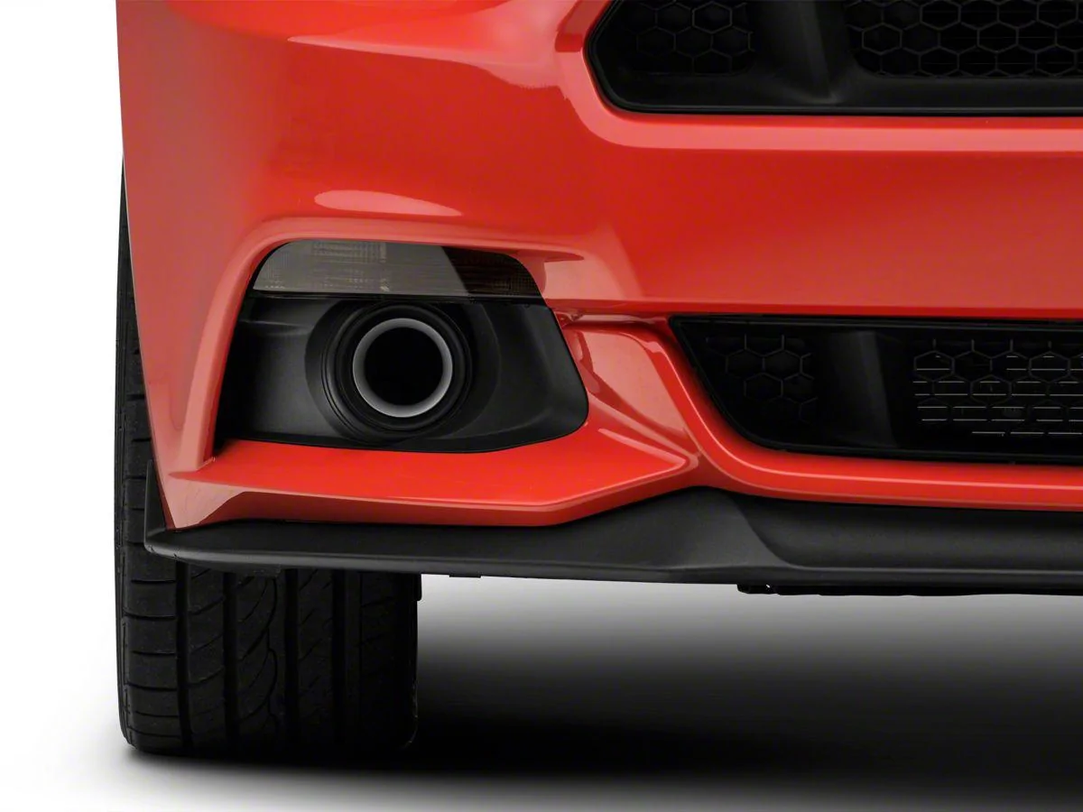

My idea was to use the foglight openings. And put in the JLT foglight deletes meant for a brake cooling kit. The other way was to use brackets like Cody did on his build where you have your setup but using my GT grille. The guy who ran the kit i have before me only used turbo screens

I'm not comfortable not running a filter, and I want to be able to service the filters without removing the entire bumper every time. That's what's tricky. It's very tight on the passenger side. You have the wiper fluid bottle, the AC stuff, and the ecu with tons of wiring. Once you take the factory airbox out there is tons of space on the drivers side. I'm not sure how on Cody's build, he can get to that passenger side filter without removing the bumper cover. I also don't want to relocate the wiring loom outside of the engine bay like the supersix instructions want you to.

U wouldnt have ro remove the bumper just drop the underskirt cover for the foglight idea. You can check Kody's build video that gives an idea of the brackets and the intake tubing for his version (it literally is the same as you really). Another idea is to mimic the f150 design by using one intake that Ys into two tubes that run to the turbos from the factory airbox location
