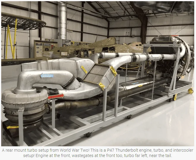

Not sure if you have seen this. There is a a rear mount turbo s550 video. Check out rearmount_s550.

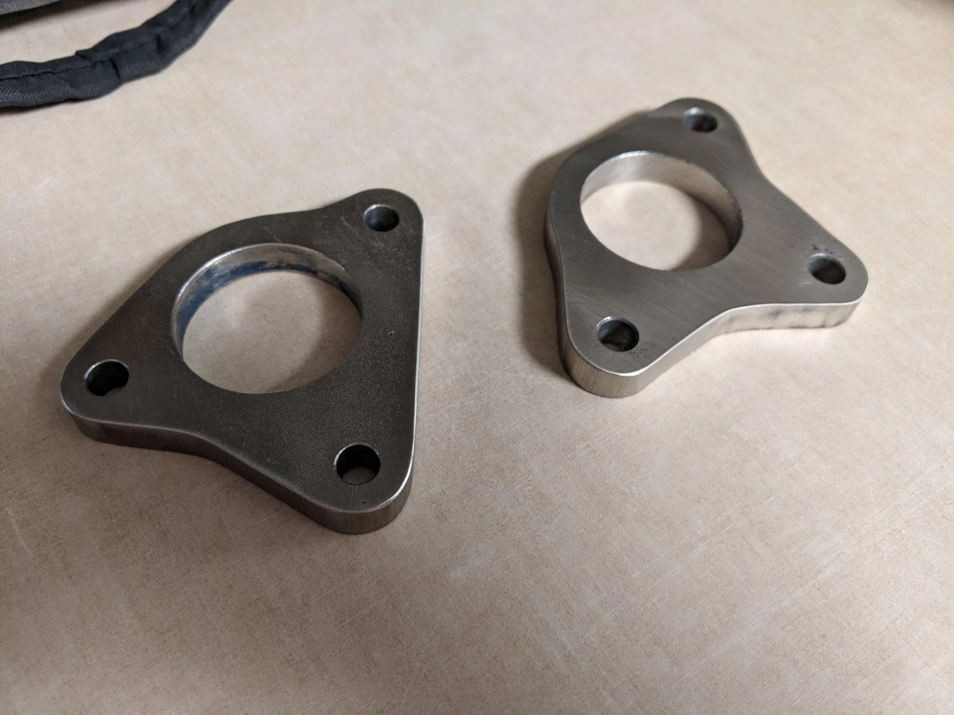

Have not been able to get much done with my setup as well... I did get the turbo side flanges cut. Need to cut the exhaust flanges and then I can start building the aft section of the exhaust. Also trying to get ahold of a 2018 rear bumper in order to use quad tips. Still debating between water to air and air to air but that audi intercooler is tempting.
It was a GT right? I have seen a few of the videos but it does not show much of anything beyond acceleration videos/Dynos... I have yet to see any videos or pictures of the actual setup which would be helpful.
