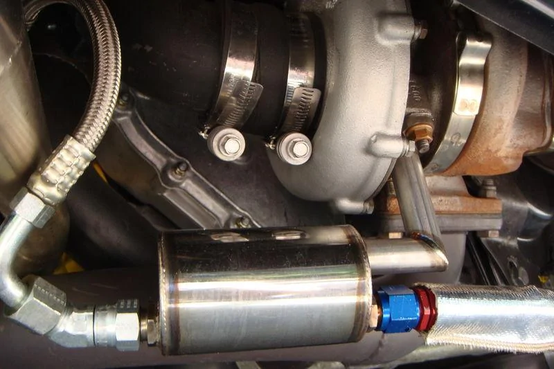

What would be nice is if I could create a sort of secondary oil tank for each turbo that would allow the turbos to drain. Those tanks would then be plumbed in to the oil drain port. Would eliminate all of the work required for those drain ports without requiring a scvanage pump....
I had the same exact idea, but I just don't think there is enough room

I believe a porsche actually had a design like what I was talking about. The tanks would not have to be large, maybe 2 3" diameter pipes about 6-10" long. The turbos are mounted high enough where those tanks should be able to be placed above the oil level line.

Found it...
